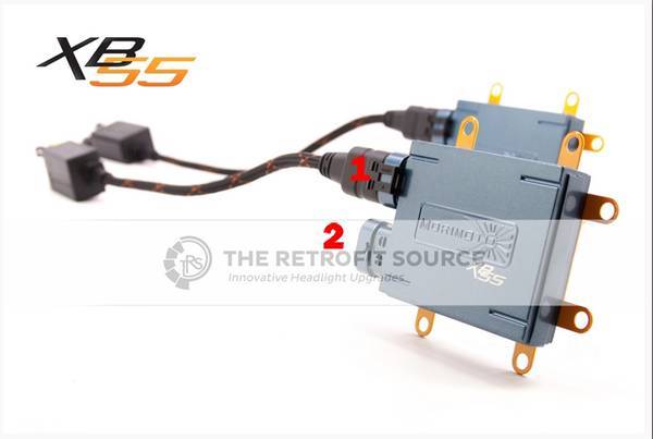

    There's 2 plugs for the ballast, 1 goes to the HID bulb and the other connects to the harness. If you're stating in general these lights need ground to work, then yes I agree. But reading your reply at 1st glance it seems like you're saying a ground wire needs to run straight to the ballast.

    I don't have that ballast, mine have a ground wire coming out of it, my ground poped loose on the right side and that light went out, when its loose I get blinking lights

    You're running HIDs with no ballast? You have a pic of your kit?

    I'll look into that, i'll make sure mine are grounded good.
    I think he's saying he DOES have a ballast; just not the one you posted and that his has a ground wire coming out of it in order to supply power to it.
    I've never had one of those before :eek:

    Steve since this is your thread what ballasts do you have?

    I've been running Xentec ballasts that were used in my old ebay kit.

    Steve I just reread your original post again, damn I wish I was closer to you so we could meet and check this out. Since you swapped the following:
    1. Bulbs
    2. Adapter
    3. Ballast
    And it's still not working, what else do you need to make an HID retro turn on?
    Wiring Harness
    I know you said in this thread that you have the same harness that I do, but it's the only thing left I can think of that you need to make an HID retro fire up. Try ordering another harness and when it comes in, just take it out of the package and plug everything in to see if your light works.
