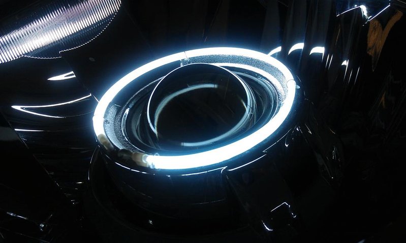

    I missed on the group buy, but was able to get the deal from Matt at TRS though. I am currently doing the mod but broke one of the CCFL rings. I am waiting for a replacement in the mail. All your guys lights look great, I can’t wait to get mine done. This pic is from the one I didn’t break.
