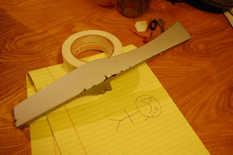

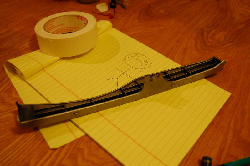

    Okay - got them aligned finally. They're dead on. So much better.
    Good news and bad news...
    Good - they are aligned properly, and are even more kick ass.
    Bad - Apparently the small locking tab on the inside of the alignment washer on the projectors has broken off. Meaning that the bulbs cannot be removed. Basically when I try to loosen the bulb nut, the entire projector spins as well - since there is nothing for it to bear down on. Not the end of the world, when the time comes for bulb replacement, I'll have to bake the headlight, remove the cover, and hold the projector from the other side while I loosen the nut. Whatever.
    2nd Bad - In my moment of infinite wisdom of starting a project at 8 O'clock - I put the small radiator filler piece, (goes between the bottom of the headlight assy. and the bumper) on my tailgate - which just happened to be down.
    Got the headlights all mounted back in place, except left the grille off so I could adjust the projector level if need be. Drove off to the flat parking lot down the road to ensure the alignment is correct.
    *Remember, my tailgate was down with the filler piece, that part is integral to the story*
    Come home. Notice tailgate is down. Hear cracking noise in the middle of the road. Fawk. Needless to say, the piece fell of the tailgate and is now cracked and not useable.
    Lessons learned:
    Chinese metallurgy kind of sucks.
    Don't leave important things on your tailgate.
    There is a reason why this project is called a "retrofit".
    Just checked ToyoDIY.com, part is $35.00. Will call stealership tomorrow to see how far I'll be bending over. Oh yeah, and the movers are coming to get all of my stuff on Tuesday. Moving to Washington.

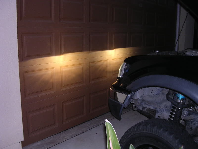

    hows my cutofff

    Passenger side looks alright. Driver side you need to rotate your projector clockwise a few degrees.

    k i was thinking it was opposite, it looks like the one on the left is bad on the high beam and the one on the right is good, anyone else have an opinion i need help. Thanks

    Yeah, you want the cut-off line to be perfectly parallel to the ground.

    here is an example of mine hope this helps

    Your driver side bulb is not installe correctly

    Dude, get some 3M double sided tape till you get the peice in. It is bad, but still dueable till you get the new part.

    do i just move it a different way? also does the pass bulb look weird or is it just me?

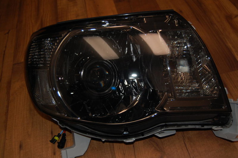

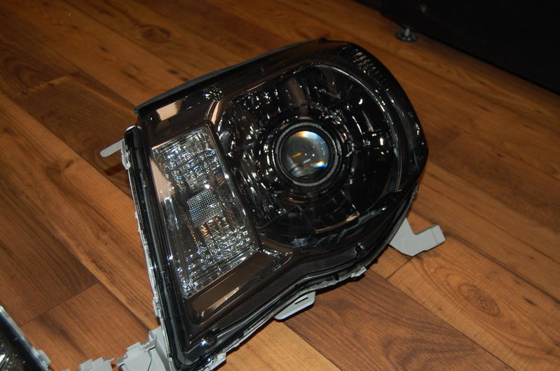

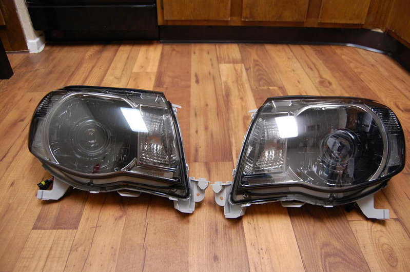

    Here is my latest creation. Smoked Headlights with Morimoto DS2 Projectors. :D
