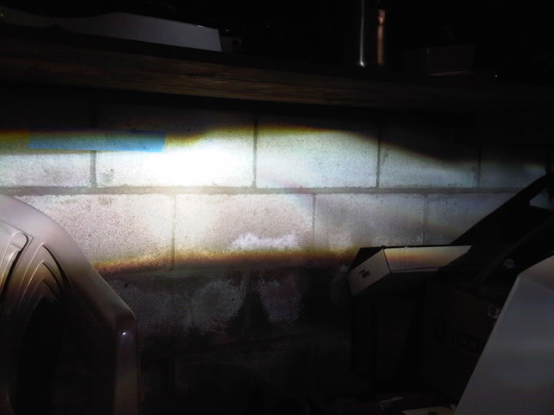

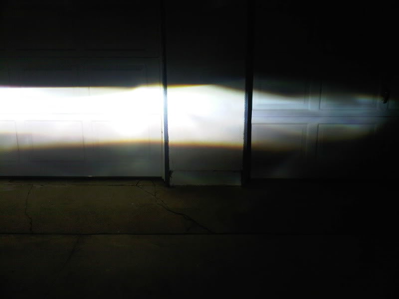

    My right side projector has a weird cut off. It is not straight on the right side, it seems to start out straight them dips down and i don't get a clean cutoff

    ^ how did you set your bulb? Take it out and set it back in and see if that helps.

    yeah i tried removing the bulb and readjusting it and it doesn't seem to do anything. My left side (driver side) has a nice cut off but the right side has that weird output.

    Did you do bulb, rubber washer, c ring and then locknut? I had weird cut offs and as soon as I followed this step I got a better beam pattern.

    I have FX-Rs if that makes a difference. It did not come with any washers just the c-ring. So I put the ring then bulb and clamped it down.

    not sure about the fxr's, but my ls 460 projectors are very fragile one pair set was screwed up during shipping from black flame customs. this is just a thought as i know my cut off was not looking good either and when jb got them back he said the shield was smacked off. i did the bulb adjustment as well as try and trouble shoot it with him, but they where just ganked.
