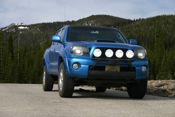

    This picture really doesn't show it, but 55w @ 5000k is pure white... I would put 55w 5000k to show up at about 4800k, where 55w 4300k will show up like 4000k. Definitely not the crystal white. It is all in whatever the look your are going for is man.
