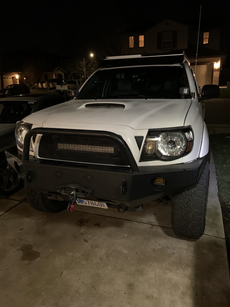

    My new projectors and ballasts arrived last week. Put them in my spare set of headlights. Depo with black trim. Really liking the switch from the all black I had previously. Looks cleaner.

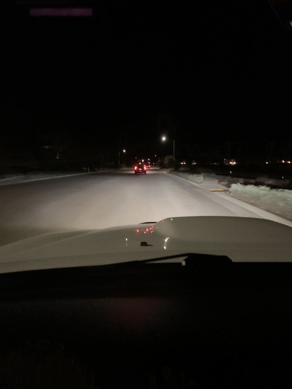

    So much better. Thanks to everyone who helped narrow it down to the bowls. I would have never known. I’m a retrofit newb.

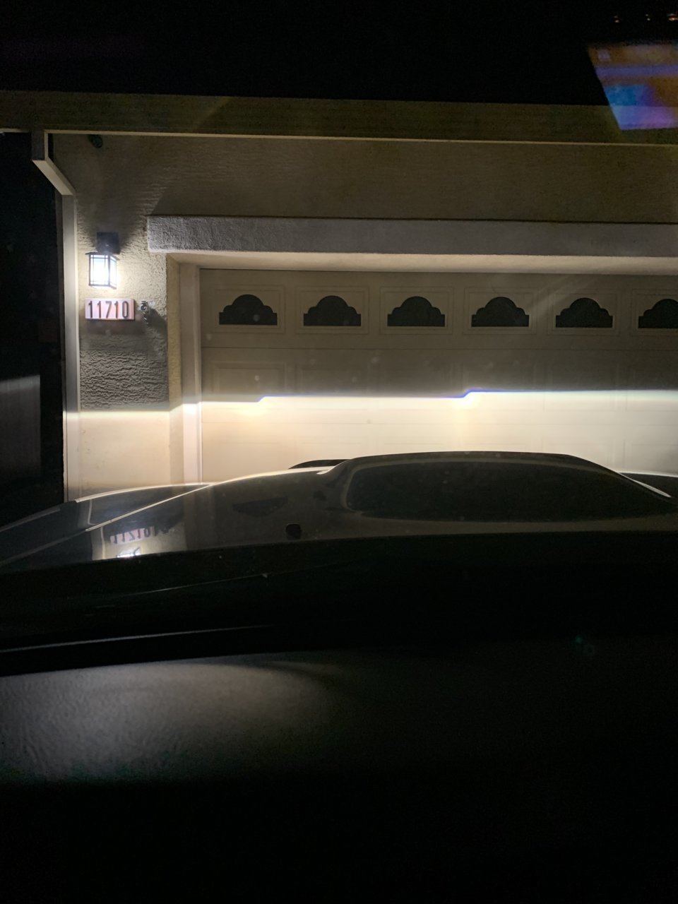

    Don't forget to level off the top steps and make any height adjustments with a full tank. The cutoff should be 2" lower than the center of the projectors height at 25'.

    They’re just below my wife’s car side mirror level. Didn’t have a wall close enough on level ground so I parked my wife’s car at the end of a court and parked facing its side probably 25-30 ft. Away. Drove the other night across Sacramento and didn’t get flashed.
