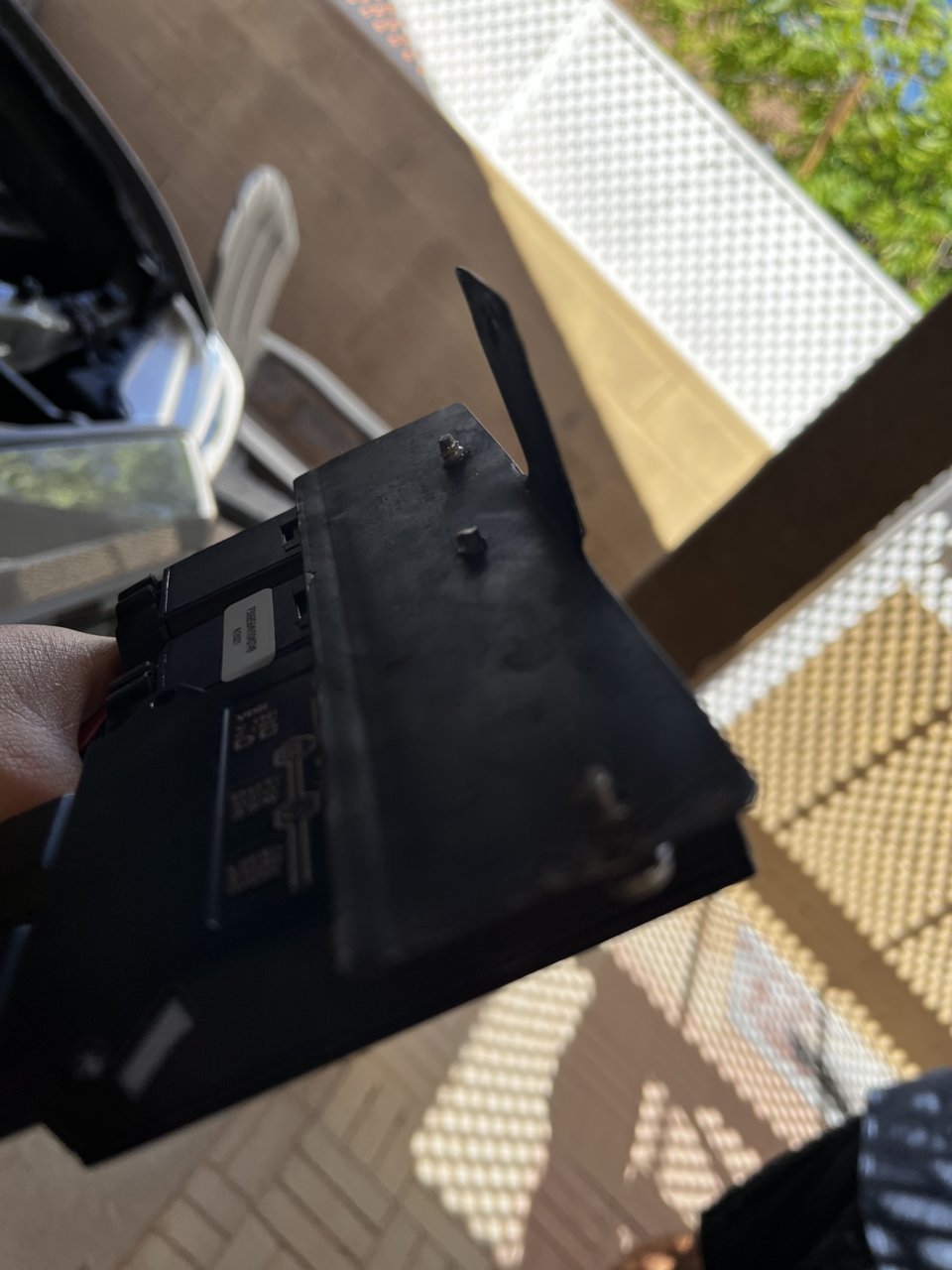

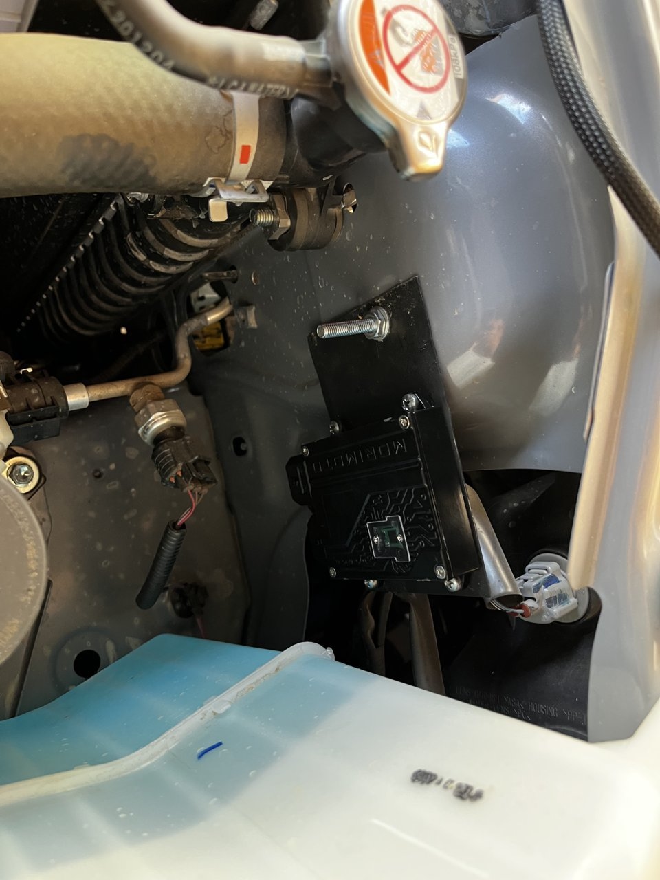

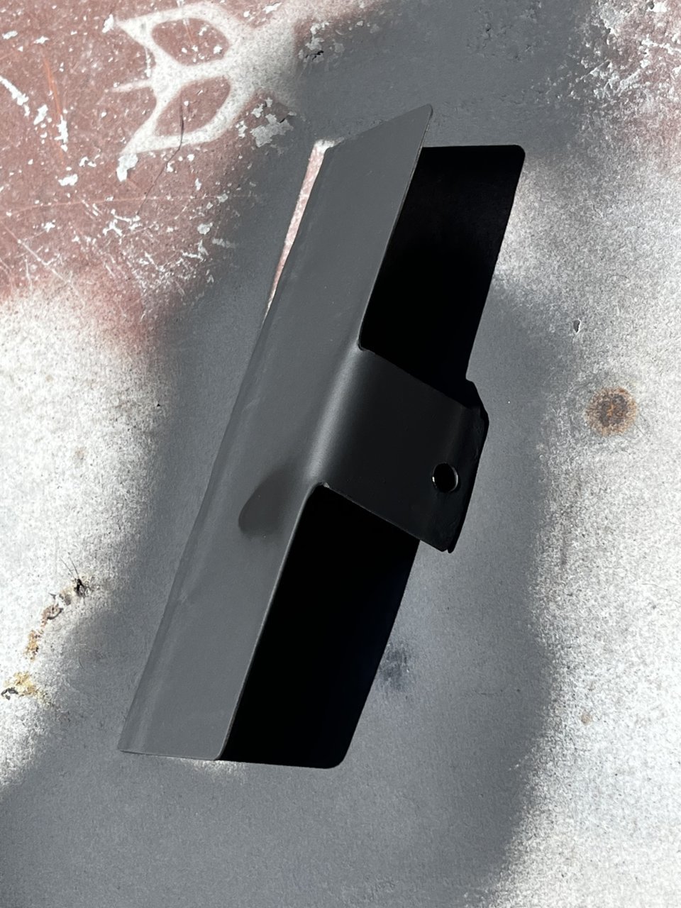

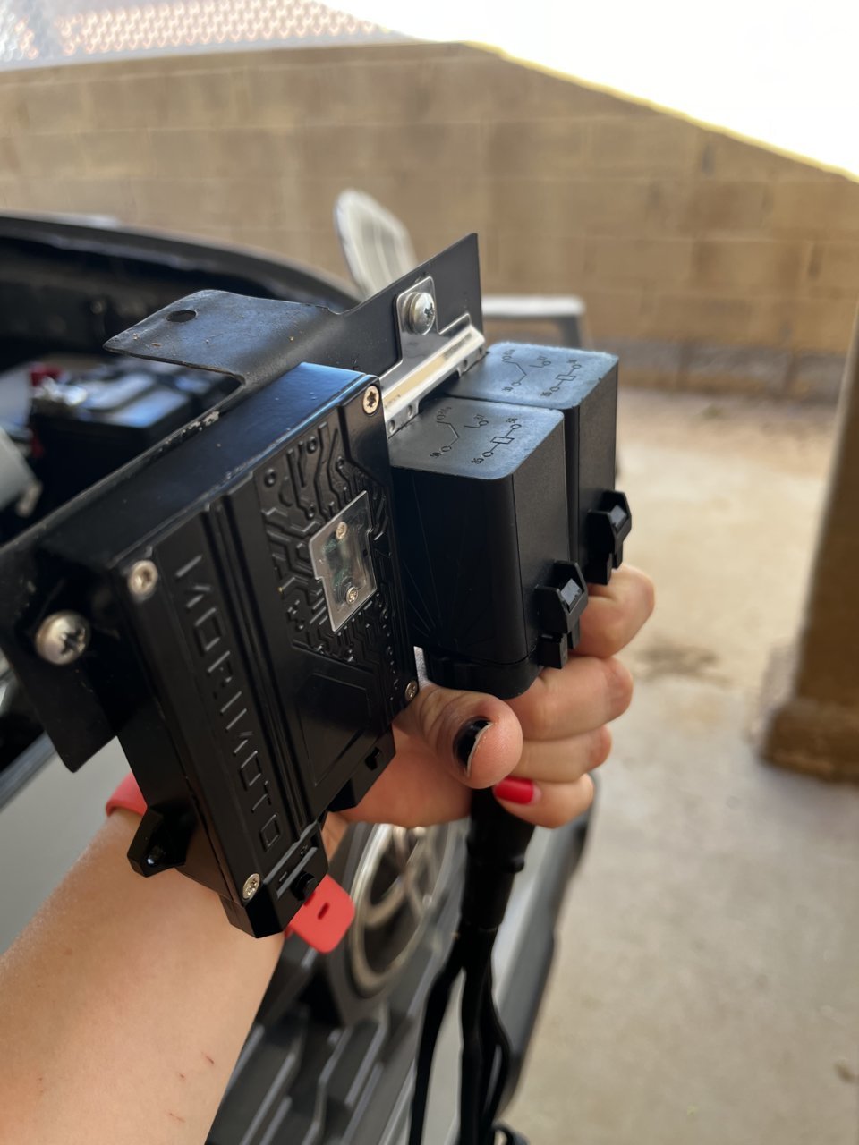

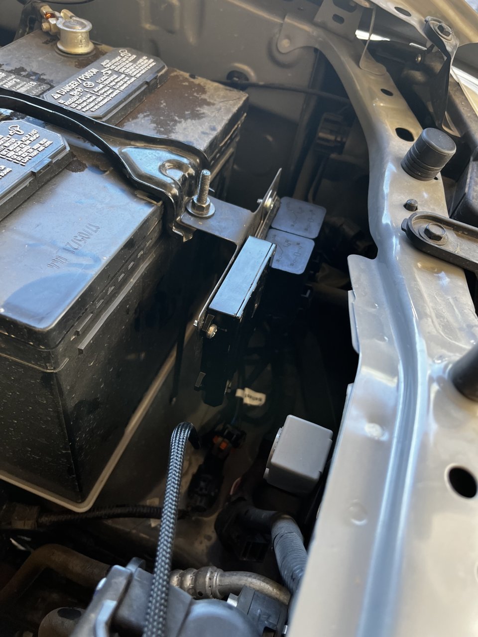

    So, I had to use some scrap metal to make my own brackets and could’ve adjusted a few things to make it look neater but I’m lazy. It’s hot outside.
    I could’ve made the bracket shorter to make it closer to the battery bbuuuut like I said, lazy. I started off doing the install but then my bf kind of took over the project. Either way, takes a bit of time but it’s way brighter than the LED bulbs I had in there.
    Here’s a few pictures I took along the way. I drill any extra holes anywhere and used existing holes. Lots of zip ties and pretty much followed the video.
    I was going off this video on YouTube when I started off
    https://youtu.be/mTPNeYmS61Y
    For now, I will stick with these until I get the chance to actually fork over the 1600 for the PRO LED headlights.

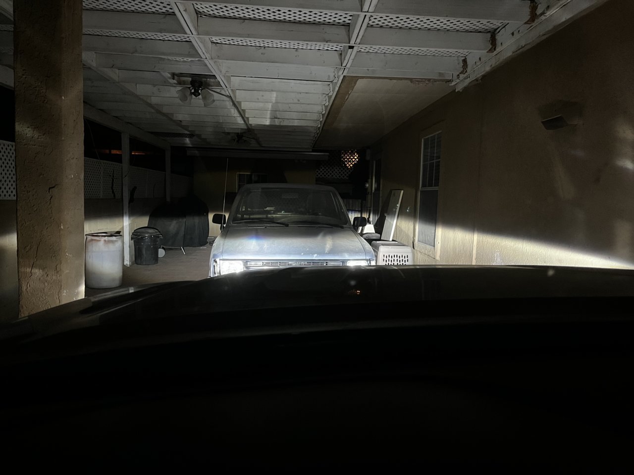

    @ToyoTX85 this is what I got.. my patio is messy af so don’t judge lol
    ToyoTX85[OP] likes this.
  19. Jun 7, 2022 at 8:10 AM
    #19
    ToyoTX85
    ToyoTX85 [OP] Well-Known Member
    Aug 15, 2021
    #374303
    50
    @tacoshell88
    looks great:bowdown: , I thought 6000k will look more blueish but I like it it , in their pics look more bluish . patio look better than most garages that I have seen :thumbsup:
