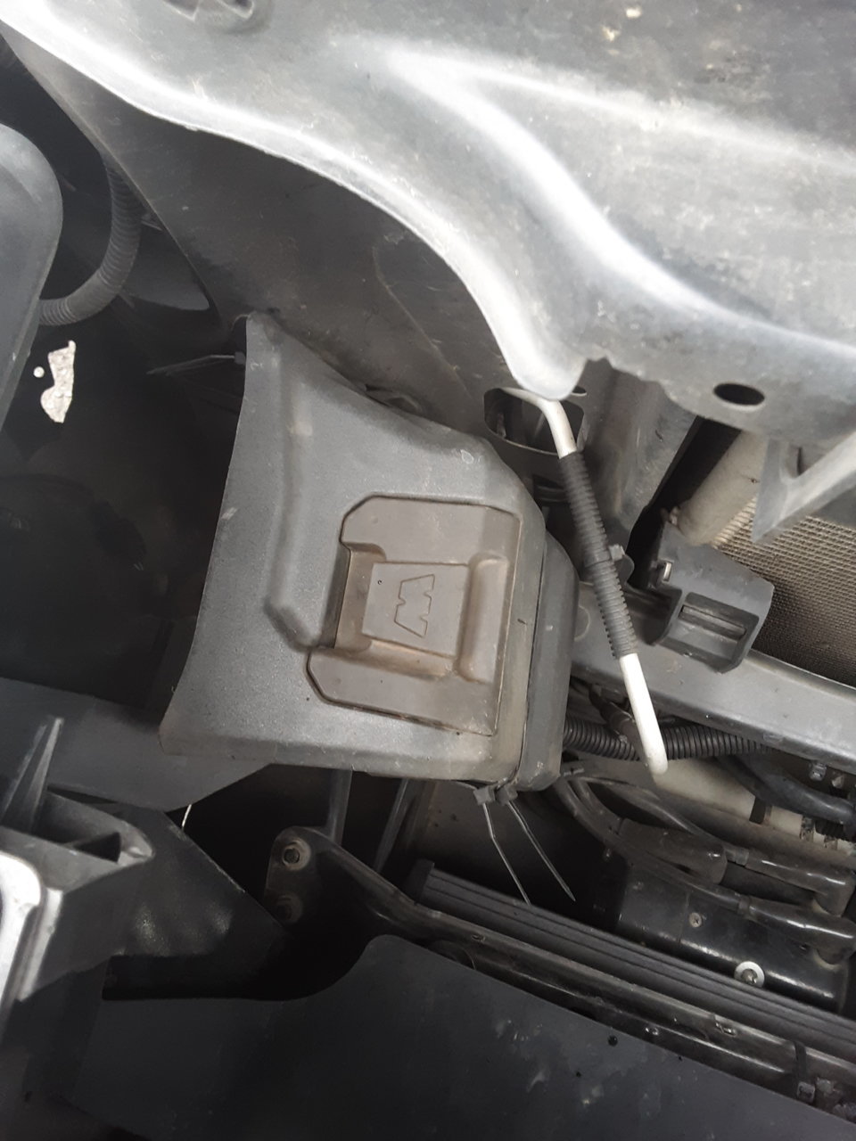

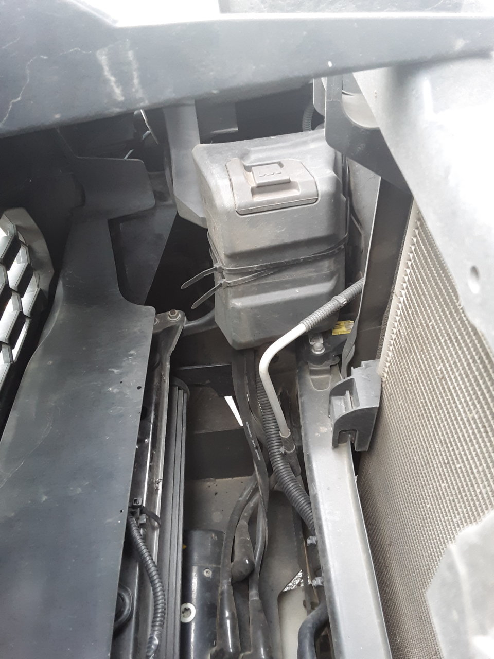

    You can see what I did with the box.
    RyanDCLB likes this.

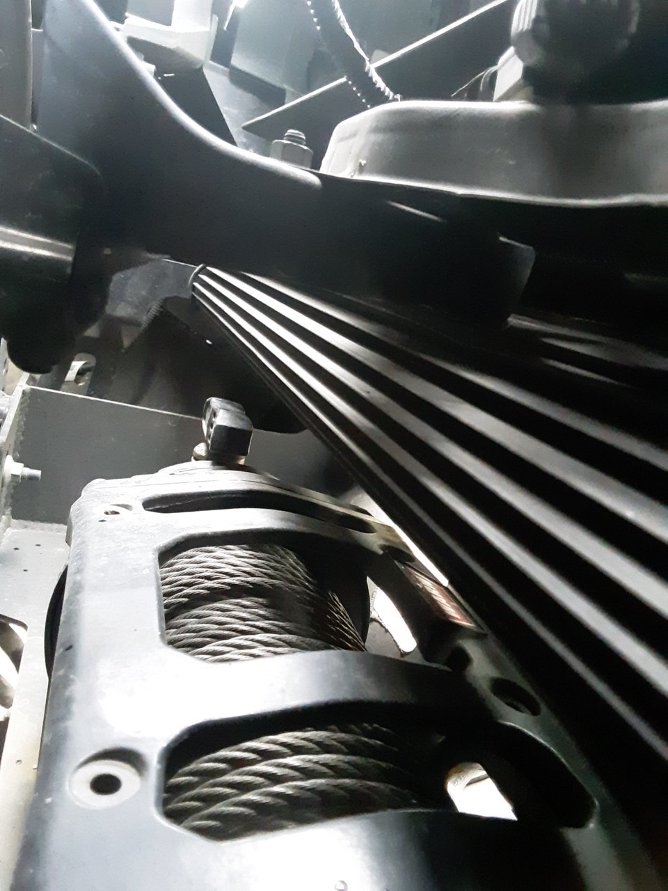

    2018, 2010, Tacoma
    Couple zip ties and done

    SW WA
    2018, 2010, Tacoma
    Lots of room for the clutch and light bar.
