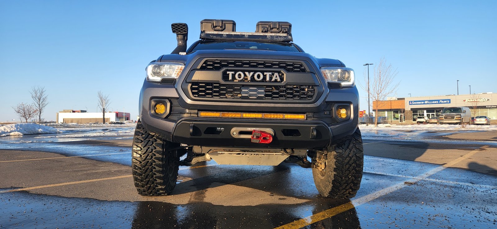

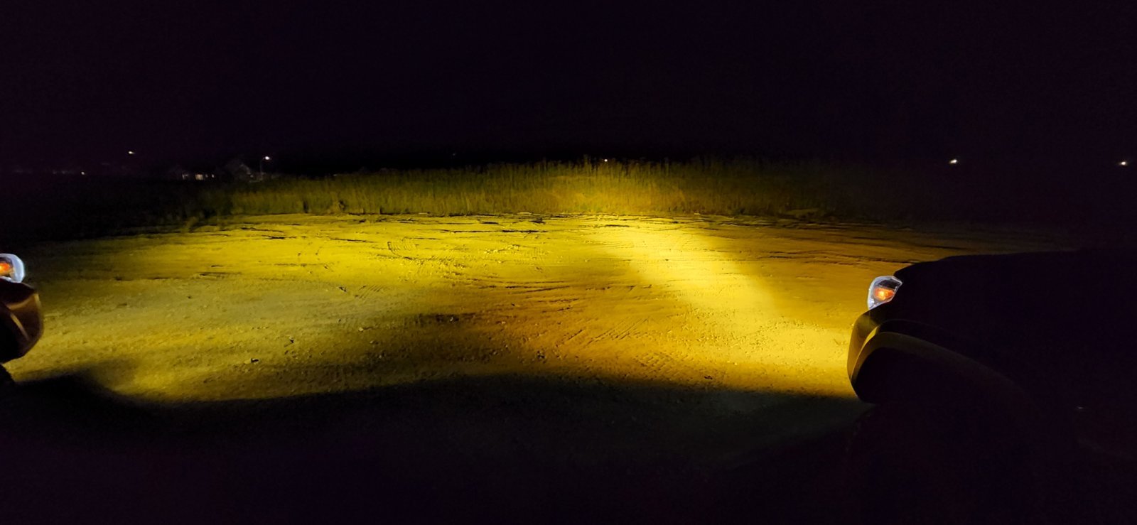

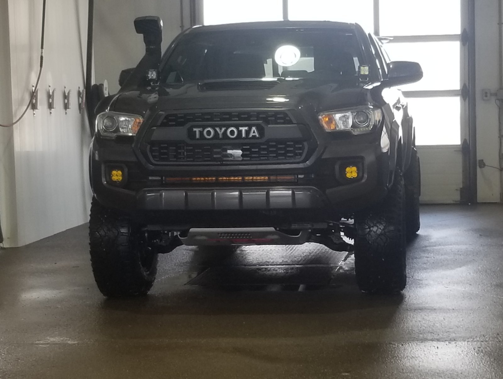

    After running diodes hidden bar in a "selective yellow" combo pattern it was honestly a waste. Unless it's all driving/spot you lose a ton of light behind the bumper. After u cut the grille and made my one brackets to push it out of the bumper was it worth while. Also swapped the flood pattern to sae fog, that is how the light should be sold.
    But really fog lights and ditch lights are the best combo to round out base lighting. DD sport or max for the fogs BD squadron pros in combo white is a solid all around set up that is useful.
    I don't have a picture of before I pushed the light out of the bumper but this is the combo next to ss3 pro fogs.
