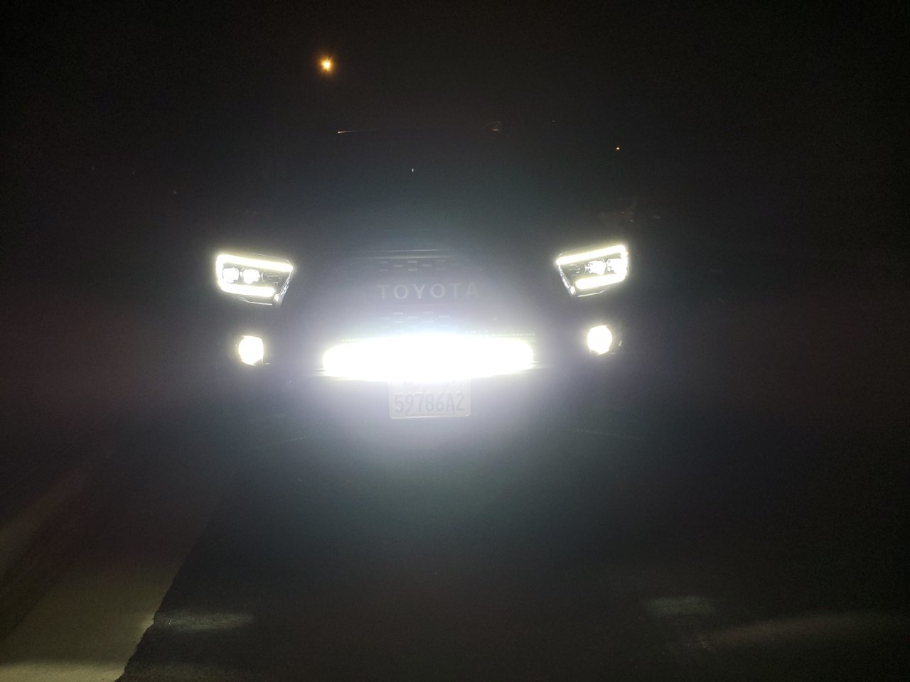

    I ordered the combo beam pattern but it sure is concentrated towards the center. I thought my Morimoto XBs were bright!

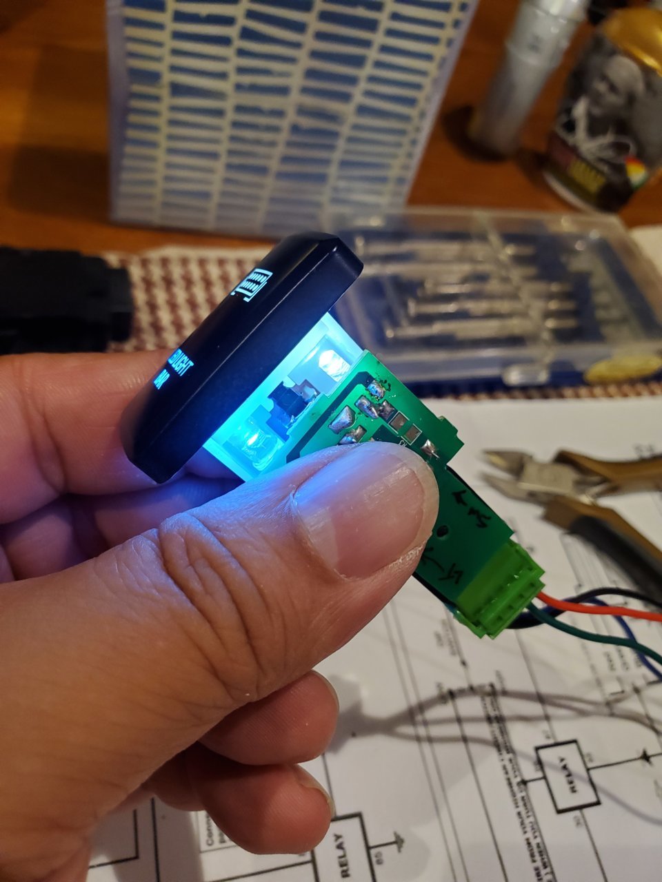

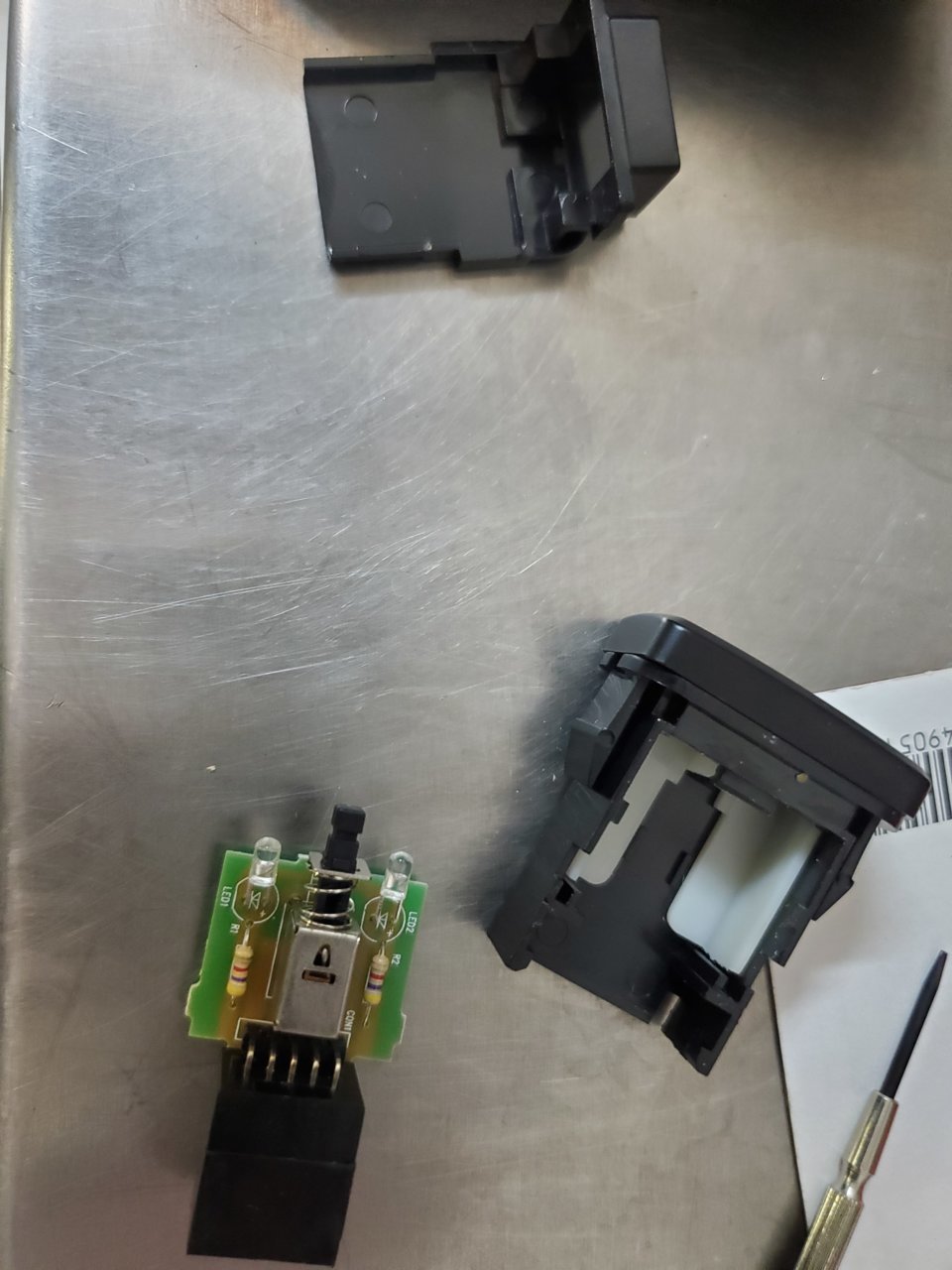

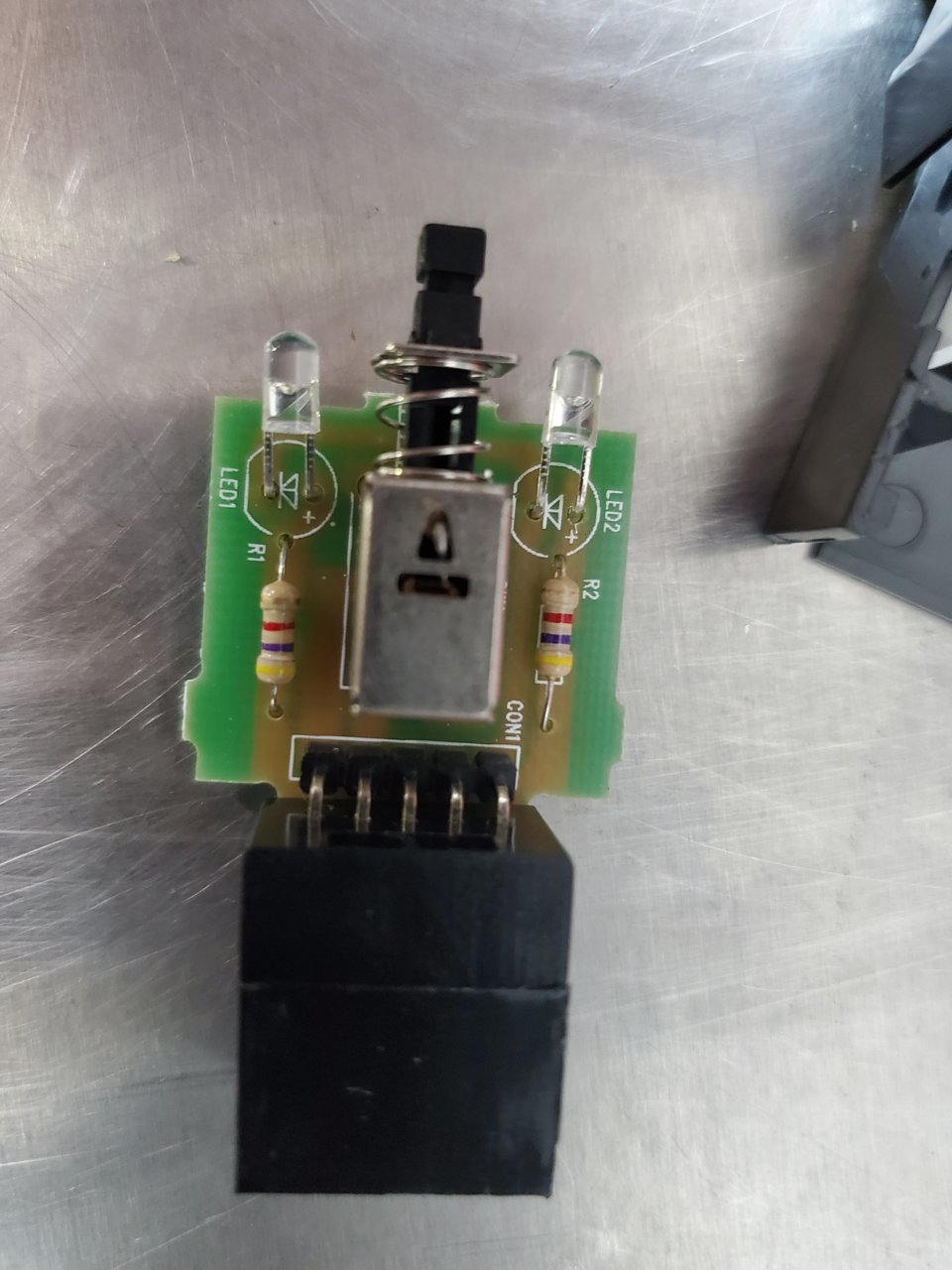

    Thank you, I'll take a look! I ordered ice blue color LEDs from Aliexpress, and took apart the switch:
    Looks pretty straightforward. One 5mm LED and it should be good to go. Plan B if I screw up the switch is Aironboard. :D

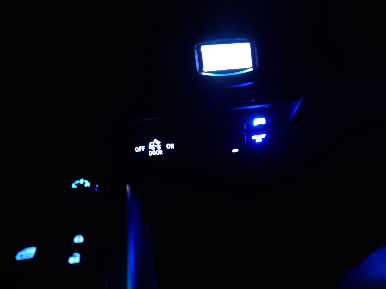

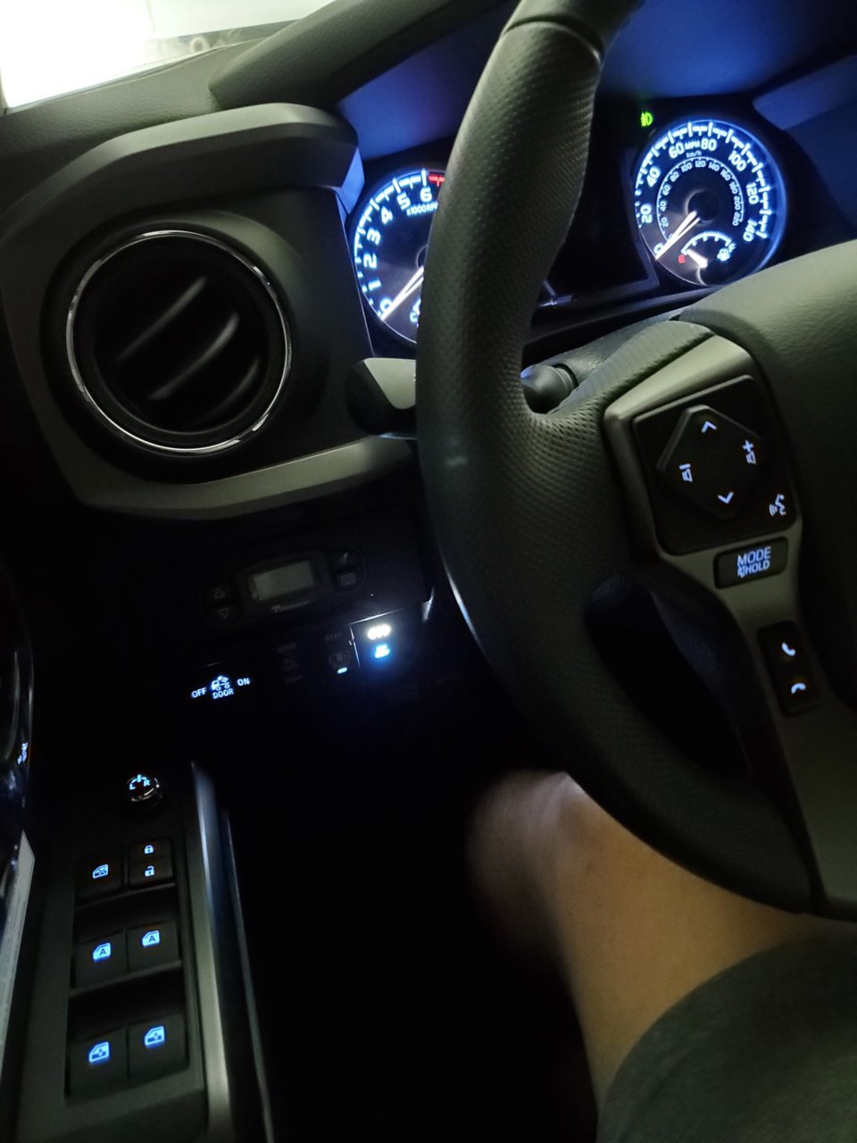

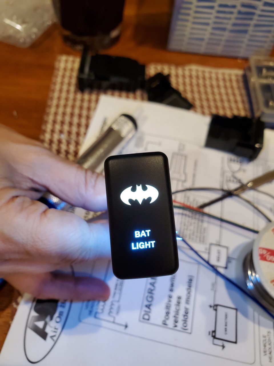

    The change-up was a success! "Ice Blue" is the color LED that you want. It is nearly an exact match to the cluster illumination and far better than the dark blue the switches come with.
    I did both switches, my "LED Light Bar" one I got from Cali Raised and also my "Bat Light" switch from Aironboard. I chose to use the "Bat Light" one in my truck. :)
    It's a pretty simple matter to de-solder the existing LED and replace it with another color. The difficulty is finding "Ice Blue" LEDs, apparently they aren't that common. I ordered a batch from Ali Express and I think they'll get here in October sometime. I did find one kit on Amazon that included the color, it's 5mm though instead of the 3mm the switch comes with.
    5mm fits! The pictures don't do it justice but it's nearly a perfect color match. I chose to make the "on" LED white when you push the switch. Looks great when the bat logo lights up bright white!
    The only down side is the 5mm LED is a bit too bright in relation to the other lights. I'll look into a bigger resistor in the future to make it a tad dimmer.

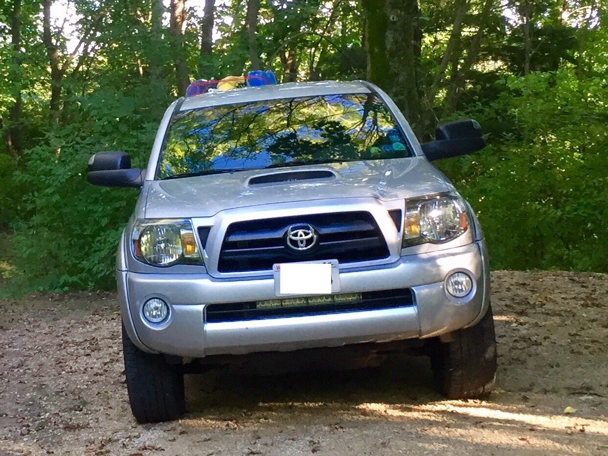

    I have not noticed any light outpout issues with mine, but it's not the OEM grill either. It's an aluminum eBay grill kit that I had powder coated in black, and the mounting bracket behind the grill was a group buy from here over 10 years ago. There's plenty of room for my lights, so aming them in the right direction has not been an issue for me.

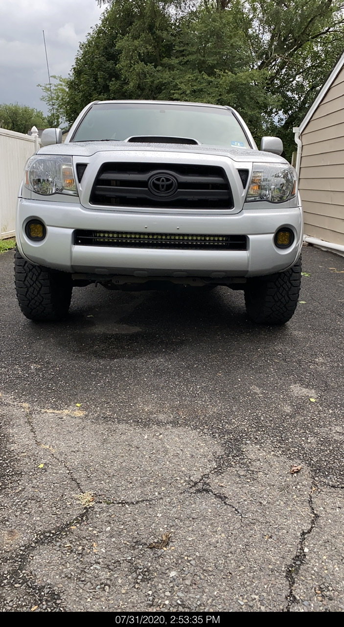

    If anyone is interested or doing research I went with the Cali Raised brackets and a 30” rough country dual row black series bar. The bar fits perfectly in the cali brackets. I didn’t want or could afford a really high end light but didn’t want a cheap Amazon one either. The rough country for me was right in the middle 8A5C137C-CF73-475D-9120-32FA140B6D60.jpg

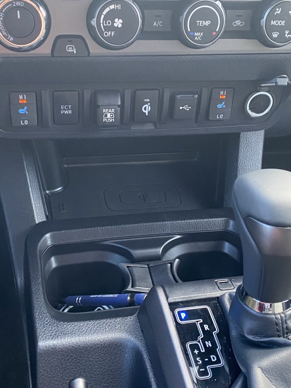

    I guess I never knew you could add heated seats after the fact. It makes sense, I just never knew it.

    There are some decent kits out there and it can look pretty OEM, as long as you don’t know what the actual OEM system looks like, since no substitute for the dual climate control panel.
