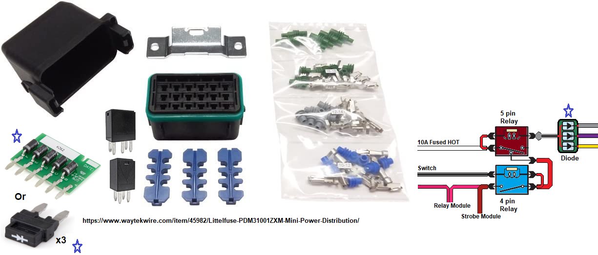

    You could keep it simple, assemble the harness without the relay and strobe module. Have buyer purchase it later.

    Some more info on possible parts for assembly:
