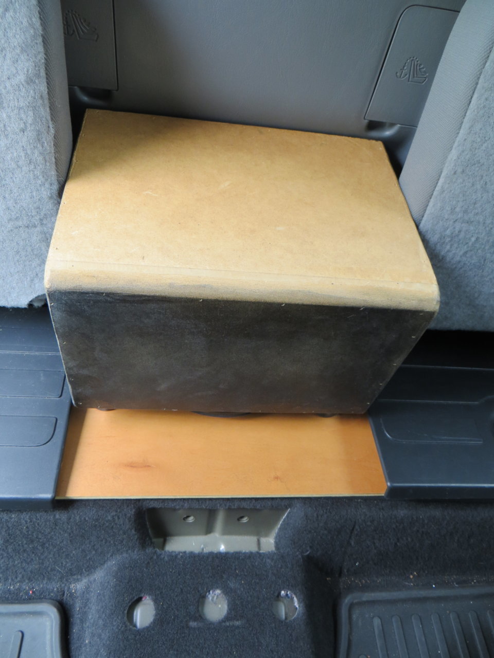

    I will post pics later from my 2014. I used a 0.23 cu knock down speaker box $25 and 8” tang band subwoofer from parts-express for $60 on sale - half filled with poly. Fits perfectly sideways between the fold down seats, fronts facing forward, speaker cut in the side down firing, with 1.5” rubber feet for the excursion and seat belts. 1/4 volume on my bass knob great for classic rock - 1/2 for bass heavy dance/wrap - goes down to upper 20’s. Beats the 10” Dayton HF or JL I had in my 98 Tacoma. You can pull it out or move it as needed.
    I’ve pulled out the black back console and revising a new box slightly larger. I’ve always hated the rear console as hinders sliding items in like a bag of golf
    clubs. The 2009 has the best design without the console.
    https://www.parts-express.com/denov...u-ft-mini-bookshelf-speaker-cabinet--300-7062
    https://www.parts-express.com/tang-band-w8-1363sb-8-subwoofer--264-833
    I have the w8-740P but for $8 more would gonwith the neo version.
    As I said I recently pulled the center console out. It sat on top and stayed in place. That box was a temp solution I've been using for almost four years - don't fix what ain't broke, but need to class it up.
