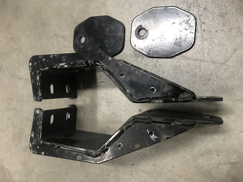

    The weak point of these winch mount/bumpers is not the bumpers. The weak point is the Tacoma frame. Suggest getting a reinforcement to the frame end cap (picture below). It reinforces the bumper to frame connection.

    I'm gonna have to revist those. The bumper did fine as is, but extra beef is never bad.

    The Brute Force Fab reinforcements are beefier. They don't list them on their website. You have to use the super secret handshake to get them.

    Where can I find more info on these and perhaps a super secret handshake? Lol. Will those work with most aftermarket bumpers?

    I was joking about the super secret handshake. I bought my US Offroad winch mount used, here on TW. The BFF reinforcements were part of the deal. I would imagine that they would fit all bumpers, but that's just a guess. Get ahold of BFF and tell them you want to buy them.
