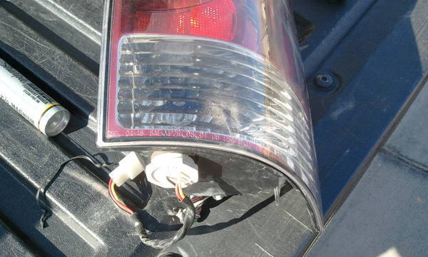

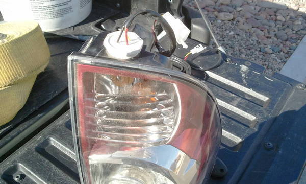

    I messed up one tail. I drilled in bottom of reverse light further outside but the pocket has metal there that interfered with the back end of strobe. The other side I corrected. Mounted it in same area but closer to tailgate side. There's a perfect pocket in the metal to accommodate the back of the bulb.

    Thats an led hideaway mounted with hids. They hids started melting the hideaway a bit even with a half inch clearance.
