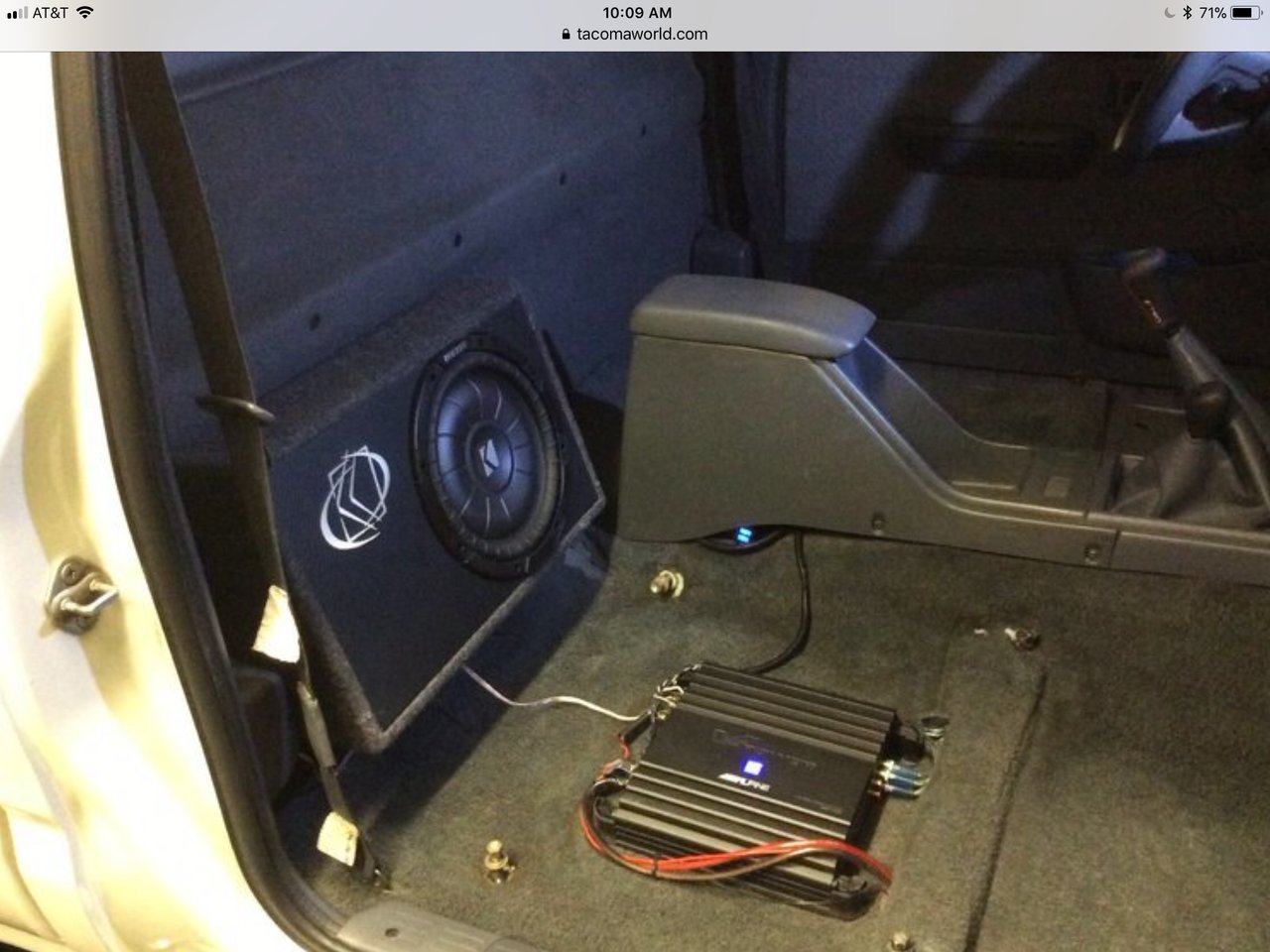

    This is my entire set up. Sounds amazing. TTUvbW_e5a74b19d971dfa4a1058b6db103909a46953c0e.jpg irdrGr_82a09d8f7a4192ab2dc59e8b96b608dc48038f48.jpg vm5cnL_11fe039fc40526f6b099af5cd6bec7e2aec4f966.jpg FUAtqO_bf7e2e8d9e27056ca972715c943818afb94150ef.jpg SL7wNv_cd09f7dde13bb9958b7f530d5d6f7004288a8458.jpg
