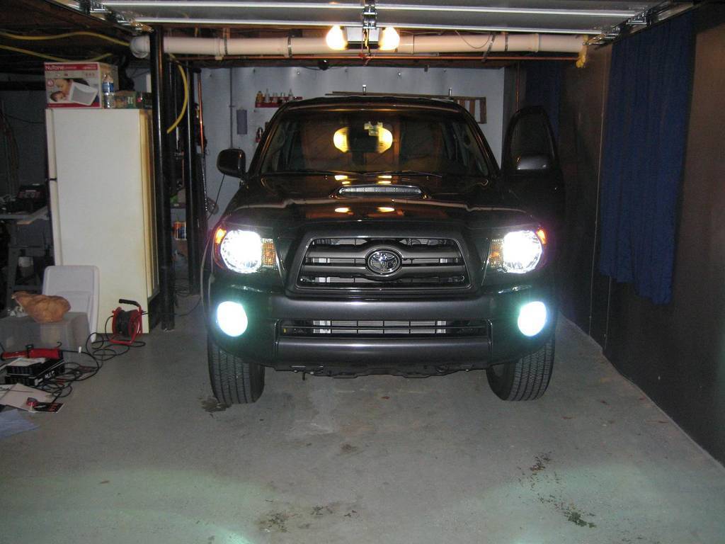

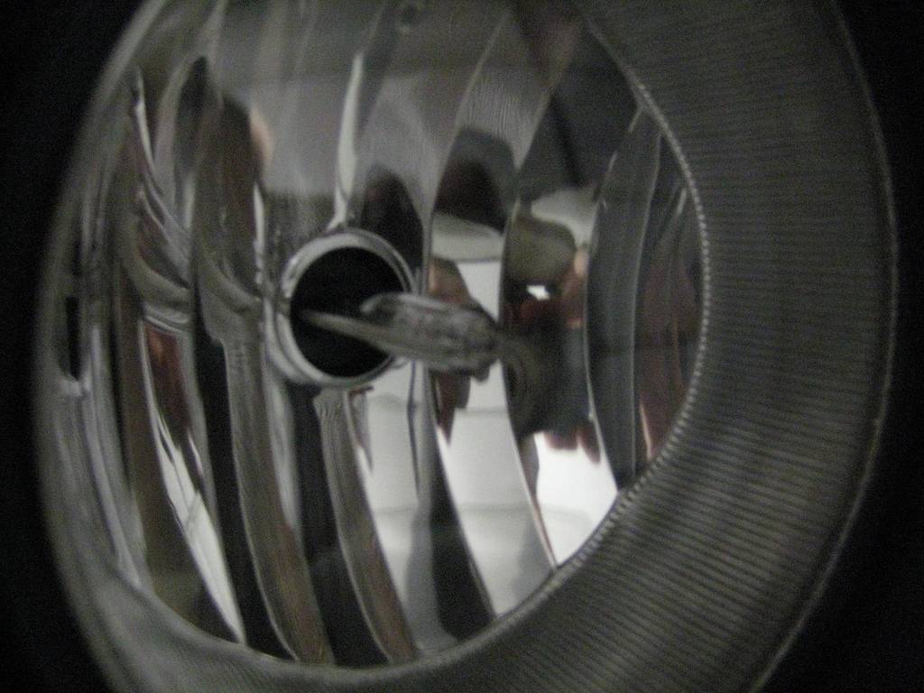

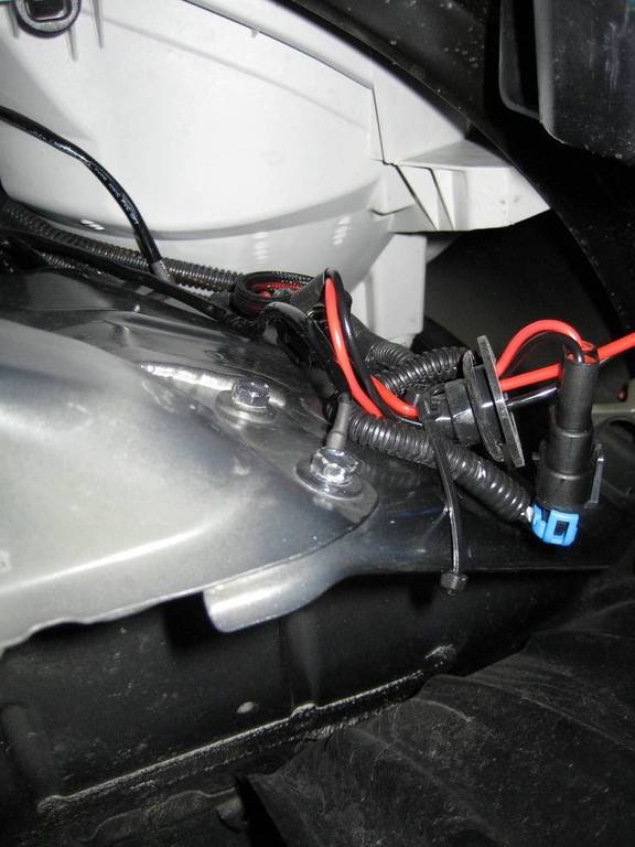

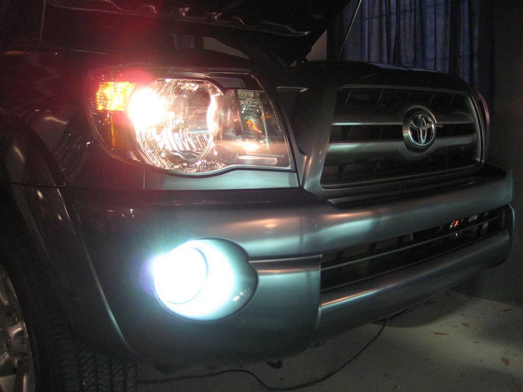

    Got my HIDs in today from slimcubby.. here are some pics:
    HID Fogs in.. stock headlights on
    Xenon bulb in Fog housing
    Grounding point for headlights
    All done
    Camera really made em look bluer than they are.. they are a nice crisp white with a tinge of blue. 6000K kit hi/low heads. Took about 2 hours to install NEATLY.. an hour of that was just getting the damn fogs to fit in the housing.. suckers didn't want to go in.

    Looks nice! I installed mine as well(4300k) and they are bright.Did you leave the chrome cap/cover/reflectors in the headlights bulbs?

    No, just asking because I was going to remove the cap because the headlight already have one. I don't know if I'll make a difference in output anyway. Also did you installed the chrome reflector on the bulb facing up(like instructions diagram) or down?

    I installed the chrome reflector with the opening facing upward. It seems to 'aim' the light a little more downward so as not to shine directly in oncoming traffic. It actually kind of cuts off the light angle more like a true HID light.

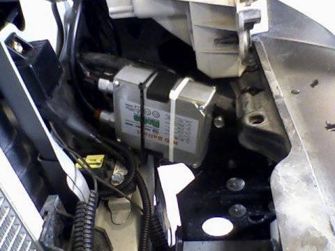

    where did you mount the ballast for the driver side HID? i got mine in but have no idea where mount it. it just hangs off of the battery mount rite now

    The ballast for the drivers side has enough slack that it actually mounts nicely around to the right side of the battery. I mounted the passenger side one right in front of the washer fluid tank.

    i mounted mine on the bumper brackets. just drilled a hole to put a screw on one side and zip tied the middle of it just to be safe
