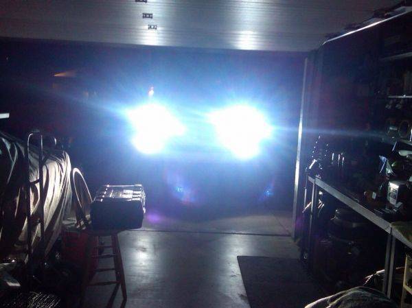

    i beg to differ! my 8k's are way brighter than factory
    unless this isnt brighter than factory?

    those are 8000k's in stock housings?

    Anything I do I do right the first time. Biggest pet peev I hate redoing things. So to finish, If I aim my 8000k's properly in the stock housing then I will have excellent lighting and not cause oncoming traffic to swerve in my direction? :D

    8K is for morons anything over 4300 is dimmer. 5K is dimmer than 4300 and 6K is 50% less output than 4300.
    Next, putting HID in the stock reflector housing is 100% illegal in all 50 states. I pull people over for it all the time. Have statred writing tickets for it where I used to give warnings. More and more people seem to be doing this and its the worst in lifted pickup trucks. Its easy to give them tickets becasue NO pickup trucks come stock with HIDs and they are the ones who blind the worst.
    If you want to do it right the first time use a XENON reflector housing, like a projector. Use 4300K bulbs. THat is doing it right and anything else is wrong and illegal.

    another false statement. 8000K do not produce more lumens than a 4300K oem bulb. period
    they have more glare than oem, thats why they appear brighter
