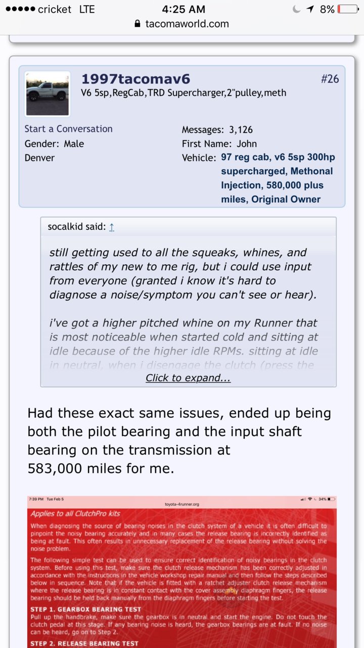

    That was before I had my clutch and transmission fixed. Had lots of noises, apparently NOT gear noise.
    I had a input shaft bearing go bad and was fixed 2 days ago apparently the input shaft bearing and the pilot bearing both went out
    One doesn't really know 100 percent until the clutch area is opened up to see whats going on, I had no idea my pilot bearing was bad too, its up and running and I have zero gear noise now AFTER getting everything fixed

    No, I have had zero problems with my transmission 583,000 miles till now,
    Besides replacing the stick shift bushing.
    Then had all these noises coming from the clutch area.
    Maybe because the input shaft bearing failed it caused the pilot bearing to fail.
    Not sure but the pilot bearing was replaced 95,000 miles ago so didn’t have that many miles on it.
    Dealer did the all repairs.
    I had MT -90 Redline oil put back in.
    Transmission is quiet now.
