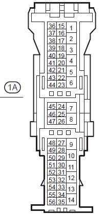

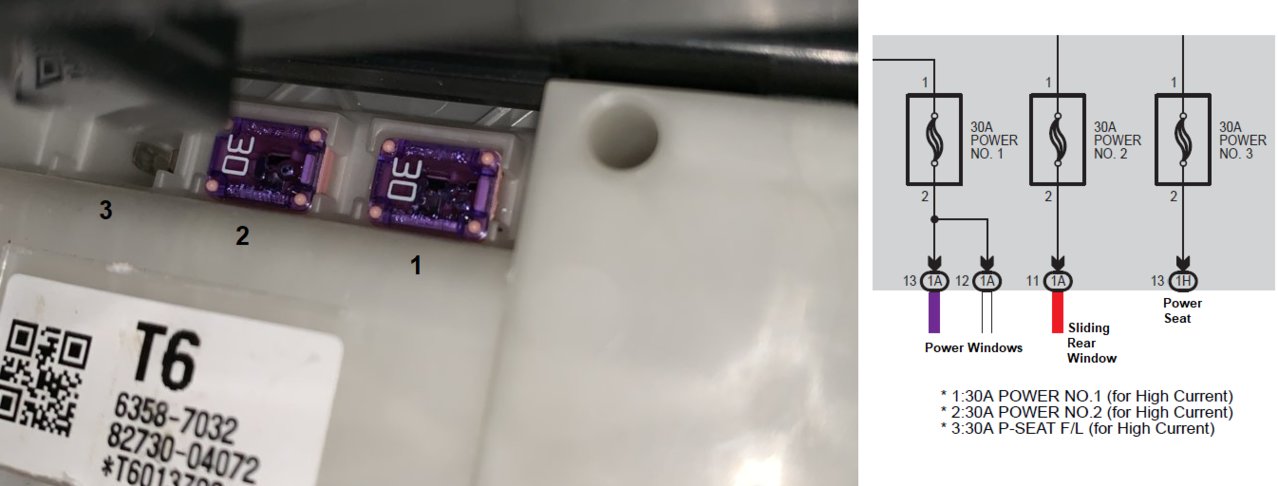

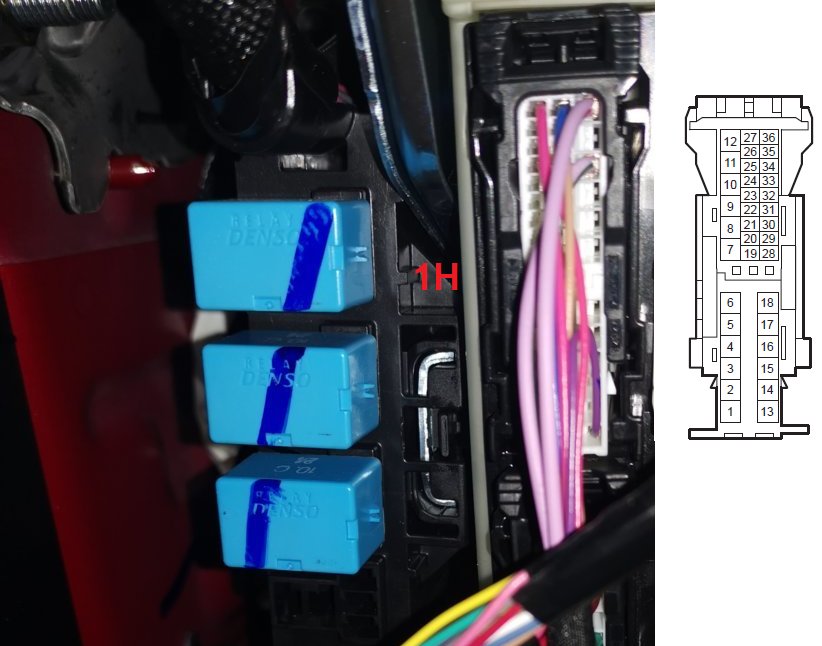

    *Not all models, but these are some high amp fuses that could be repurposed.
    Working on finding correct terminals (pins).
    1A bottom connector facing the firewall on the Cab Junction/Fuse box.
