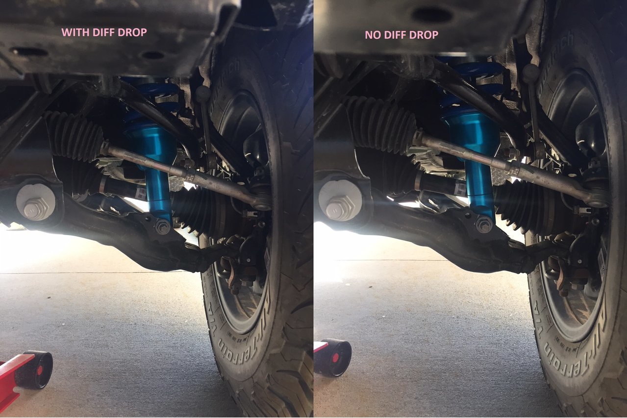

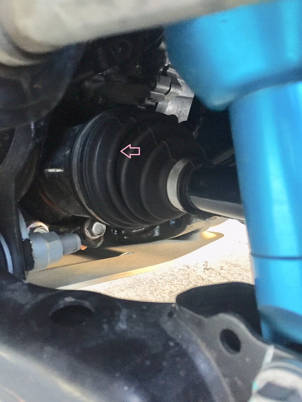

    So I just noticed a ring wearing on my inner CV boots. My truck only has 6000 miles. I have a 3" lift (extended kings). I took the diff drop out because it didn't seem to change the angle very much (see second pic). It was in the way of my TRD pro skid.

    This doesn't really answer your question, but on my truck I snipped off the clamps, slid the boot down like 3/4" and tightened a hose clamp on it.

    Here's what I've done: remove the oem clamps... slide the boot out until the fins don't touch... install norma slim hose clamps. Time will tell if they slide back, but so far so good.

    I guess what you also do is install another hose clamp directly on the shaft fairly close to the boot and then use a beefy zip tie to secure the clamp that is on the boot (likely with some grease under it) to the more secure hose clamp. Use it like an anchor.
