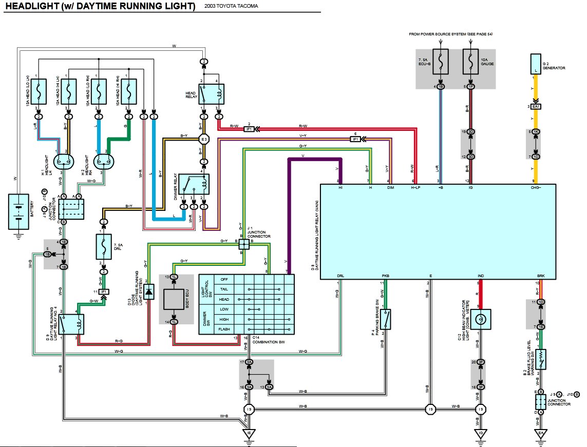

    What annoys me, Toyota already figured out how to do it correctly in their DRL version. It has separate 10A fuse for each bulb's filament and relays for high amp circuits. In that part the Canadian wiring is so much better. I'm jelly.

    I'm referring to Tacoma manufactured for Canada where DRL are required (The Motor Vehicle Safety Act dictates all vehicles sold or imported into Canada after Dec. 1, 1989, must have automatic daytime running lights (DRLs)). DRL version of Tacoma has completely different circuit diagram and connections for headlights. Dimmer switch is controlling lights through DRL Relay and all high current is going through relays only. Very same circuit could be adopted without DRL functionality (by removing few elements) but still keeping relay-switching high current circuits.
