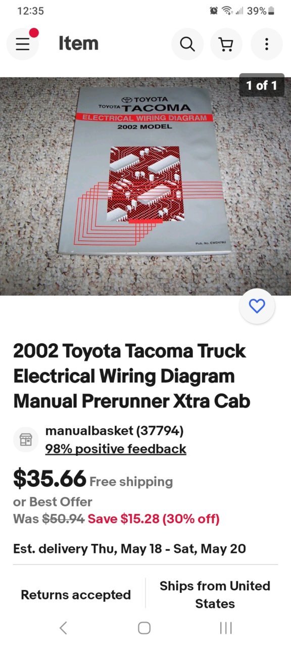

    Double check your hi-beam lamp by inserting in a known working lamp connector on the gauge cluster rear PCB. That will at least eliminate a chance of faulty lamp, thus cutting troubleshooting problem in half - divide and conquer. If that's not the problem than study this! Happy hunting Screenshot_20230514_123559_eBay.jpg Screenshot_20230514_123559_eBay.jpg

    Oops, wrong manual sorry but they make one for yours
