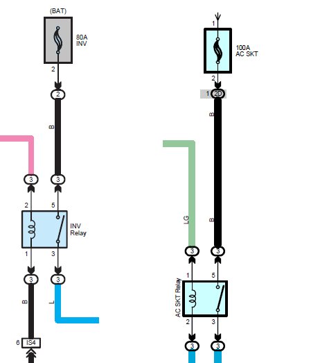

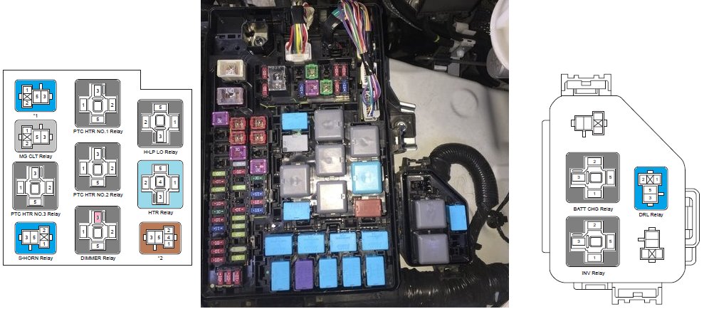

    The Dimmer relay is same part number as the Inverter*(80 amps) and a few others that handle a higher load. You could wire/tap into pin 3 and add a fuse then to your light bar. Run the ground wire of the added light bar to a cab switch for OFF when necessary.
    *Part Number: 9008087024
    ACC; BATTERY CHARGE; CIRCUIT OPENING; CIRCUIT OPENING (FOR EFI); COOLING FAN; COOLING FAN, NO. 2; DEFOGGER; ELECTRONIC FUEL INJECTION MAIN, NO. 3; FOG LAMP; HEADLAMP; HEADLAMP DIMMER; HEATER; HEATER, NO. 1; IGCT; IGNITION CONTROL; IGNITION, NO. 1; IGNITION, NO. 4; INVERTER; OIL PUMP; PTC HEATER; RUNNING LIGHT; SUB BATTERY; SUSPENSION CONTROL; TOWING TAIL; WATER PUMP; WINDSHIELD WASHER; WINDSHIELD WIPER.

    None of those relays are capable of 80 amps. Not sure where you are getting that from.

    That relay is only rated around 30 amps. And the inverter itself isn’t going to draw 80 amps or put out that much

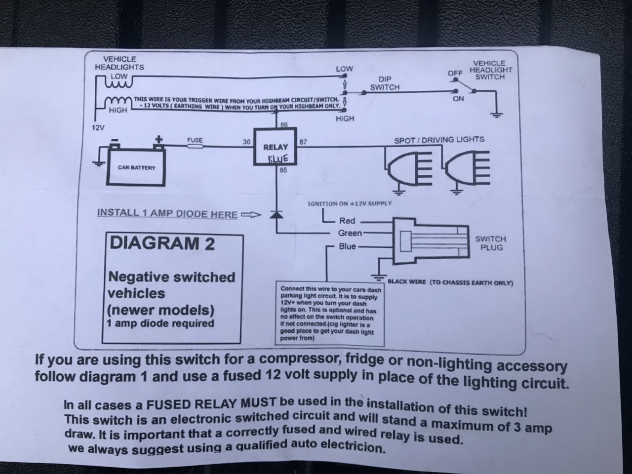

    Well I’m having trouble getting mine to work properly. It was super easy on my second gen. When I connect everything according to the schematic I posted above, everything works except it comes on with low beams and not high beams. Can I not tap into the harness just before the bulb for the trigger? I’m wondering if the relay is wonky for some reason. I used the relay that came with the light bar harness and rewired a harness to follow the schematic. Aren’t all 4 pin relays the same? No matter what configuration I used, it will not illuminate with the high switch. Any insight or advice would be greatly appreciated. I’m working on a 2018 sport DCSB 6 MT.

    Actually this is the wiring diagram I’m currently using. The schematic in my previous post came with the switch I used in my 2nd gen.

    I used an H11 extension so I wouldn’t have to cut into any factory wiring. I used my meter and checked for 12v at the high beam bulb connector while moving the selector, and tapped the side that didn’t show voltage. That schematic shows “earth” for the connection. But even swapping that connection in my case didn’t allow the bar to light up with the high beams. It either works while low beams are on and high beams are off, or it’s on constant. I’m perplexed.

    2. The schematic calls for using the -12v earth for the high beam. When using a volt meter this would be the wire that shows zero voltage no matter where the high beam selector is positioned, correct?

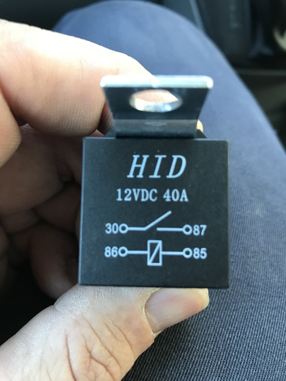

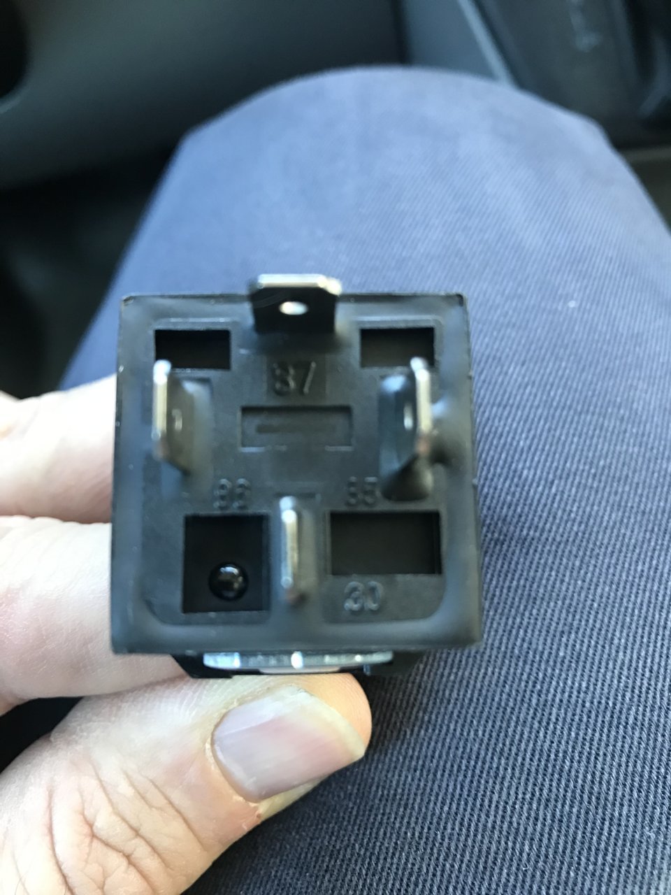

    Here’s the relay that came with the light bar harness. I guess that diagram means it’s normally open? It definitely works in that I can hear a click and power feeds through it. It’s just not doing what it’s supposed to. I may run by autozone and compare with another 40amp relay.

    Edit: looking at the schematic and the relay, that should work properly. Headlight wire makes connection with AOB switch to magnetize the coil in the relay, closing the switch in the relay to feed 12v from battery to light bar.
    That leads me to believe my fault is somewhere on my high beam wire.
    I need to research how to test this relay.
