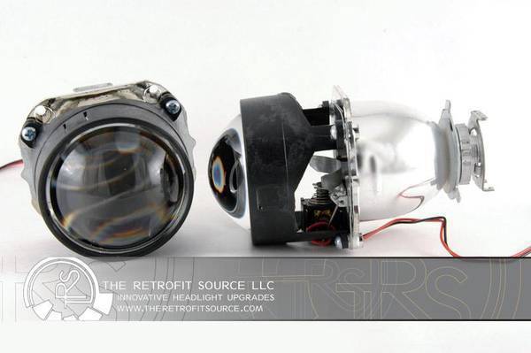

  15. Aug 3, 2012 at 3:28 PM
    03is300ztk
    03is300ztk Well-Known Member
    Dec 16, 2011
    #68845
    398
    Zach
    Somewhere in the hills NC
    07 Tacoma 4X4
    Grillcraft, with front and rear bumper/bed in the works.
    In this picture, the projector on the left, the metal "FLAP" that is what creates your high beam, it moves allowing more Light to pass by creating more light output out of your headlights.
