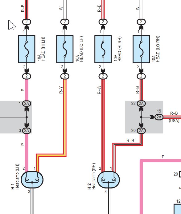

    Hey there! This is my first post here so what’s up! Anyways, my high beams whenever i throw em on kill my headlights completely and I have not messed with anything lately. I’m curious if anyone knows anything about this, thanks!

    Since you have a 2014 (2nd Generation) Tacoma, you have 9003/H4 dual filament headlight bulbs. You can only run one filament at a time - high or low beam - due to the amount of internal heat generated. So when you go from low beam to high beam, you switch filaments. You don't get both. If you have functioning low beams and the headlights go out completely when you switch to the high beams, the first thing I'd check is the bulbs. It is indeed possible to blow both high (or low) beams at the same time.
    You can also check the fuses. The high beams are run through fuses 17 & 18 in the fuse box under the hood.

    It's normal for the low beams to turn off when you turn the high beams on, so that in and of itself isn't alarming to me. It sounds like you're on the right track with your troubleshooting. When you move the stalk to turn on the high beams, does the blue light on your dash come on? If it does that would lead me away from the switch and towards the bulbs or the wiring to the bulbs. Do you have a multimeter? You can check at the fuse to see if you've got 12v to ground on both sides of the fuse with the high-beam switch on. If you do, next check voltage at the plug to the bulb. If you don't, your problem is going to be somewhere else :)
