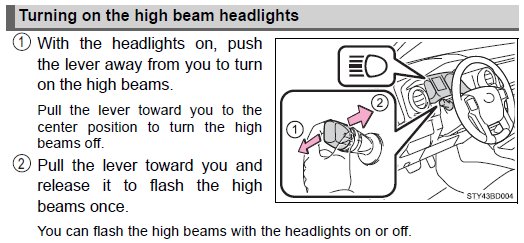

    As in flashing High Beams works?

    If low beam is ON, and the light stalk at the steering wheel is rotated to high beams, both are on (HIGH & LOW).

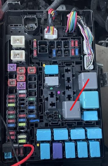

    Do you know how to remove a relay?
  10. Jan 23, 2022 at 1:54 PM
    polak187
    polak187 [OP] Member
    Jul 9, 2019
    #298747
    13
    2017 SR5
    Yes. Just pull it straight up right? Would it be the H-LP LO one? I’m stopping at the parts store tomorrow to get it.

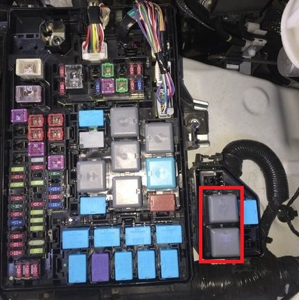

    Do you have any of these relays installed/available?

    this is my fuse box
    https://imgur.com/a/BrjkJqJ
  15. Jan 23, 2022 at 3:04 PM
    Vlady
    Vlady Well-Known Member
    Dec 20, 2017
    #238986
    4,619
    Issy, WA
    2017 White SR5 DCSB V6 4x4
    Did you try to disconnect add a fuse? Looks like you hooked it up to a low beam.
