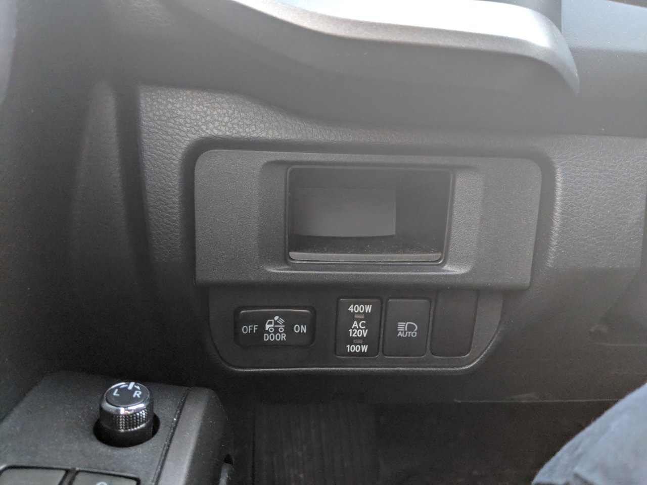

    Do you have the "automatic high beams" switch? And if so, is it on?
    Jere and 5nahalf like this.

    2016 White Tacoma TRD Sport 4x4
    I don’t believe I do.

    Got a button that looks like this?
  18. Mar 13, 2019 at 1:13 PM
    #18
    Tactical_Tony
    Tactical_Tony [OP] Member
    Apr 2, 2018
    #249251
    21
    Antonio
    Nope.
  19. Mar 13, 2019 at 1:14 PM
    #19
    CttAznRanger
    CttAznRanger Crazy NE Asian with the Cali Lean (temporary)
    Dec 3, 2018
    #274702
    4,750
    Brandon
    Boston, MA
    2018 Tacoma TRD Sport
    Nevermind then, I am 100% wrong, ignore and continue on. Good luck with finding the problem.
