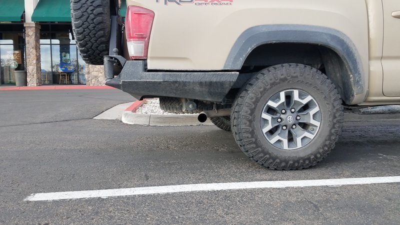

    If you get a HC rear, get the swingout and mount the spare there. Problem solved.
    Also chop the exhaust... All of the trucks with HC rears on this thread have their exhaust still sitting way low behind the wheel. That's going to get torn off on the trail if you ever actually use that rear bumper on the passenger side. I chopped mine just after the axle.
    Here's a pic of the rear when I was chopping the exhaust before I took off the factory spare... Not sure if this helps:
    CHOP THAT EXHAUST!!!
