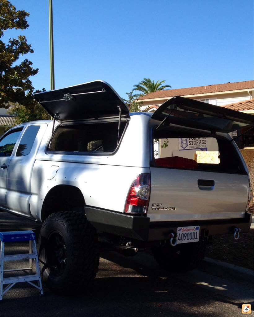

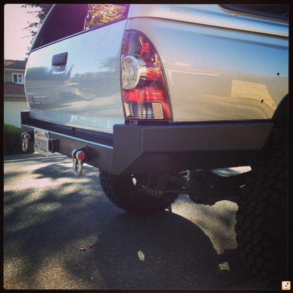

    I got the goods and installed it yesterday. The fit and finish is perfect. This bumper is so badass. I love how much clearance is added to the rear.

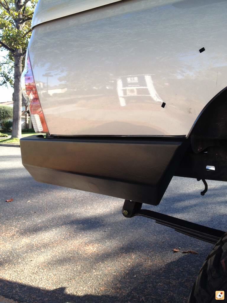

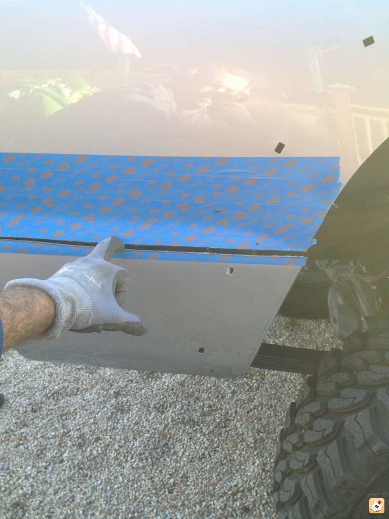

    Installed it this past Saturday and finally got around to trimming the flares yesterday evening.

    Looks good Chris!

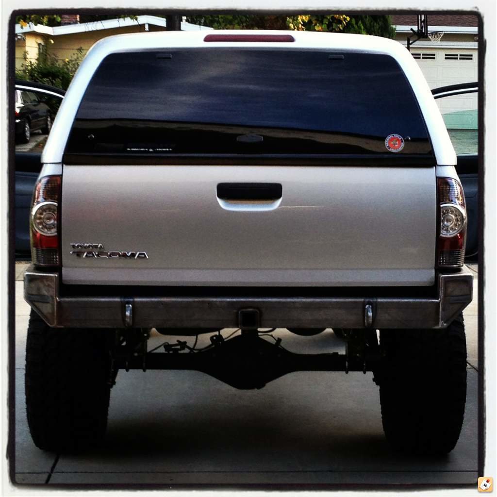

    All painted up now.

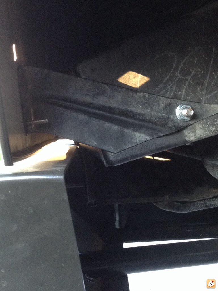

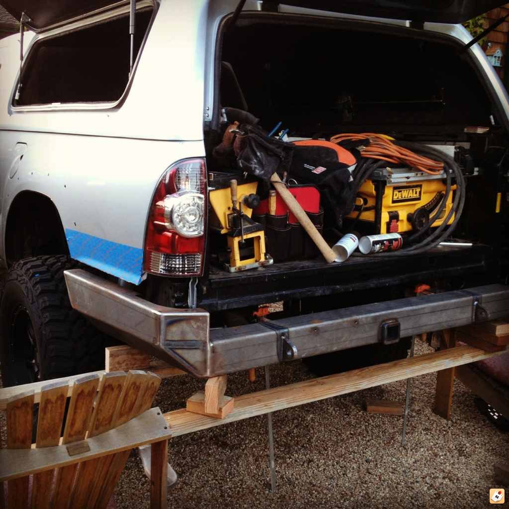

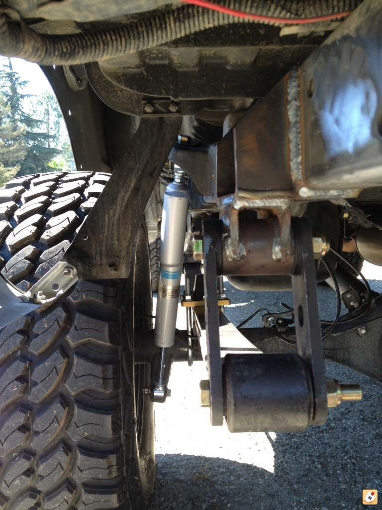

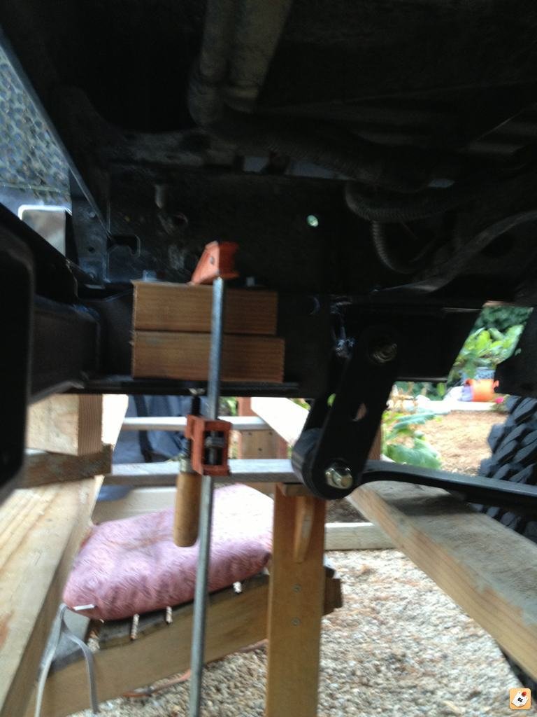

    I reused the metal mounts to reattach the rear panel back to the frame. It turned out well. I bent a 90* at one side and cut the other side. Drilling a hole with a step bit through the body and bed liner compartment did the trick.
    Original bracket location
    New mounting point

    I cut 3" off either side of the spare tire access hole, still a pain but I have access.
    I did something similar with the fender brace but used the stock mount holes on the bedside and drilled a new hole in the fender.
