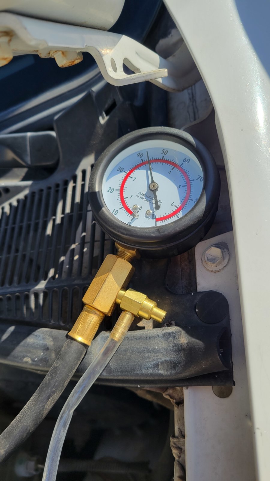

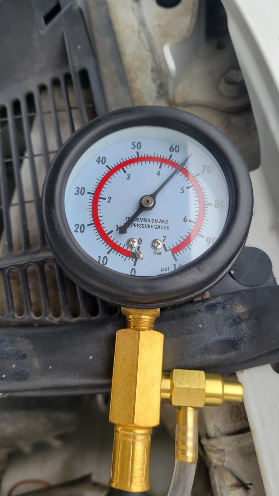

    Did a bit of testing today on my 2006 4.0 Tacoma. Fuel pressure was over 60psi while running, let it get up to temperature, high pressure persisted. I installed a new OEM fuel pump last August. Could the fuel pressure regulator on the fuel rail be the culprit?

    How do you have the pressure gauge connected?
    It should be teed into the fuel supply line going to the fuel rail. If you dead head it into the gauge it will read high (60~ psig), as the regulator will be out of the circuit when dead heading.
    Tank >> Filter >> Pump >> Fuel delivery tubing >> Fuel Rail >> Fuel Rail Regulator ( Set to ~ 40 - 41.7 PSI) >> Return to tank.
    If you tee into the delivery tubing the regulator still works and reads the regulated pressure ~ 40 - 41.7 PSI.
    If you dead head a gauge at the delivery tube it reads full pump pressure ~ 60 PSI.

    This is the T connector set I used, had it connected to the feed side coming from the pump. I doubt the guage would be off by 20psi... Then again stranger things have happened.
    I will order a fuel pressure regulator and see if that helps.

    Well the new fuel pressure regulator seemed to do the trick! Brought the fuel pressure back down right around 40psi. Let it get to operating temps, shut it down and it held pressure just fine. Thanks for all the help!
