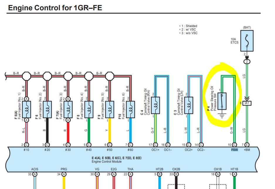

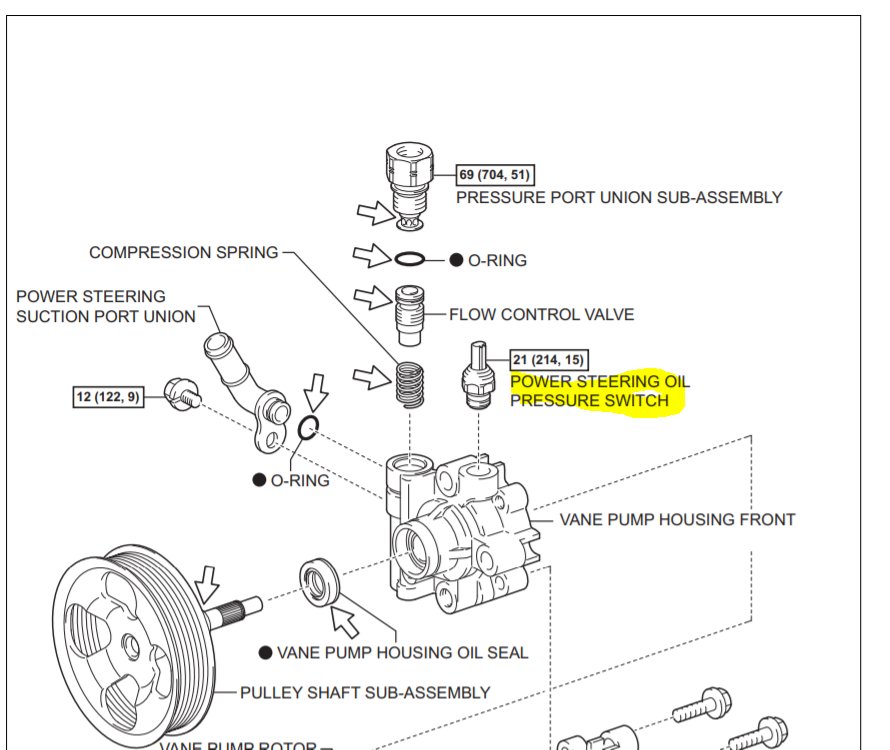

    I think I'd want to look at the power steering pressure switch PID in scan data, if it's on all the time with the switch plugged in and the switch is new I'd put a gauge on the power steering and see if it's building up too much pressure for some reason and keeping the switch turned on which in turn would increase idle speed.

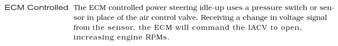

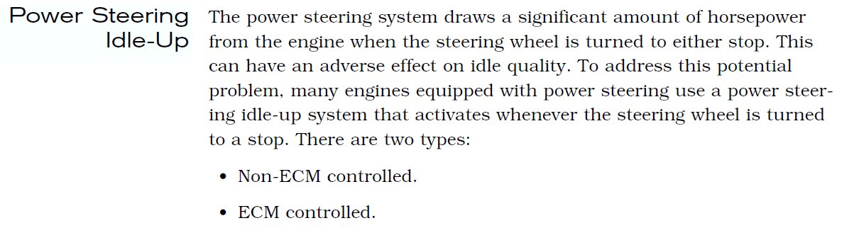

    Based upon what @Dm93 said, I think that switch only matters when you're idling. The power steering puts a load on the engine and the already pretty low idle speed could drop more than desired which is why Toyota put it in there. If you're moving a boat around, you won't be idling that often. And like I said, you'll figure out if it's an issue soon enough, in which case you can just plug it back in yourself.

    Correct it is there to raise idle speed to compensate for the extra load of steering at slow speeds, not a huge deal if it doesn't work you just may notice slightly increased steering effort is required when trying to steer while idling.

    Switch should be open for normal operation and closed to create a high idle. If you've unplugged switch and idle returns to normal, it is likely that switch has went bad.
    In addition to the power steering, some other things to check for high idle is that there is also an idle up circuit if you have the 120VAC voltage inverter, driven by the input "ELS2" into the ECM, an idle up driven by "ELS" signal via the tail light circuit ECM, and an idle up for AC controls via the "AC1" circuit in the ECM.
