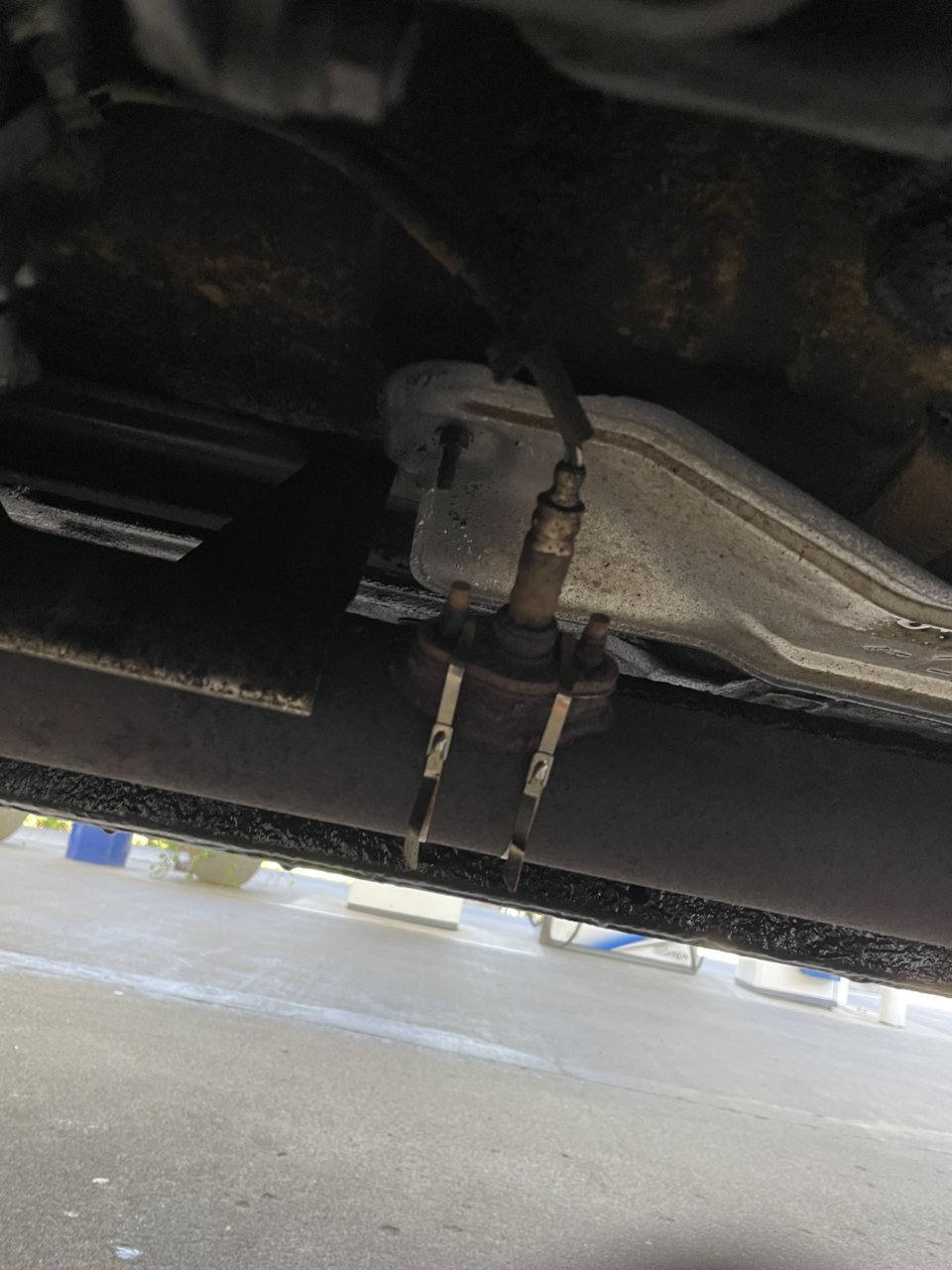

    i mean the bolts were rusted so i did this, i still think the sensor is fine? and this was a while ago where as the idle issue is recent

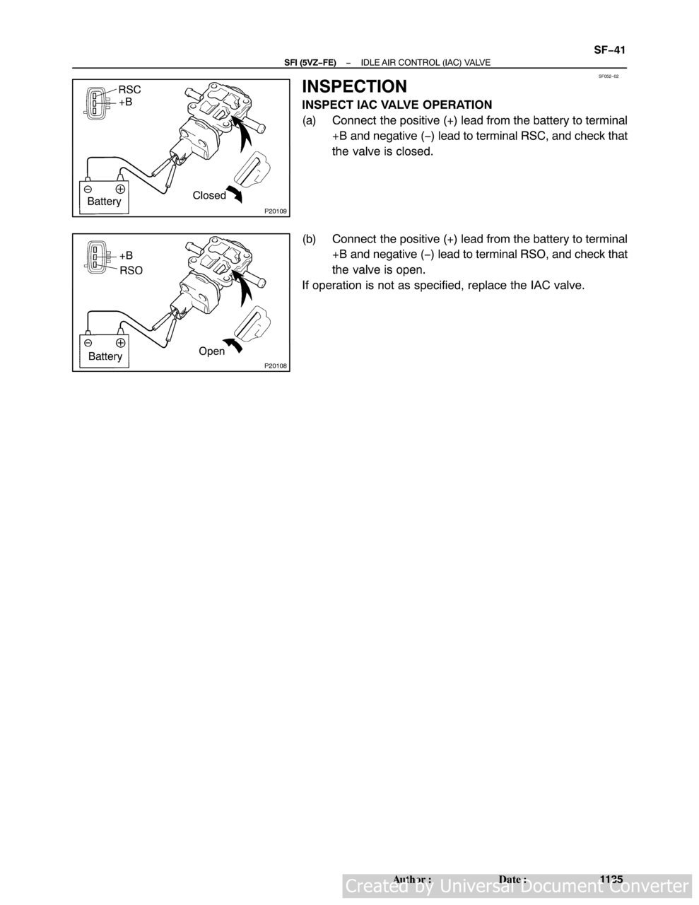

    The P0505 essentially means the PCM is unable to control the idle speed, it could be a vacuum leak, bad or stuck IAC, open or short in the wiring from the IAC to the PCM, or a bad PCM.
    You can test the IAC by applying power to it.
    Actually on Toyota's the coolant temp has to reach about 174F before idle learn will begin, doesn't seem to matter whether or not they are in closed loop.
    I think the OP has something else going on though since it's actually setting an idle code, there's alot of things that can cause it and the troubleshooting chart for that code isn't all that helpful.

    Did you fix the exhaust yet?

    Exhaust is fine. Cleared the scanner, drove it 6 hours and it's not showing a code for the o2 sensor. I'm not in a position right now to weld on new studs anyways.

    Good news for you- those studs are just screwed in there. Just need to twist 'em out, and put some new ones in there.

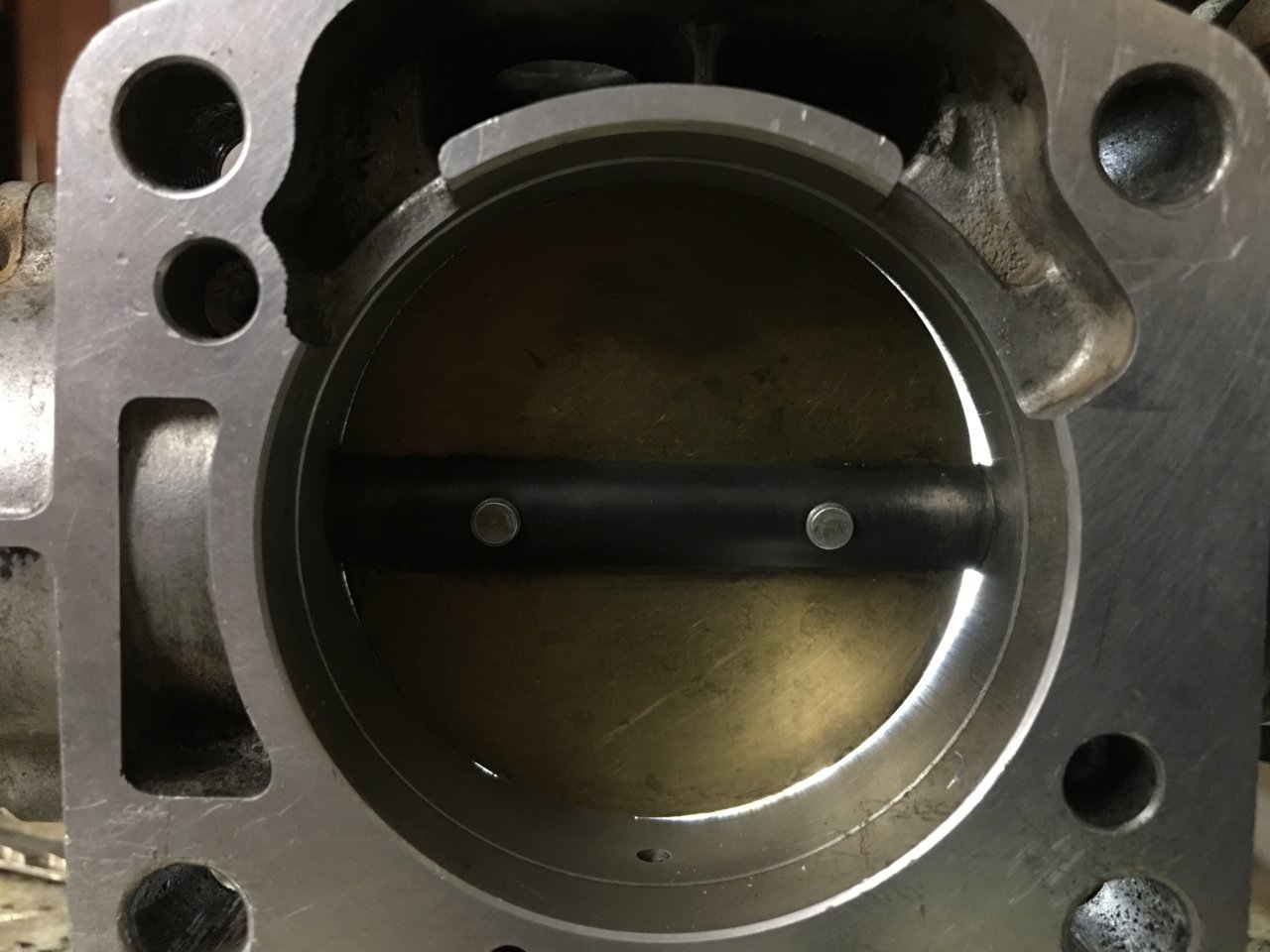

    Are the bore or throttle plate wore out?
    *image for example only
  16. Sep 18, 2023 at 4:11 PM

    Not sure I understand, the threads are literally rusted, and new nuts won't screw on to it.

    asked the tech and he said no

    Ahh, the 'butterfly flap'.
    I see now.

    My 98 had the high idle after cleaning, checking everything else out. I purchased a low mileage throttle body and that fixed it. I took my throttle body off and held a flashlight behind it and I could see quite a bit of daylight and it had side to side movement so it was pretty worn out. I know you said the mechanic ruled that out but if you are not looking at it that way you can not tell by just eye balling it on the engine. Has to come off. It could be that or it could not.

    Those threaded posts that you're saying are too rusted to thread a new bolt onto- those are threaded into the bung. Not saying these are the right size, but should get the point across:
