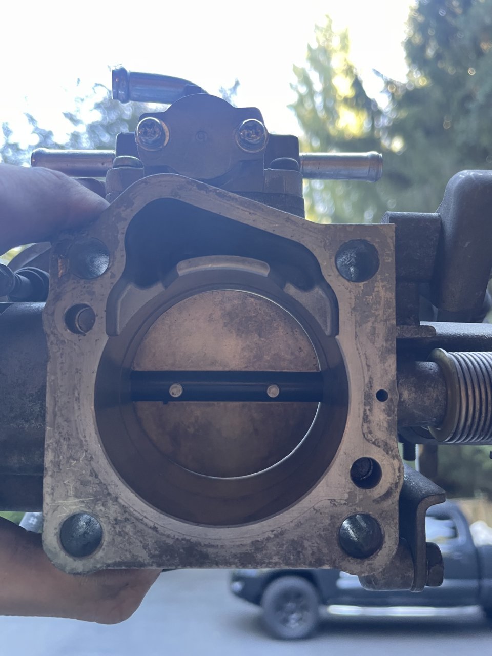

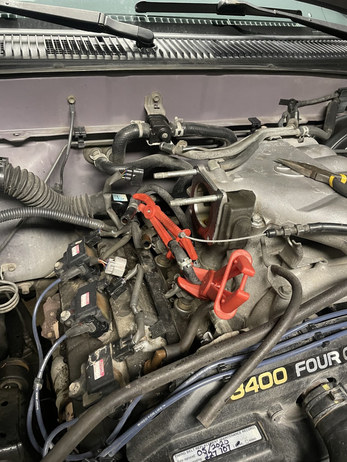

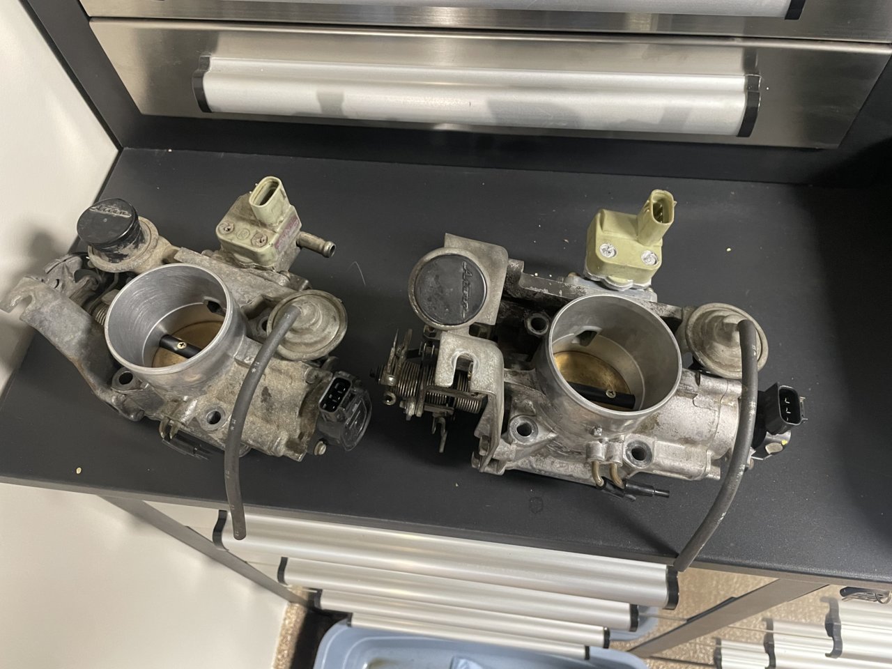

    Update. Hopefully this thread is useful to someone else someday.

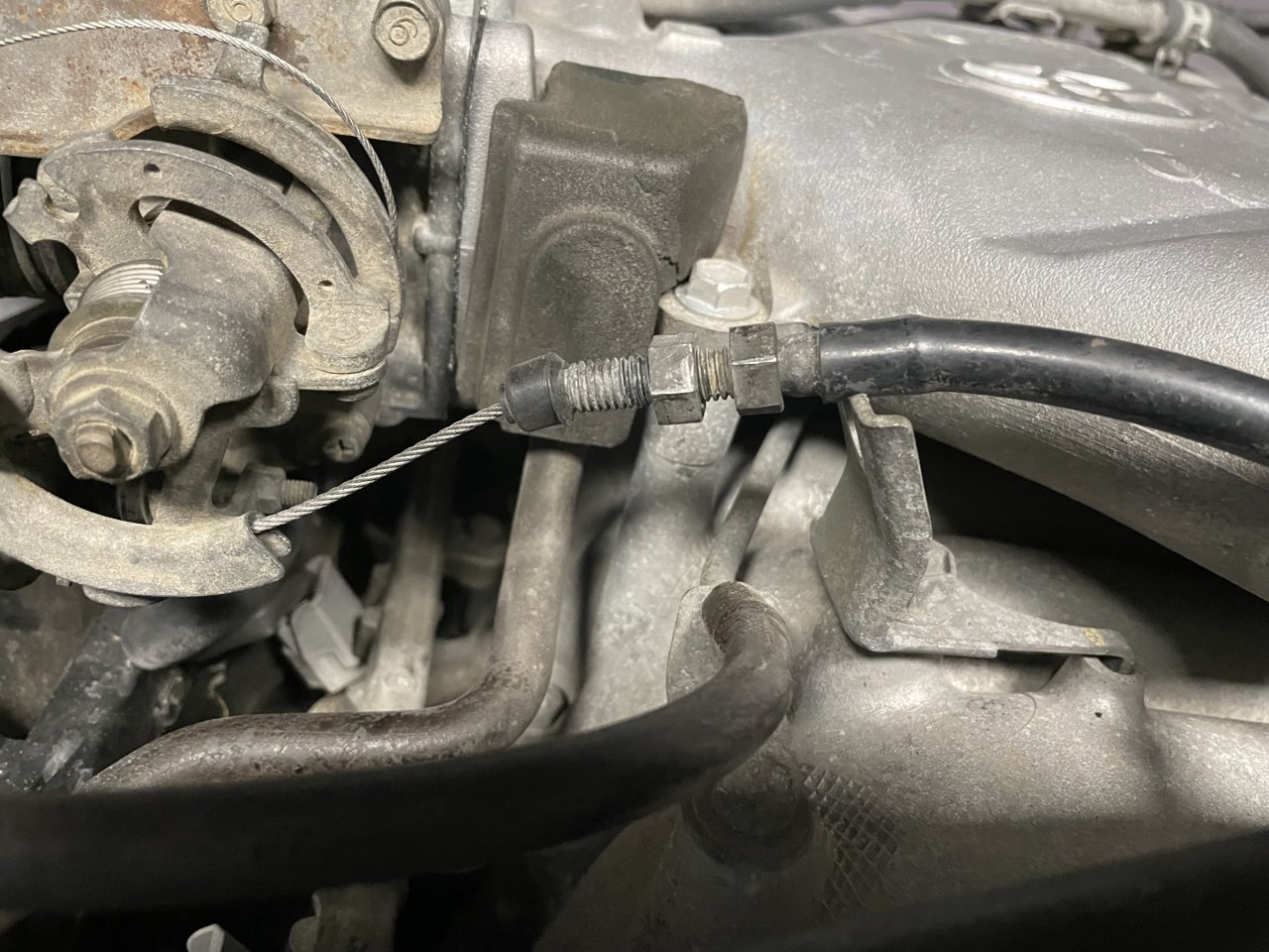

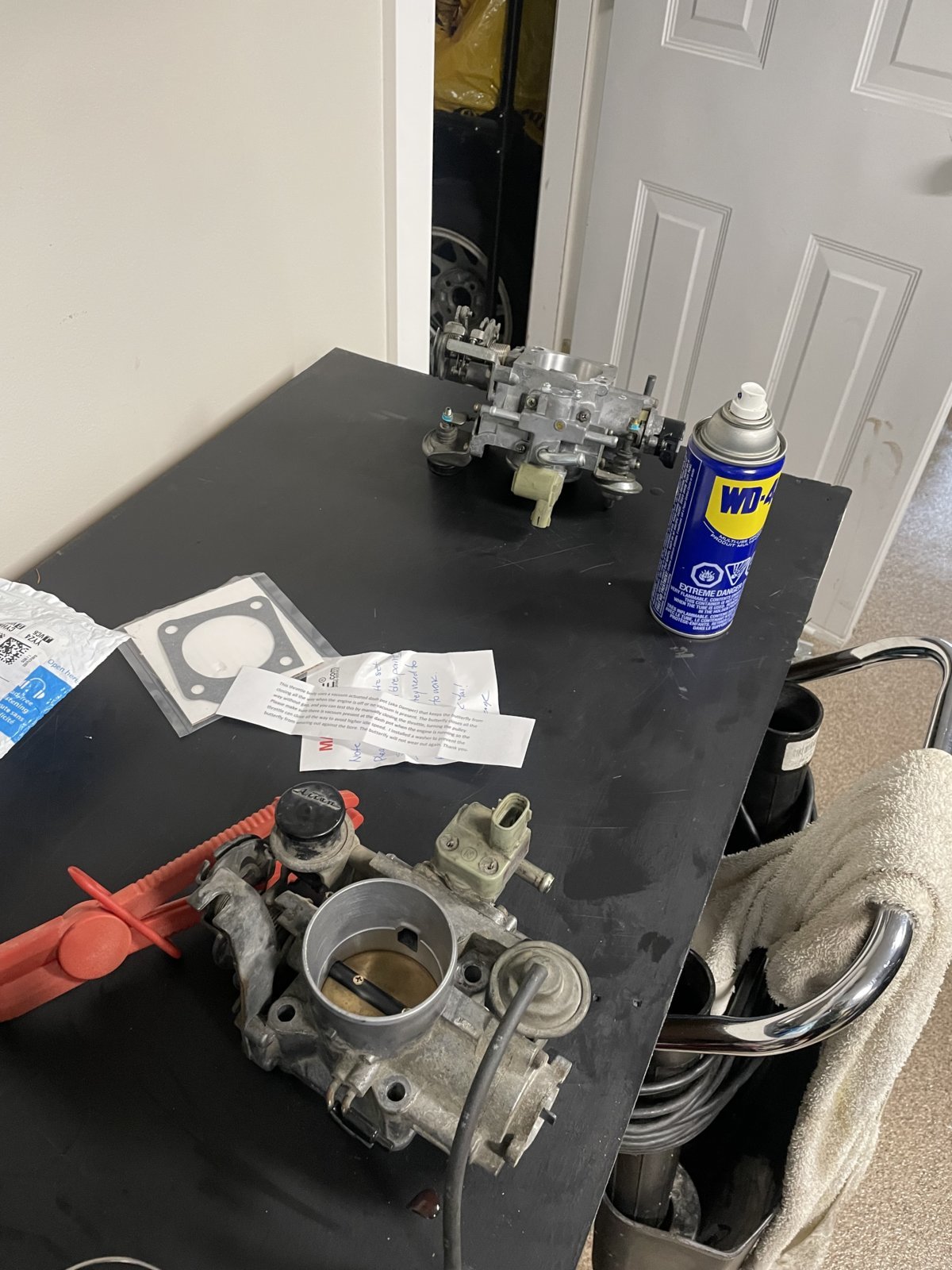

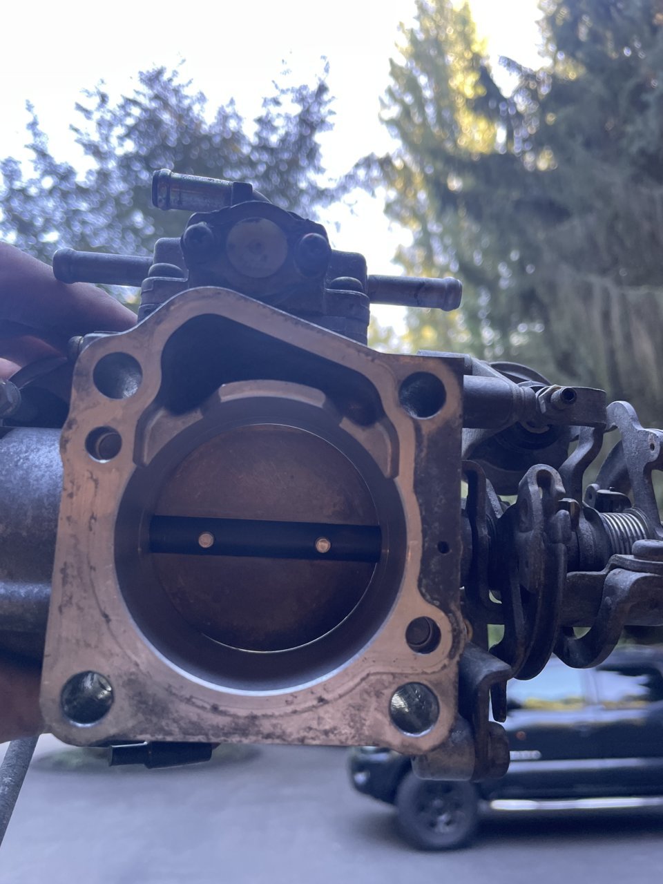

    Swapped in a 98 runner throttle body, and now my idle has dropped down to 850/900, which is much better. However, the throttle cables aren't lining up (one is an inch too long/too much slack, the other is an inch too short, not enough cable. so I can't drive my truck. Since, I've narrowed it down to the TB, I'm gonna send my old one to Maxbore and have him fix it. However, when looking at the gap on the butterfly valve, they are actually still very similar. See pics
    Old TB
    Swapped 4runner TB:
    4runner TB on left, which idles fine, original TB on the right, idles like shit but visually looks in better condition
    Throttle cable issues:

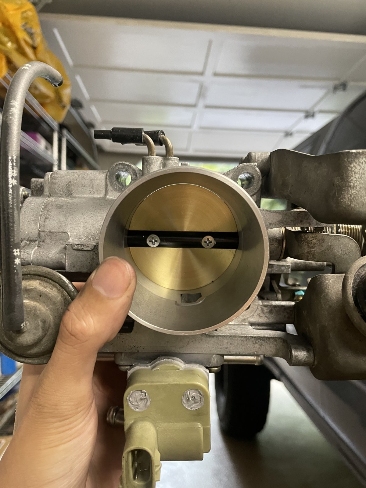

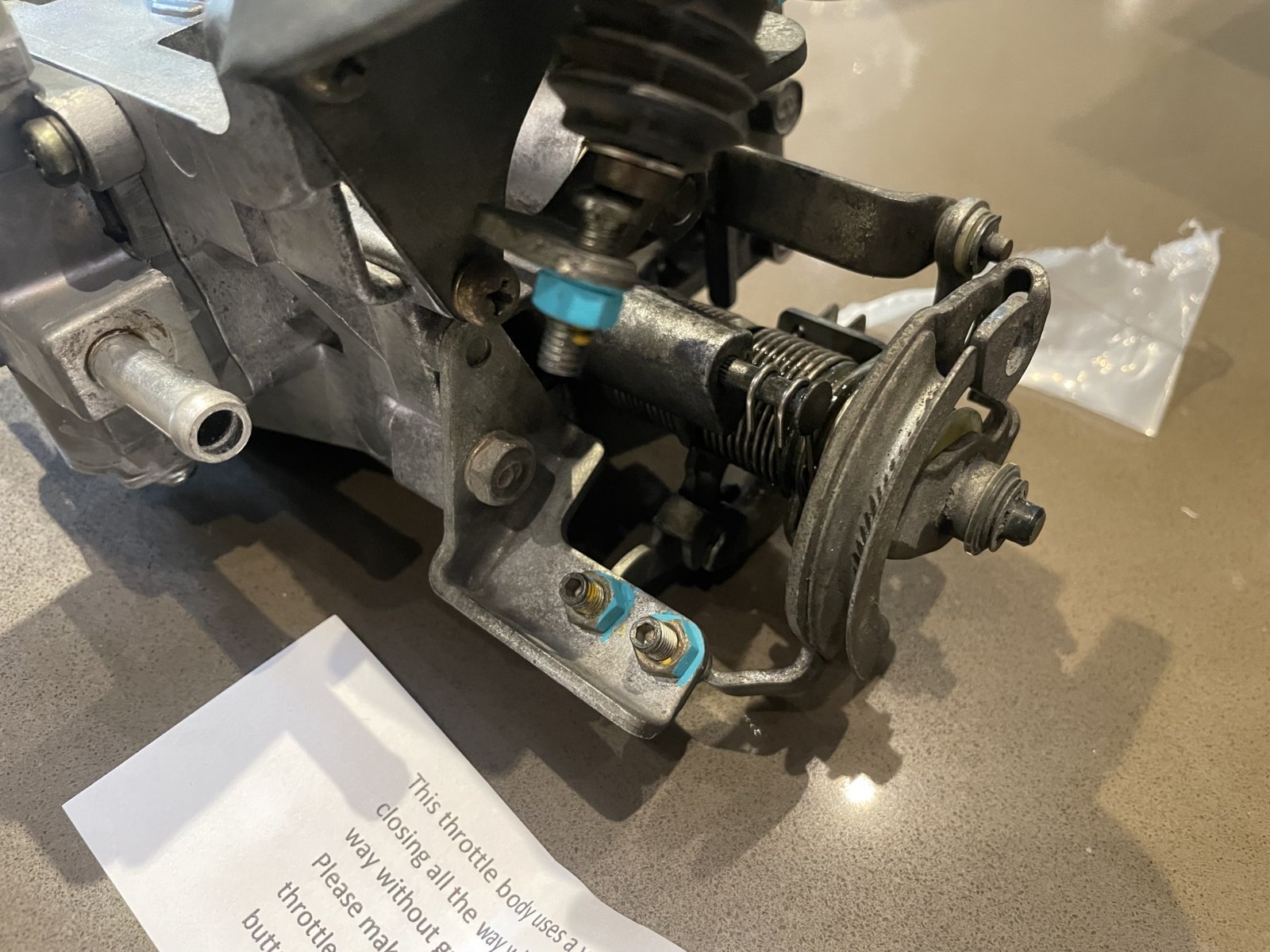

    Update. Problem solved. Got the re-bored TB back from maxbore, he did an excellent job.
    Be careful when you ship stuff to him, I didnt pack my TB properly and the TPS sensor broke, don't use bubble wrap like I did, it will pop.
    George did a really good job with the Re-bore and my TB looks new again. He also added some kind of washer so the butterfly flap won't wear out again.

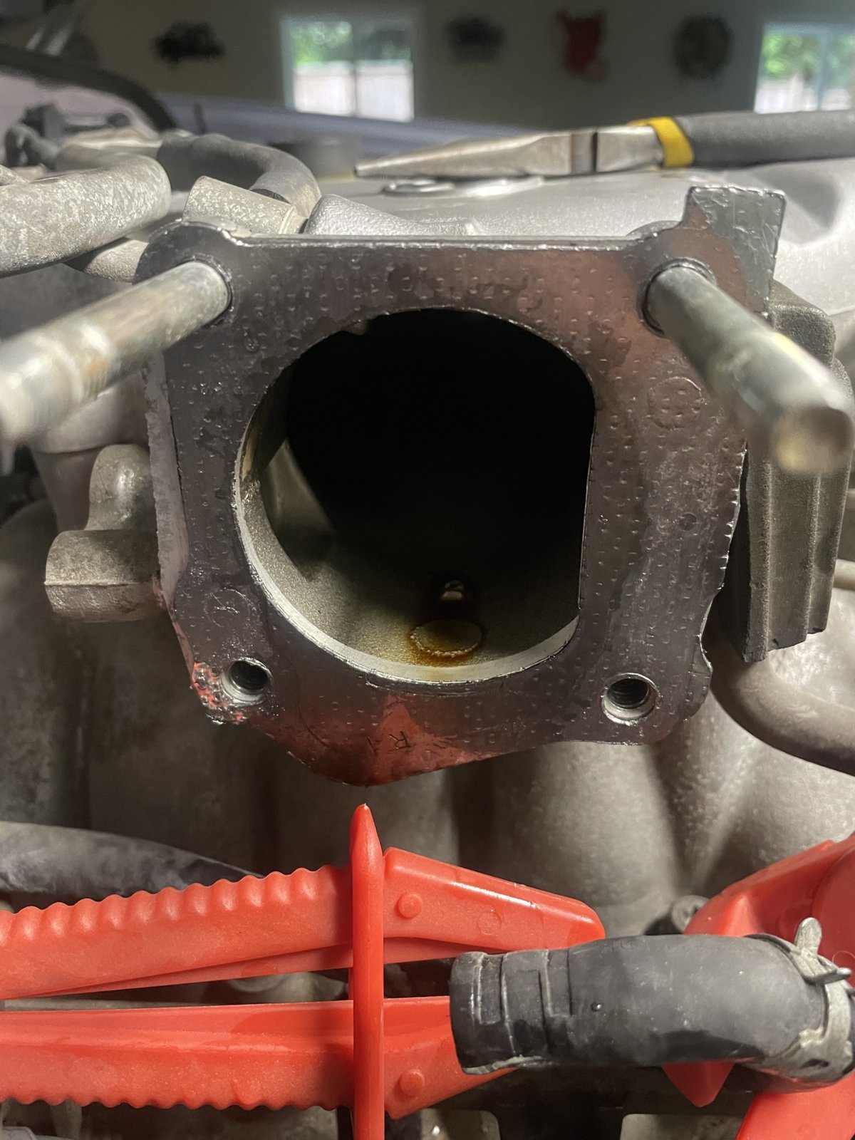

    Noticed some oil in here before I put the new TB back in, hopefully this is normal?

    Nice.
    Yea it's normal to have a small amount of oil in the intake due to PCV gases condensing in the intake.
