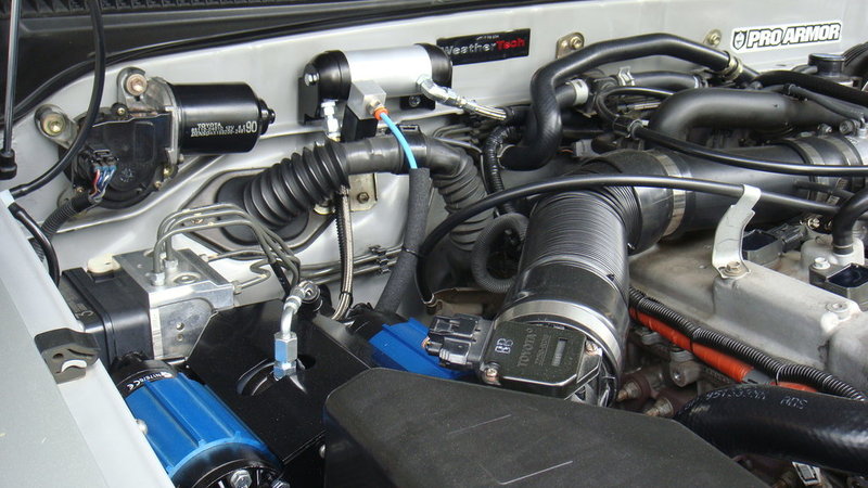

    Check the molded rubber line that exits the TB/ intake and goes to the rocker cover.
    As I have the 2.7, you'll see it here on the RT, 2nd hose from the top. It's the dull hose below the ProArmor sticker. I had loose connections and simply used zipties on each end to seal it up and have had zero problems since.
    Hope this helps you.
