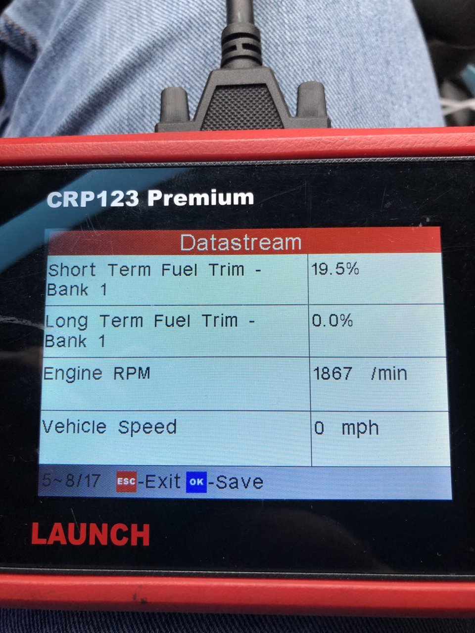

    Took IAC off throttle body and cleaned with cleaner and a old tooth brush. Had a scanner put on and had some confusing readings, man I’m lost!

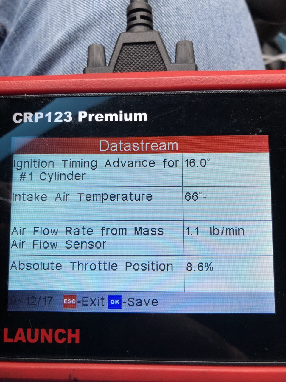

    EF78AA2A-6D71-4218-86D1-9111AD7200AA.jpgAirflow rate 1.1??

    FYI replaced the maf with a new one from advance auto... no change! Luckily the guys at advance let me return.

    Do you know if the the IAC is actually working?
    Hilljack[OP] likes this.
