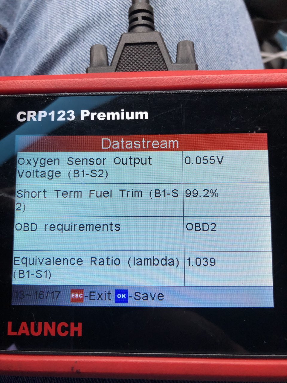

    The MAF should be around 1.7 lbs/min @ 2500 rpm.
    The 19% fuel trim has me “guessing” why it’s this high?

    B1S1 shows a slightly lean (15.3:1) AFR.
    and the B1S2 is dumping fuel at 99%
    At least that’s how I’m reading it.
    And I’m not too good at reading these things. Maybe someone more qualified and knowledge can help out?
    Then again, I thought B1S1 did most of the fuel work?
    Help. I don’t really know what to make of it?

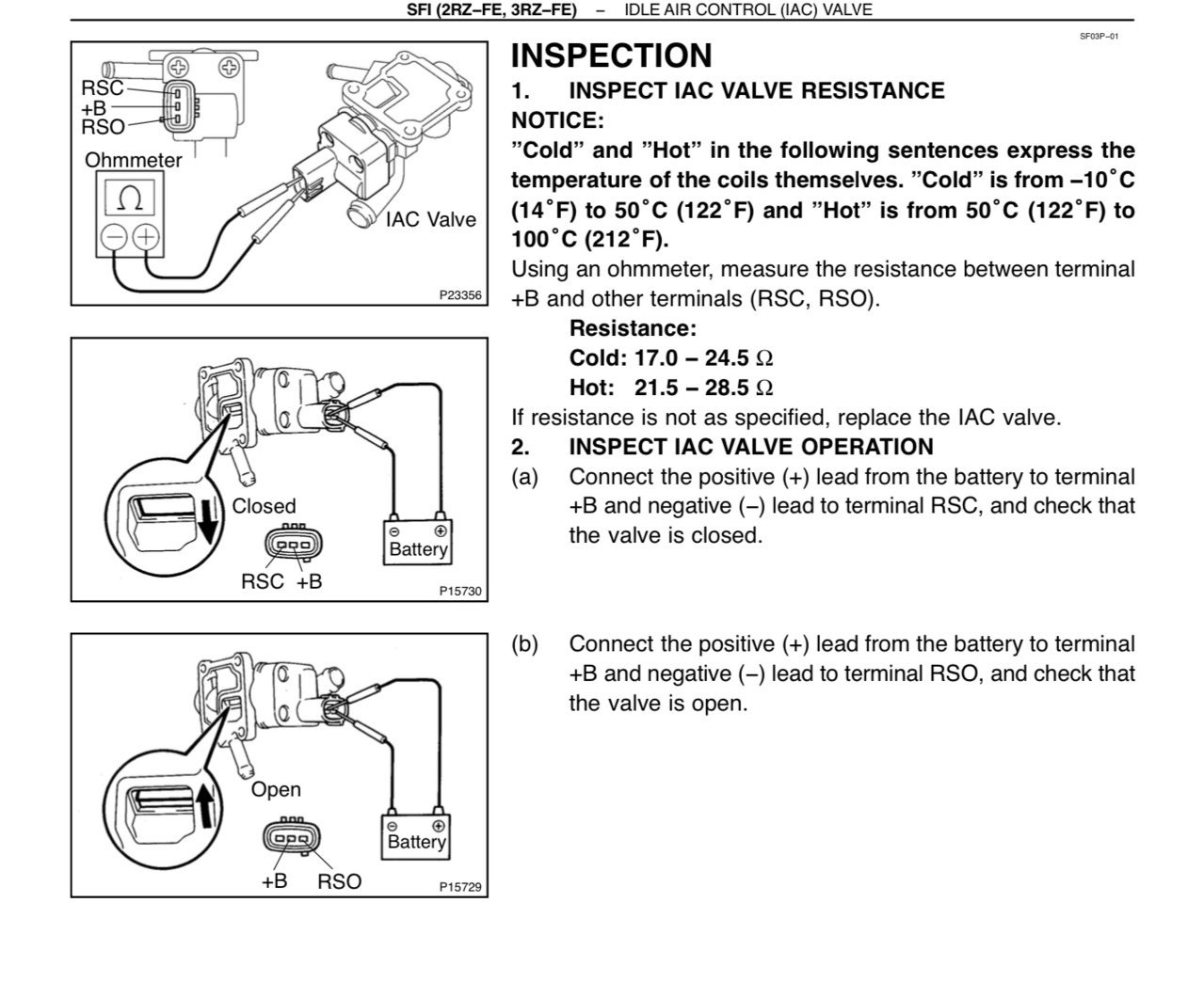

    One thing you could try if you have more time than money, is buying a super cheap $25 iac from Amazon. If it works, you confirmed the issue and you can buy a real part. If not, it’s only $25. In my experience, my original oem iac stopped working after i cleaned it as you described.
    also check this video for how to test it if you want.
    Let us know what you figure out.

    That's a good idea. I'll probably end up doing that. To test the IAC seems like a pain and I don't even have the right tester leads for it, so I might as well buy cheapo part (for now) like you said. So far, no vacuum leaks (that I know of) and no CEL. Truck runs fine once in gear, but P and N stay at 1900, even after battery reset and driving some miles.
