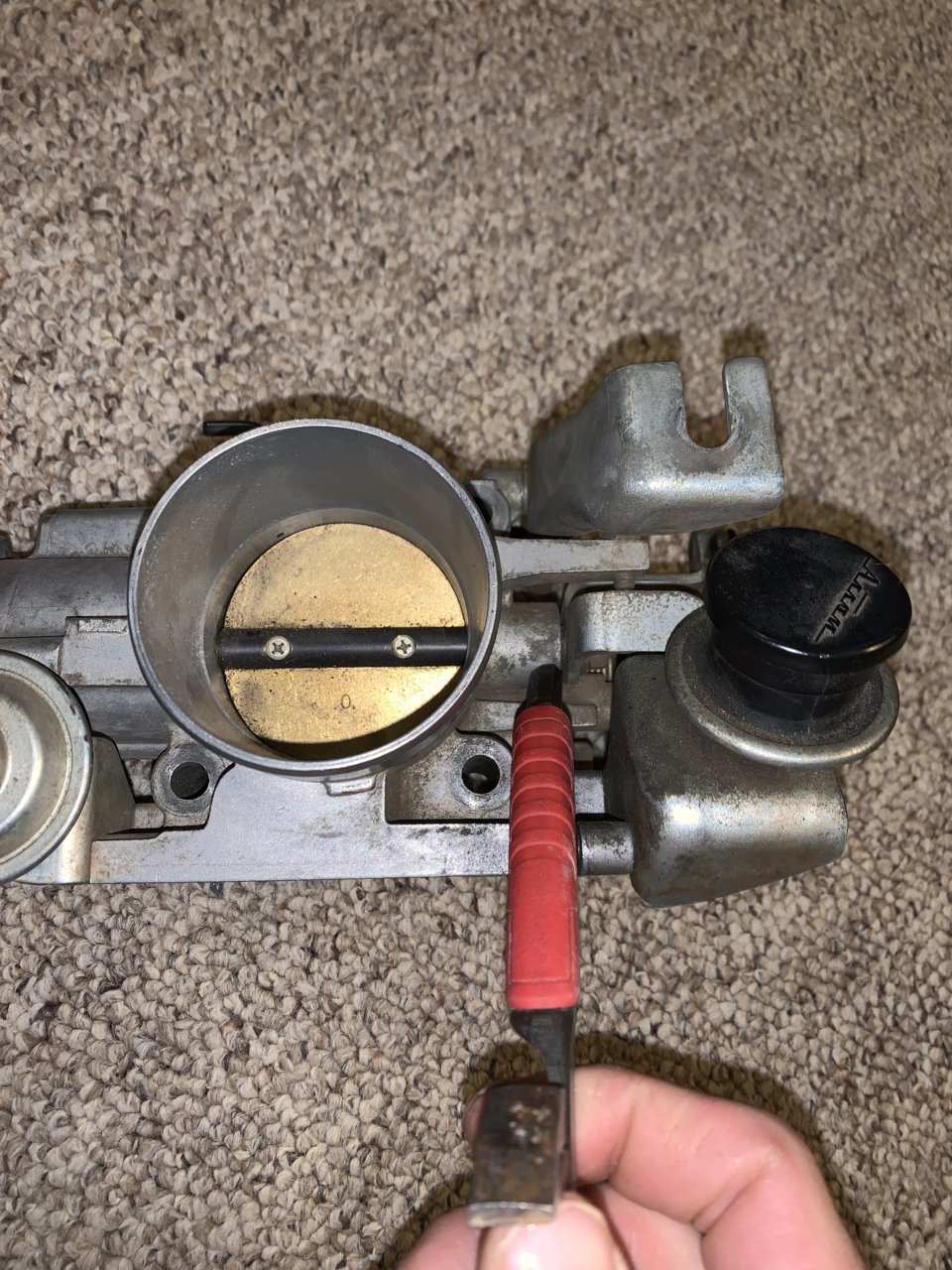

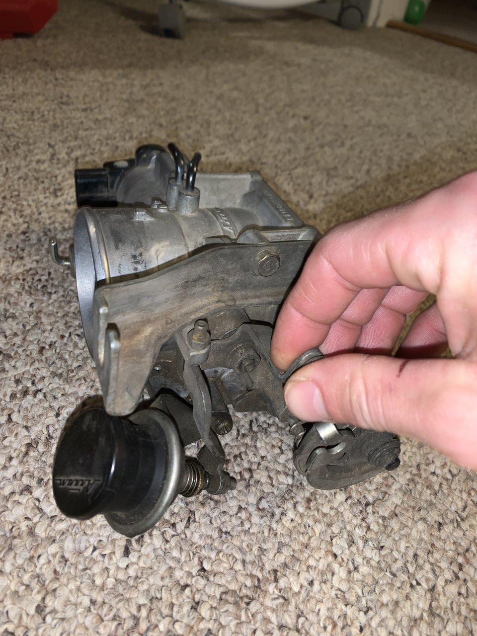

    And Id bet if you pull the shaft which the butterfly valve is attached to while your idling, the idle drops down doesn’t it?
    When you truck is warmed up go open the hood and pull toward to radiator on the piece that my fingers are on in the picture.
    now shim the butterfly shaft with a split washer to ‘pull’ the butterfly valve inside the throttle body, toward the front end. This is what I did to temporarily fix my high idle until I have the time to send to max bore, I’ve now driven 20,000 mile or so with this repair and i still idle at 700 when my engine is 185

    image.jpg This is where I placed the shim to prevent the butterfly from slipping back into the groove that was worn into the TB

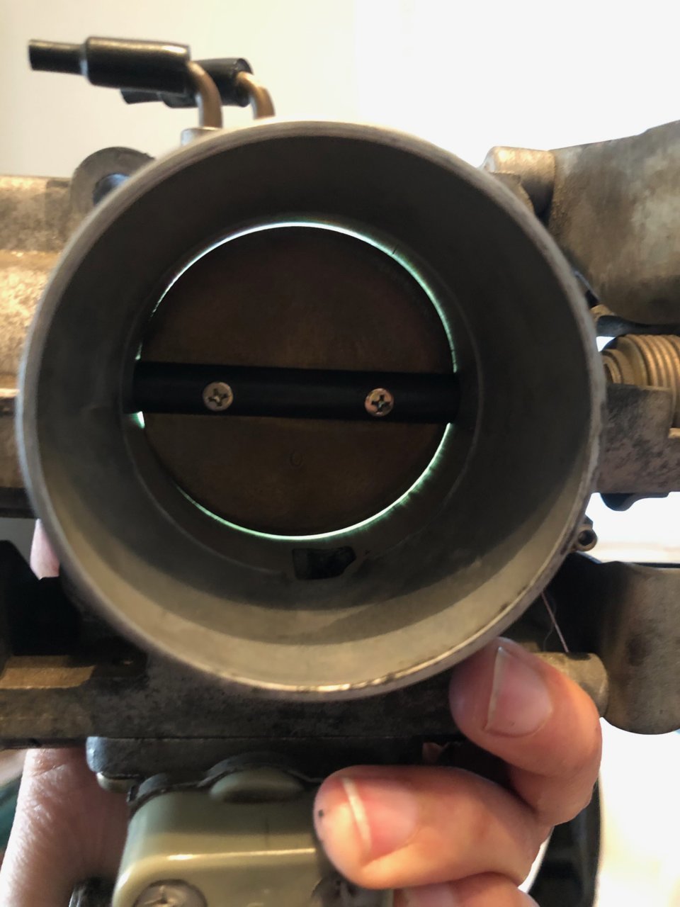

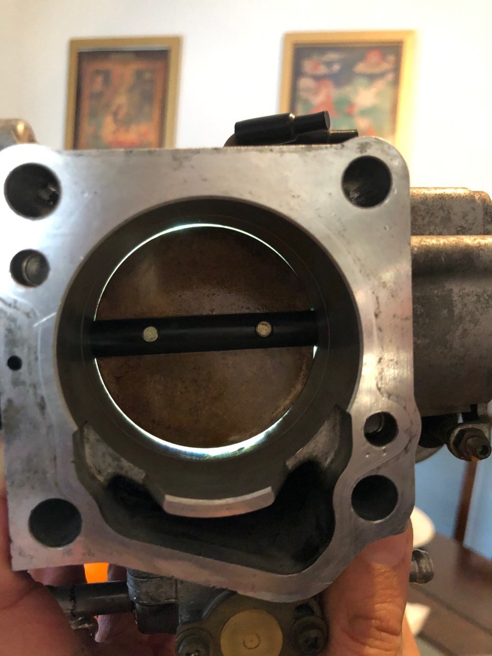

    Update: So, problem solved (mostly). I took your advice and ordered a cheapo IACV from Amazon. It actually had good reviews. Took off the throttle body and IAC, again. Sure enough, the throttle body bore had some light creeping through (pics below). ALSO though, I tested the old and the new iacvs with a jumper battery. The new iacv seemed to be opening and closing fine. The old junked up iacv that i had tried to clean up was not working. The little trap door would not open or close any further than the position it was in.
    So, hooray, I installed the cheapo iacv, and my idle in P/N went right down to abut 1050 (instead of 1900). It's weird tho, I'm wondering what happened to that old iacv - it seemed to be working fine before i cleaned it and the throttle body. I guess i gunked it up too bad while cleaning the TB to save it. Or, maybe it wasnt working right before and the high idle issue was being prevented by the TB gunk. Maybe the TB was so gunked up that the gunk-ring was helping seal off that extra air from getting in?
    Now, my idle is not quite right because of the bore wear, but it's a heck of a lot better with the new iacv. I can live with it and with the cheapo iacv until I decide to throw down the $400 on a new TB assembly.
