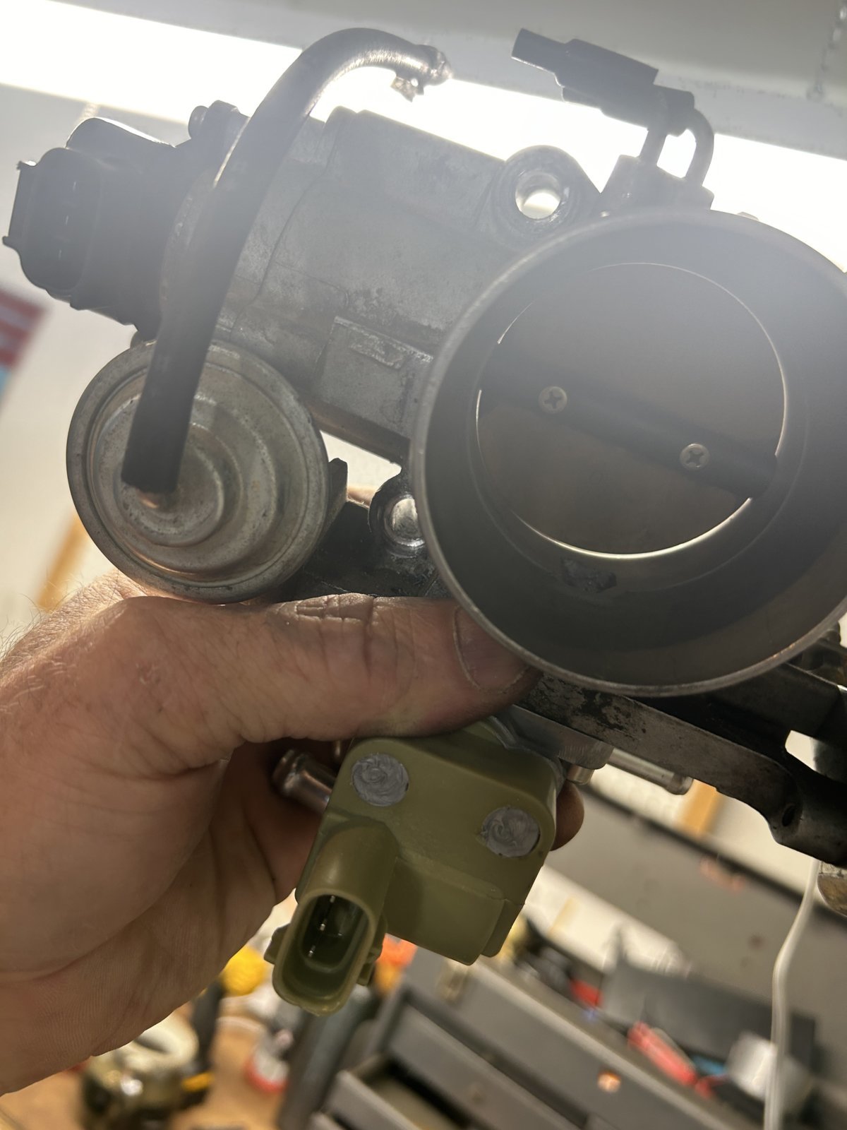

    another update...I replaced the throttle body gaskets (cuz I have throttle body spacer). Got a whistling sound but the idle was lower. Redid the gasket, no whistle but the idle is back up. I replaced the IAC valve and nothing changed. Still a high idle at about 2000 rpm. When I press on the dash pot plunger the idle drops. I took a pic of the intake. Kinda looks like a large gap around the butterfly valve. Do I need a reboring or a new throttle body?

    I was at 1800 idle, added throttle body gaskets and could hear a hissing, but idle dropped to 1000. Sprayed brake cleaner around TB and revs went up. Redid the TB gasket, now no hissing but the idle is at 1800 again. If I force the throttle closed with the dash pot mechanism the idle drops to 900. I'll try to include the pic of the gap around the throttle plate. It's big.

    That gap could definitely be the cause of your high idle. Maxbore would have fixed that right up.

    So the dash pot plunger should be held IN by vacuum pressure at idle when at op temp, fully warmed up. If it isn’t then you have a vac leak somewhere still. Also, if that picture was taken with the dash pot unhooked and plunger out then it’s gonna show daylight there. I read all over here about the need for the butterfly to be completely closed on the throttle body. Guess what, on my 2.7 there is daylight around it and it idles at 700rpm perfectly once I fixed vac leaks, cleaned intake, replaced faulty IAC etc. The point is, fix the other stuff before you start messing with the throttle body.
