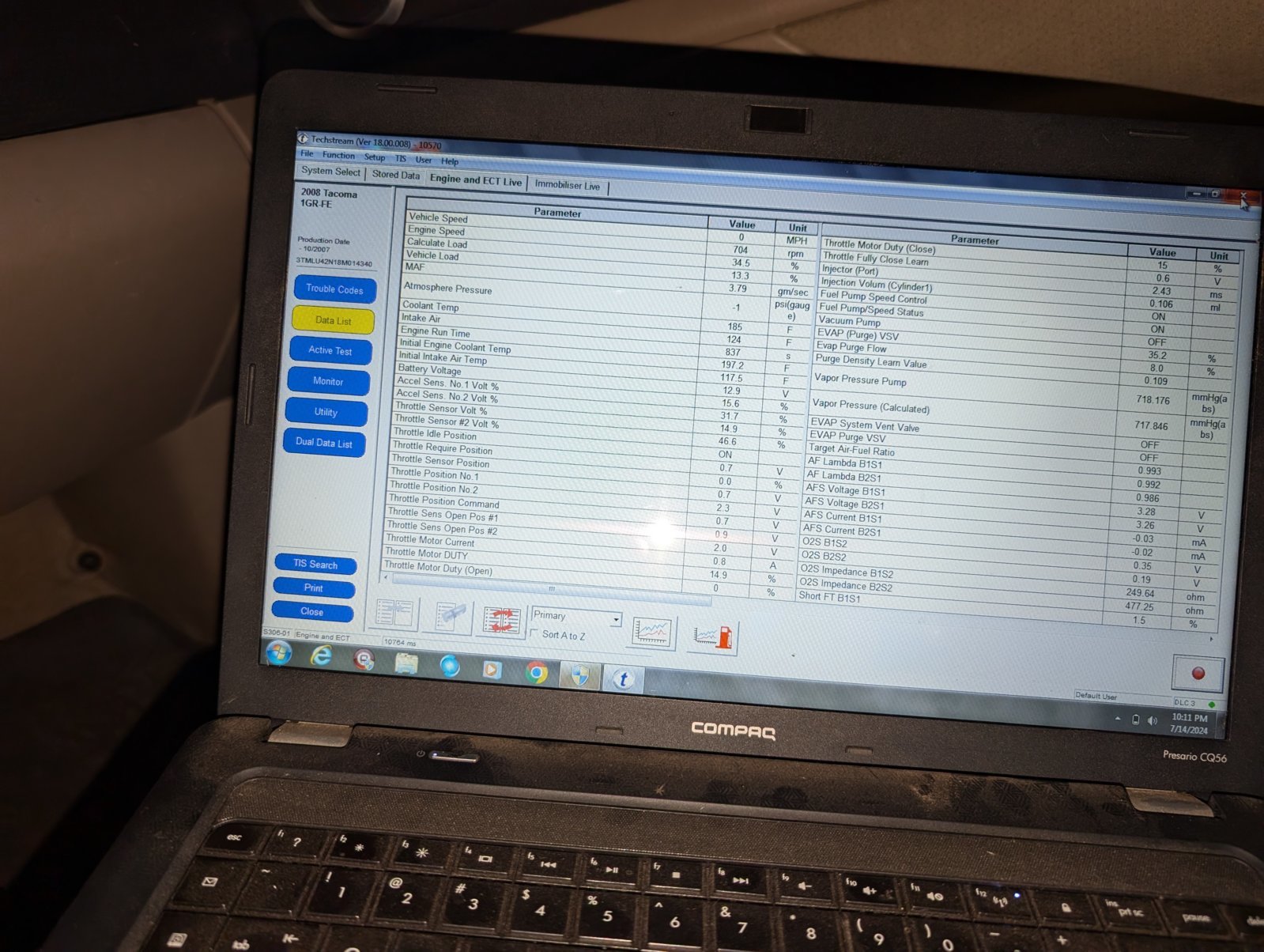

    Can somebody check out this snapshot from TechStream and tell me if it looks normal? If somebody could tell me what all the readings mean, that would be even better!
    I feel like my 08 4.0L 4x4 Auto idles too high, even after it's fully warmed up.
    A cold start goes to an immediate 2k rpm which gradually slows to about 800rpm hot idle with everything off in neutral
    When it's cold, I have to plant my foot on the brake or it will take off and after it's warmed up, I feel like the engine tries to push me through stoplights while I'm slowing down.

    Those aren't too far off, unfortunately Toyota doesn't give desired idle speed only desired throttle position which appears it's where it wants it.
    You might want to check the PS SW PID and see if it is on, I remember someone had an unsolveable high idle on one of these and it was a stuck power steering pressure switch.

    My hot idle is about 650.
    Yours says 700 in the PID.
    I'm going off the tach in the truck. Never checked it off the PID.
    But do as Dm93 said, check the PS switch.

    I "think" my load wasn't as high as yours, best I can remember.
    34% seems high?

    I was just comparing that to the chart posted above.
    It looks like 11-16 is normal range. @Dm93 thanks for that.

    I would expect it to be setting a P0505 (Idle Control Malfunction) if the actual and desired idle speed was off more than about 200 RPM.
    Typically the only things that cause a high idle are vacuum leaks (but you would see high fuel trims on a MAF engine like the 4.0) or an input causing the PCM to bump the idle up.

    Does it seem unusual to you that the throttle commanded position and fully closed learned position are so close?
    What do you think about it still having a gap when commanded closed or the high engine load?

    I'm assuming that was done KOEO?
    Was that screenshot taken in Park?

    Key on engine off and accelerator depressed are the two requirements to run the test. With the key off, the throttle can be pushed closed until there is no gap. It went to the same .7v with a gap when commanded closed during the test.
    I was pretty rough when I cleaned it and I opened it way past 90 degrees. I'm wondering if I over traveled one of the sensors.
    I don't remember now that I think about it. It was late and it was dark so I probably had electrical load from the headlights. I'll recheck tomorrow.

    I just double checked. My "Calculate Load" is 34% in park with everything off and fully warmed up. It's 39% idling in gear. I'm going to try idling it without the belt on and see what happens.

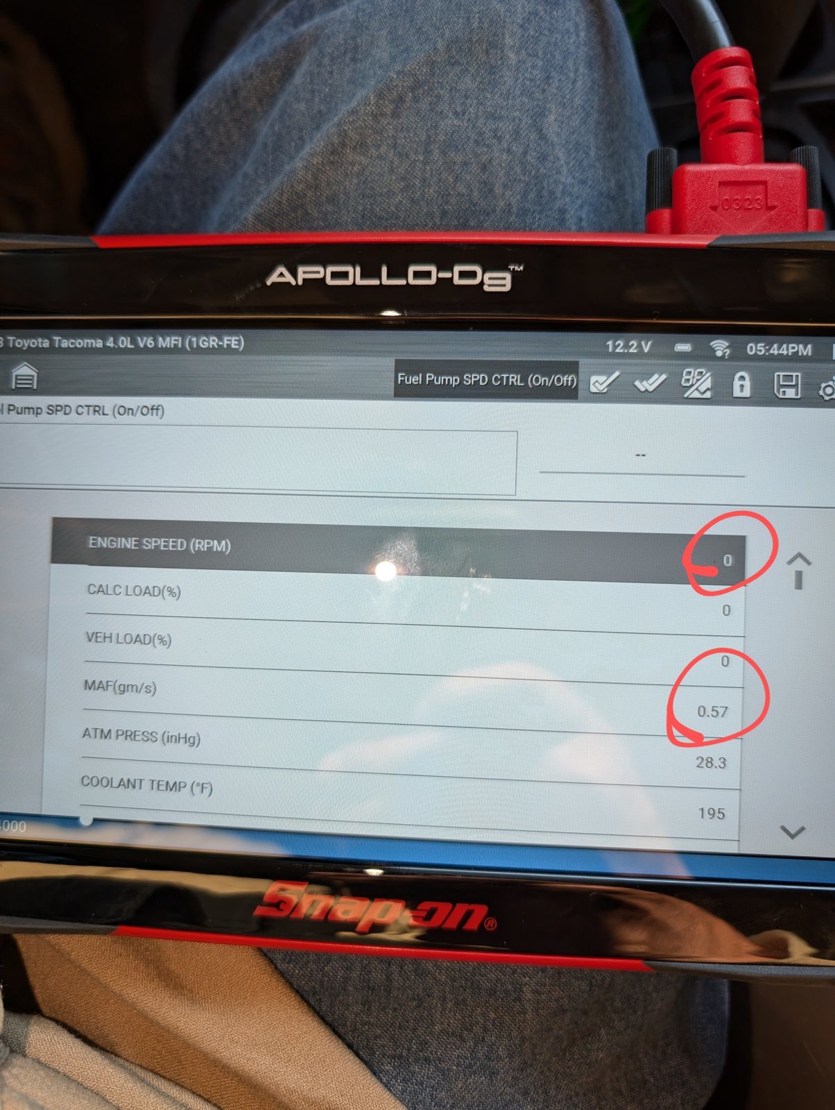

    Does this seem normal? KOEO and the maf is reading .57 gm/s.

    It's plausible, I wouldn't be too concerned about it.
    In any case any slight error in MAF reading would be corrected by fuel trims, it wouldn't cause a high idle.
