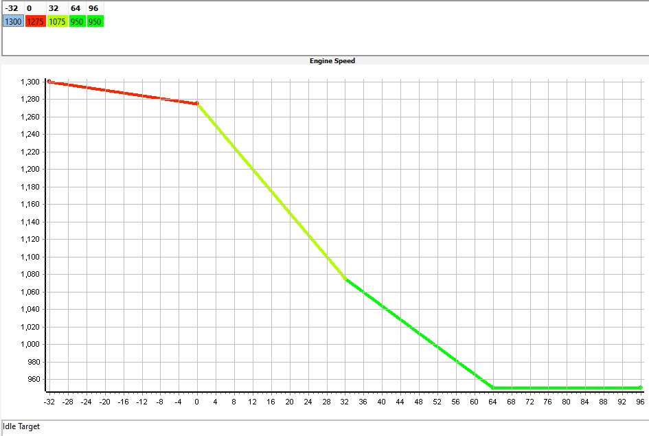

    That is not normal. The first tick mark is about 140F coolant temp, it should be settled into normal idle by then:
