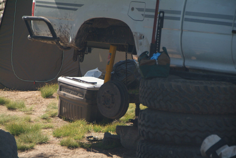

    I had to work under my 5K lbs skid steer with the tires off to fix some hydraulic lines and a leaky seal. Even with 8x8 blocks under each corner, I had a difficult time convincing myself it was safe. Did the shake test, let it stand a few days, shake again (it was solid). Finally got it done, but the thought of all the weight was always on my mind.

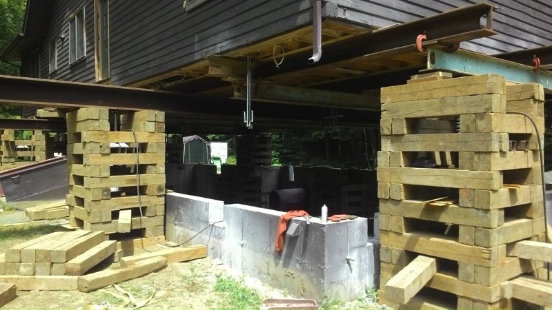

    That's some interesting cribbing there. When on ground, you can help distribute the weight of the blocking, and add stability, by using longer 2 bys perpendicular to the blocking, or a bigger piece of heavy plywood (3/4) as a platform or base. I would also criss cross the blocking to add stability. It takes more blocking, but it's more secure.

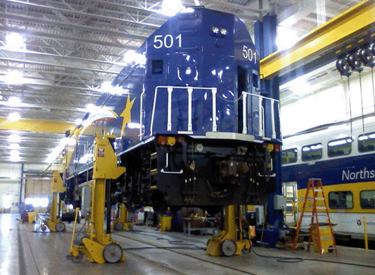

    I love having 12 ton jack stands for working on our trucks, tall, wide, substantial. Yes please. I've always wanted to ask a locomotive mechanic about this. It's got to be something you don't think about.

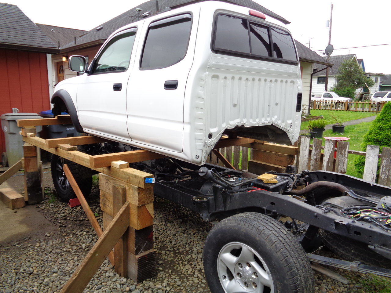

    I grew up in the "hills" of CA, and you could walk into any auto parts store and buy 12 ton/28" jack stands. 33's were considered small. Now, living in Sacramento, they are nowhere to be found except harbor freight. I got some 6 ton ones recently and they are more than enough to reach most of the frame with wheels on.
    For picking up the rear, I always jack using the pumpkin, remove the wheels and lower onto the frame with the 6 tons and paver stones if I'm doing suspension, or to the pair of 3 ton stands I have.
    For the front, I usually will jack form either one of the LCA or more typically the cross member, and always put the stands on the frame and close to the suspension as possible.

    Please don't use pavers, bricks, cinder blocks, etc. for vehicle support. They can shatter without warning. It's much safer to use wood cribbing. Particularly under jack stands that are concentrating the weight onto a smaller surface area. I have a bunch of 2x4 and 4x4 for that.
    Yup. All that looks fine to support the weight but those corners are probably not as stable as they could be. Picture how home movers do it.

    Also second the "home mover" method. My description above may not be clear, but running two blocks one way, then two blocks perpendicular on the next course, until you are at your desired height. Would be better if I had a picture.
    I use a lot of PT 4x4 (or 6x6) for cribbing, but as a timber framer, I have lots of larger dimension cut offs which work very well. I do have jack stands, but they are not great ones, and I will only use them on concrete. Besides, I have all those blocks... But the downside of blocks is that you have less room to work, and many times they can interfere with what you are doing. So placement is important.
