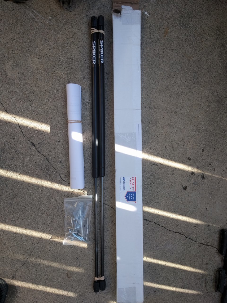

    1) Packaging and Tool Prepping:
    So, when Spiker Engineering shipped me the kit, which was fast and extremely well packaged with tracker provided, I emptied the contents of the box and unfolded the instruction sheets noticing a components inventory check list of what is included with the kit. Reading a bit further, tools needed for the install. I inspected the gas strut assemblies as well as the ball stud mounting brackets. You will find that the construction of these gas struts and the ball stud mount brackets are very sturdy looking and feeling. In short, a very professional looking kit for sure that, once installed, you will be proud to show off.

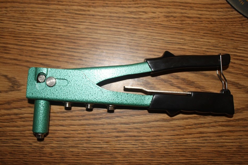

    As for the install, a basic hand rivet gun, razor blade, electrical tape, a ratchet type load bar, right angle power drill (will discuss this further), basic tool set (i.e. screwdrivers, ratchet socket set, etc), a sharpie, and a drill bit set. I also found it helpful to have digital caliper, but definitely NOT necessary.

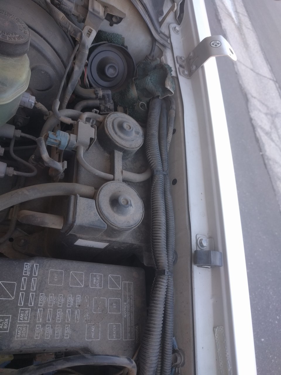

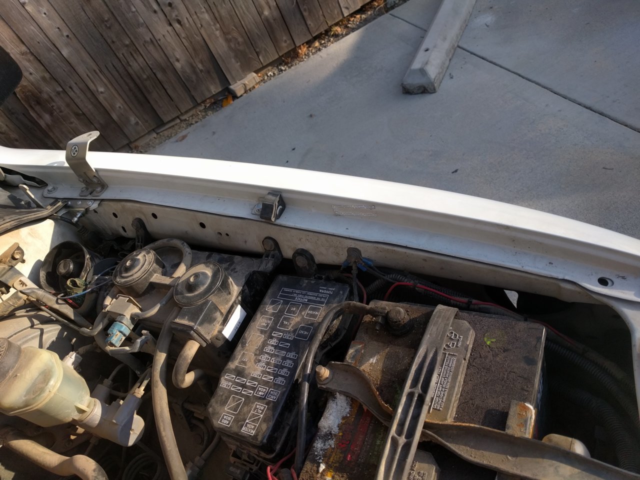

    I did the driver-side first taking notice that my custom wire harness I did a few years back for my KC Lights, fog lights, etc were likely going to be in the way and from the looks of it, it looked as if there just might be just enough room, but rubbing was still going to take place for sure. I simply took the time to relocate my custom wire harness.
    I moved and partially re-wired my harness. It was not really all that hard to do, but just that alone took a few hours. Since I could only realistically do this after work, the amount of daylight hours were highly limited for me so I had to work on it across a couple days. In the end, the wire harness ended up looking really clean. NOTE: you will notice the ball mount bracket already installed in the picture because I took this picture after the fact just to show how much more room there was after my wire harness relocation.

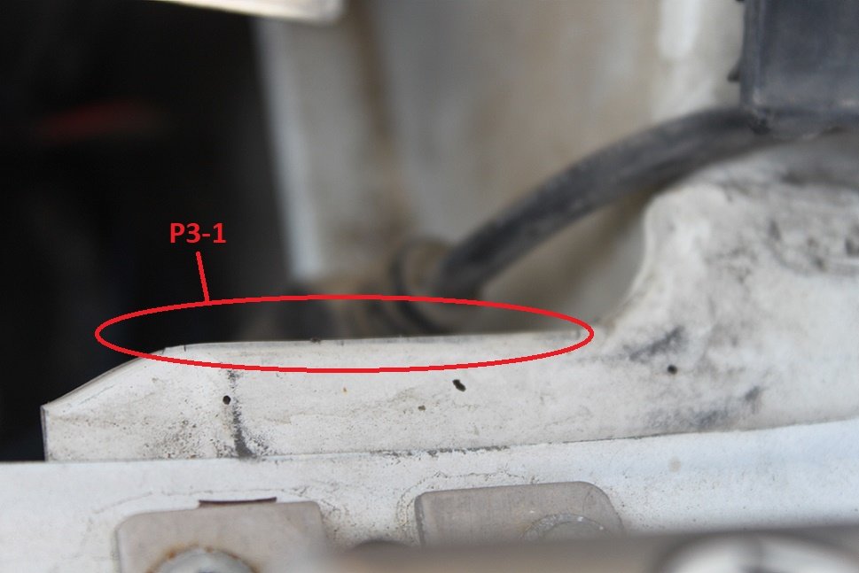

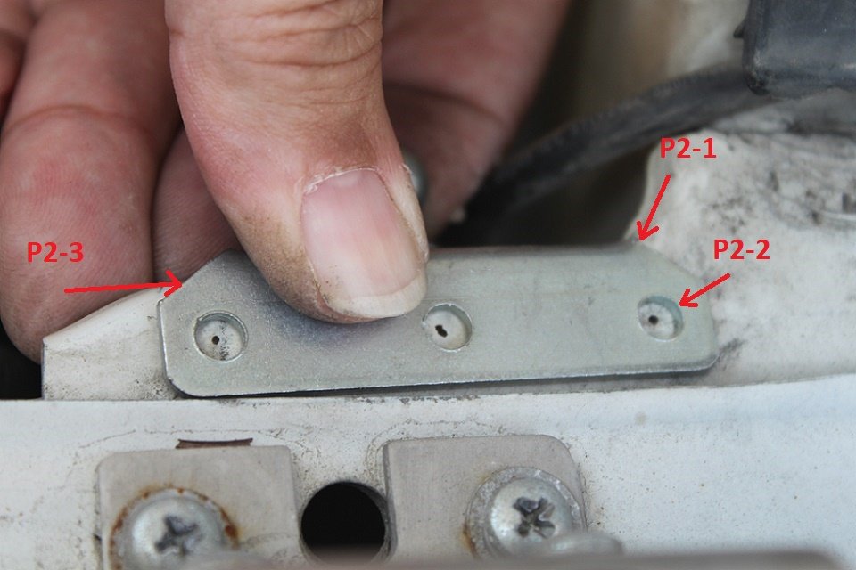

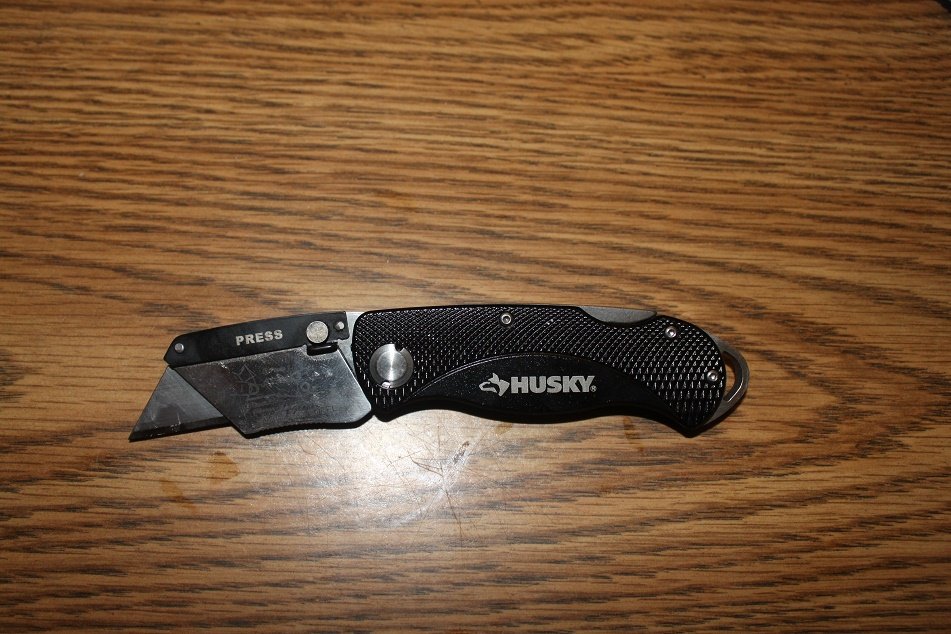

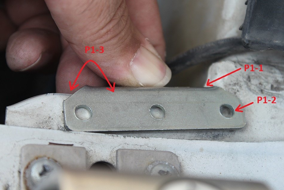

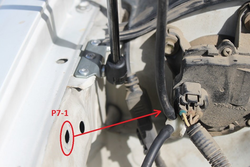

    I took a razor blade (NOTE: the sharper the better) to cut away the excess body filler. Cutting it was easier than I thought. I pressed the bottom ball mount bracket up against the edge noticing that if the bracket was moved too far back, the curvature of the paneling would start to raise/skew the bracket and make it cockeyed not fully letting it sit flat and flush properly (see locations P1-1, P1-3, P1-2 in the picture just below). I moved the bracket forward just enough until I could feel it seat/flatten properly.
    Notice how much more flat the bracket sits (see P2-1, P2-2, P2-3). At this point, I took a sharpie to mark the hole centers.
    I had already cut the filler, but take notice on how "flat" it is (see the location marked P3-1 in the picture below). This is what you want so that the bracket will rest against the metal edge as much as possible. Also take note of the curvature towards the back. For mine, I moved the bracket forward until it sat flat/flush against the sheet-metal. Then start drilling your holes at the marked points. I would start drilling a little bit and then check how the hole placement would look before completely drilling through the sheet-metal. NOTE: This is important because you do NOT want the holes off-center as much as possible!!!
    This was the razor cutter I used to cut away the excess body filler. The blade handle made the cut very clean and easy to do.

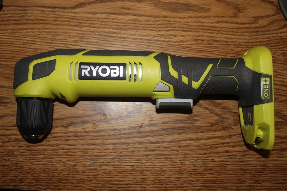

    Keep in mind that at the hood hinge, you will need a fairly small length drill body to clear the hood so you can drill the holes!!! I found that a right-angle drill worked well OR one could simply use a smaller drill body, which I did not have a smaller drill body to clear the hood hinge area. I personally liked the right-angle better anyways.
    A hand rivet gun, like what you see, worked very well. I'd get something similar to the right angle head just like the rivet tool you see in the picture. For me, I was able to control the "pressure" each time the handles fed the rivet into the gun. Just make sure to keep a constant even pressure against the surface/pieces you are riveting together.
    I drilled, riveted, and installed this end of the gas strut tube to get the next point to be drilled... the hood ball mount bracket. Raise the gas strut until it reaches the highest point possible on the hood.

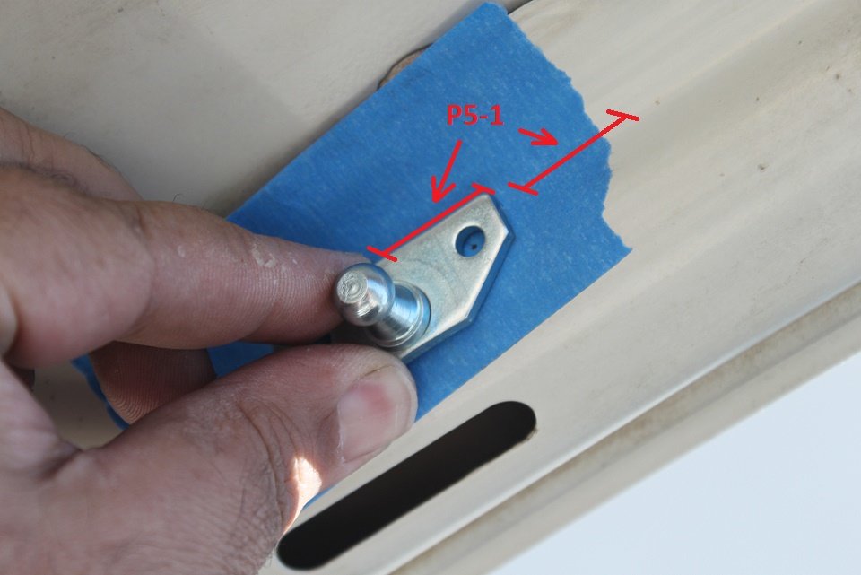

    The correct way to install this bracket is how you see it here. Those flat RED lines simply show the "curvature" part of the hood-brace and I simply made the bracket flush against the curvature and as flat as possible (see the picture below marked location P5-1). NOTE: before drilling the hood holes, make SURE to wrap about 10-15 layers of electrical tape roughly 3/4in away from the tip of the bit. This way, if the drill happens to "grab" the sheet-metal while drilling, it doesn't punch a hole through your hood!!! Mark your holes with a sharpie.
    The picture below shows how it should look when finally assembled on the hood end.

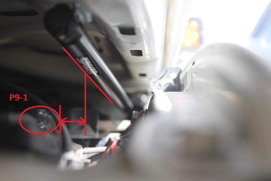

    The picture below, is to show how much clearance there is from the negative battery post to the gas strut on the driver side. I'm estimating a clearance of at least an inch or more, for sure. If your body is flexing THAT much, then you have more things to worry about (see the picture below marked P9-1). When you close the hood, the gas strut tubing is approximately this distance from the negative battery post as well as the battery body. In short, I firmly believe that there is quite the clearance and nothing to worry about. As you can see though, if I didn't relocate my wire harness, it would have been pretty cramped and maybe even damage the gas strut, the wire harness, or both. So, I simply took the time to do it right as much as possible. :thumbsup:

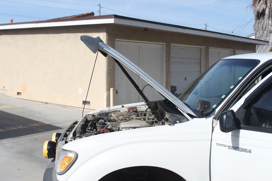

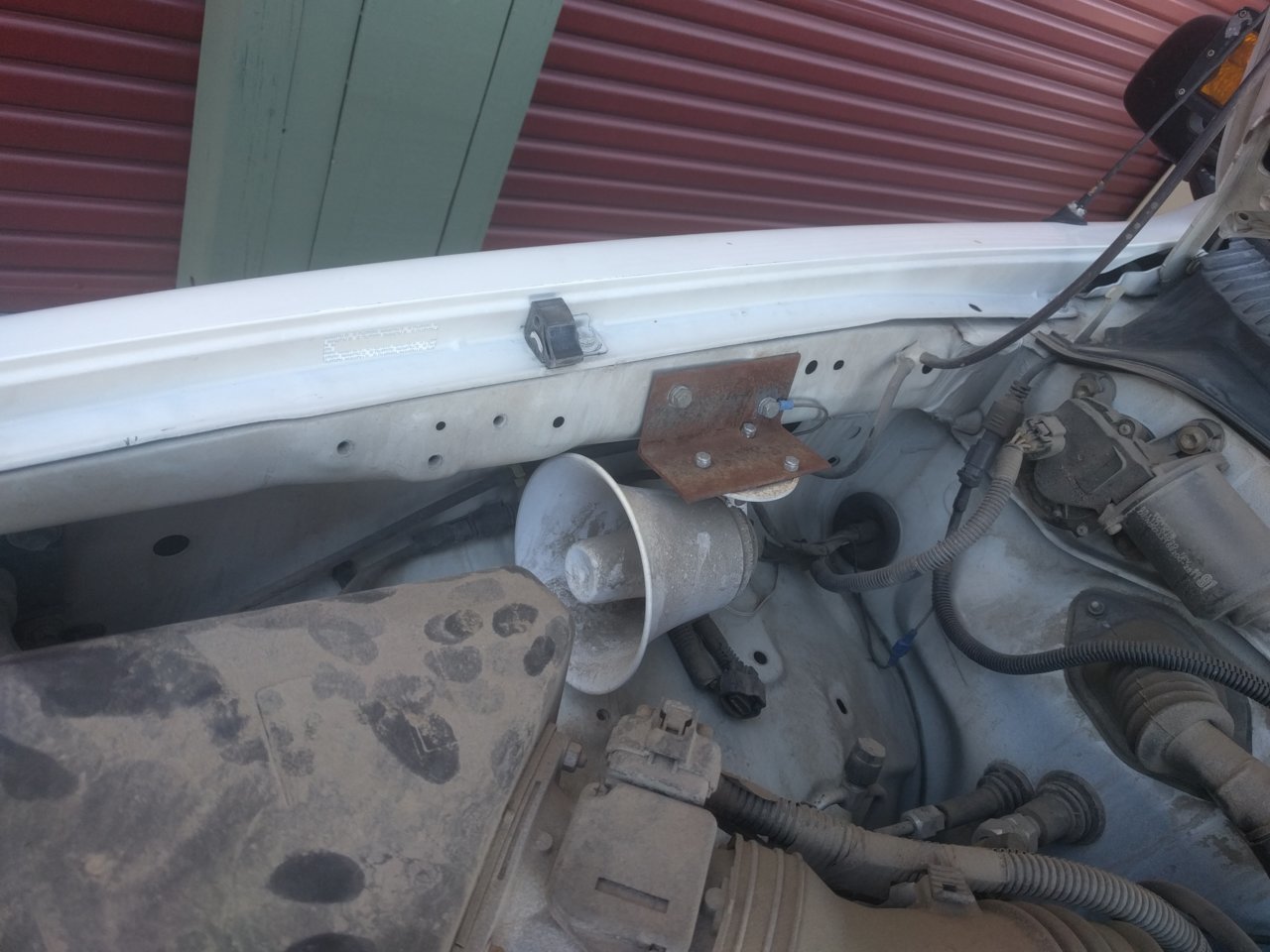

    Okay, now for the passenger-side, I have my PA Horn that is connected to my CB on that side of the truck and I have future plans to put other "items" in that general area. So looking at it ahead of time and making sure that the hood-strut tube has plenty of clearance taking notice that, just like the video and instruction sheets, the window washer tube needed to be relocated, which was NOT a big deal to do. The clip can be a bit of a PITA to disengage, but it is definitely doable.
    Here is the passenger-side window washer tube. Just pop it out and moved it over to this spot for now (see location P7-1 in the picture). I will likely move it again to make it look a little bit of a "cleaner look", but as you can see, I have LOTS of DUST in my engine bay!!! :D:mudding: "Don't judge me..." :crapstorm: As you can see, the bottom mount has been installed at this point. Basically the same procedure.

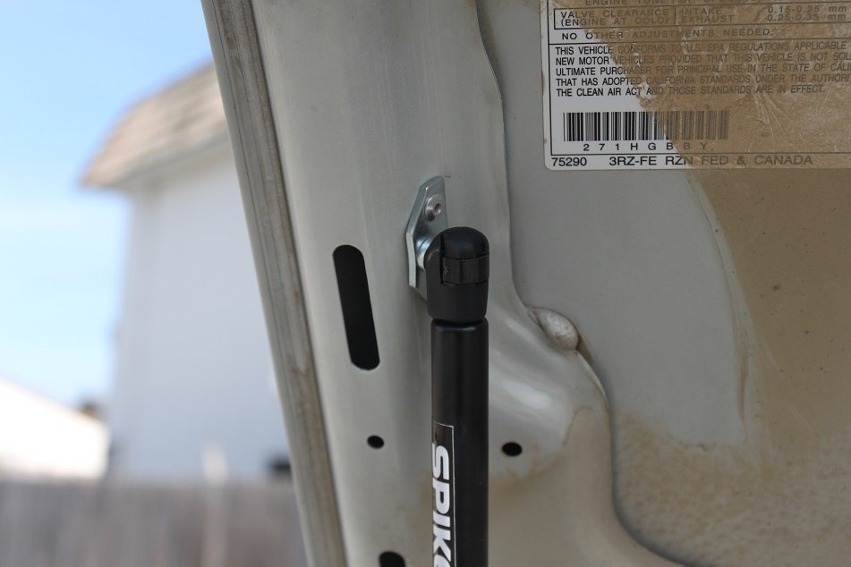

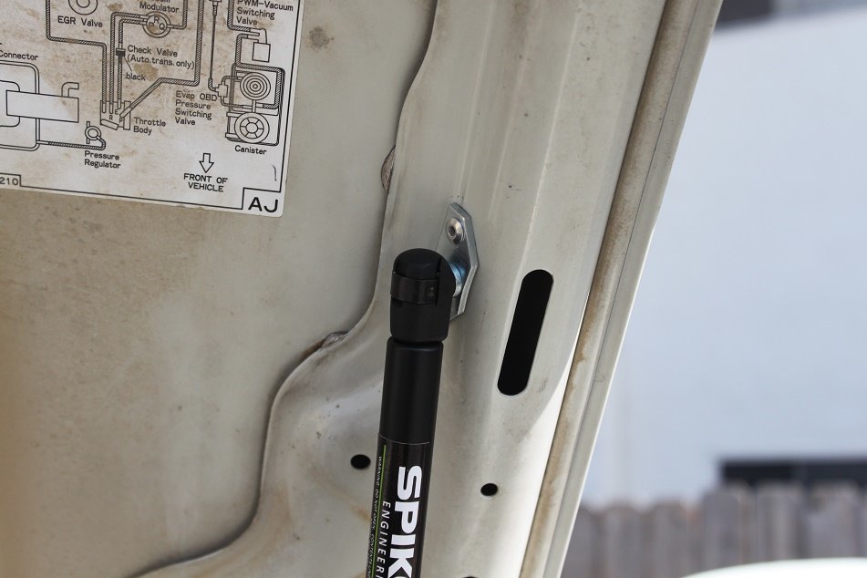

    This is the top passenger-side hood strut.

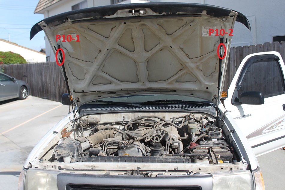

    I had originally installed one of the gas struts and noticed that the label/sticker was facing "inwards" and didn't like how it was going to look. I wanted it to look as "professional" as possible and have the manufacture labels facing "outwards" to give it a "cleaner look" to show off and people will notice the label quicker that way of who the struts are sold by!!! :thumbsup: Notice how the labels face outwards at locations P10-1 and P10-2 annotated in the picture. :thumbsup::fistbump:

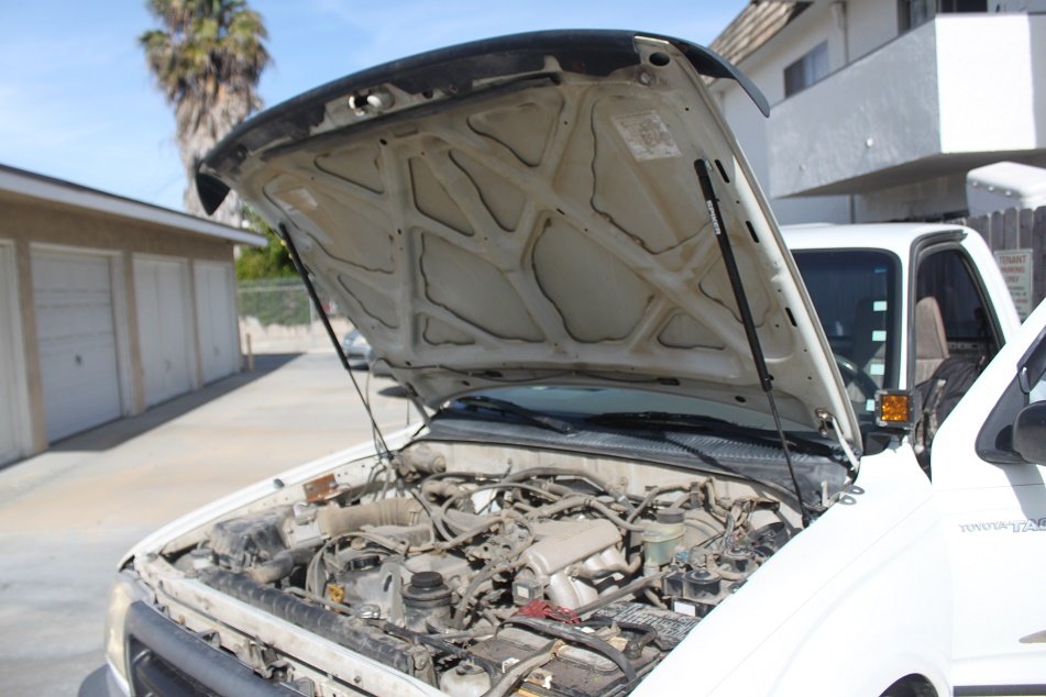

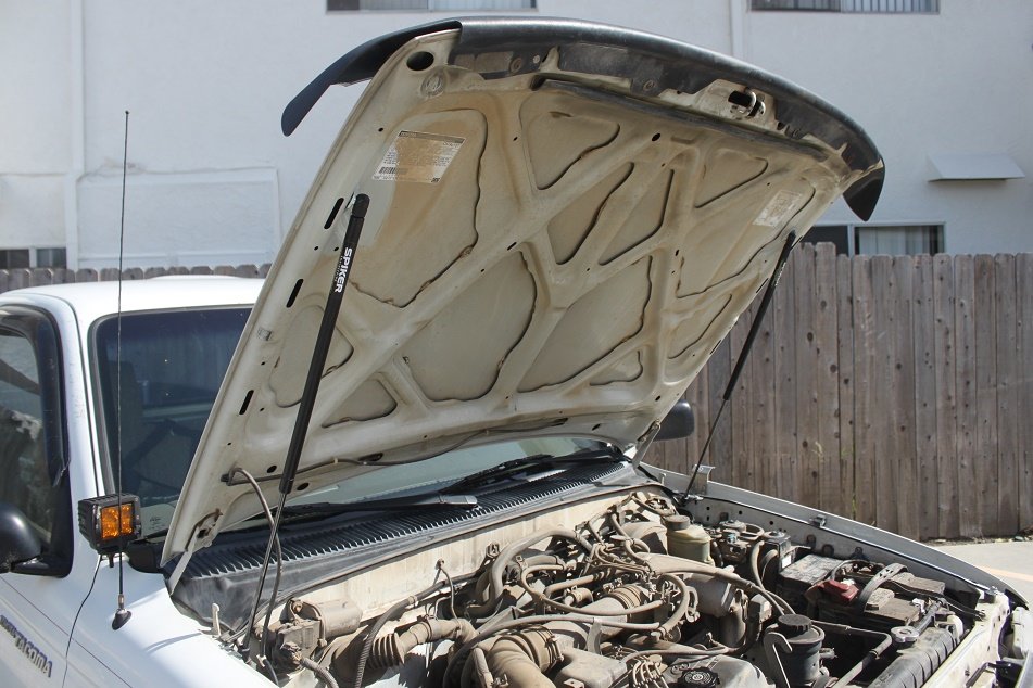

    The two pictures below are just showing the left and right-sides with the hood open.
    Before... btw, take notice of the factory hood brace. IF, that is, IF one wanted to for whatever reason, you can still use your factory hood brace!!!
    After... notice that there is no factory hood brace AND there is much MORE work area that opened up along with the fact that the factory hood brace is not in the way. This is max hood lift, which is what I was aiming for!!! :thumbsup::fistbump::cheers:

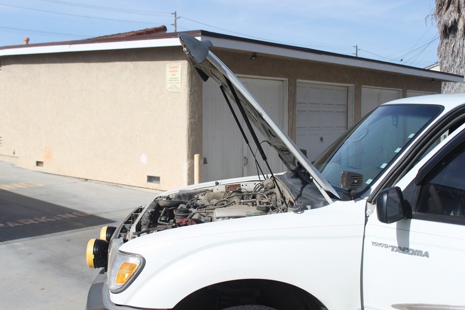

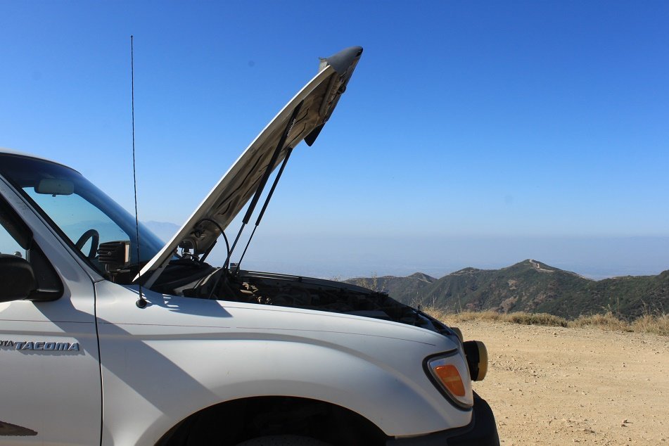

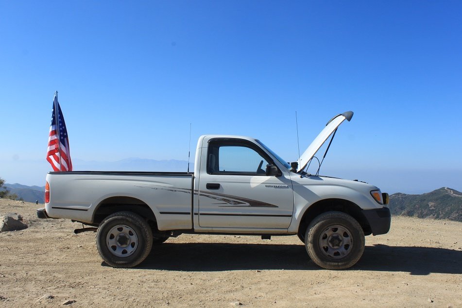

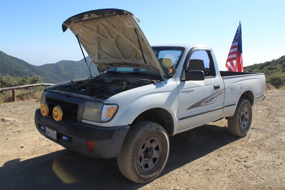

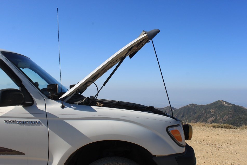

    Below, this is on 4 July 2019 up at the "Parking Lot" halfway up Santiago Peak here in Orange County, California. I wanted to get some "scenic shots" and decided to check out my hood struts to see if they took some off-roading abuse. The trail is a fire-road type trail, but there are quite a few sections that still "contort" your vehicle and bouncing around for sure depending on how fast you are traveling. The struts held up just fine (closed of course :rolleyes:). I have since been up on that trail a couple more times and still in good working order. I have another off-road trip coming up with SOME "rock crawling" involved (i.e. definitely not your fire-road type trail). NOTHING too intense, but a medium trail with a decent boulder field nonetheless.
    Anyways, here are the pictures taken on 4 July 2019.
    Again, just showing the factory hood strut holding the hood up...
    And just the gas struts holding the hood up...
