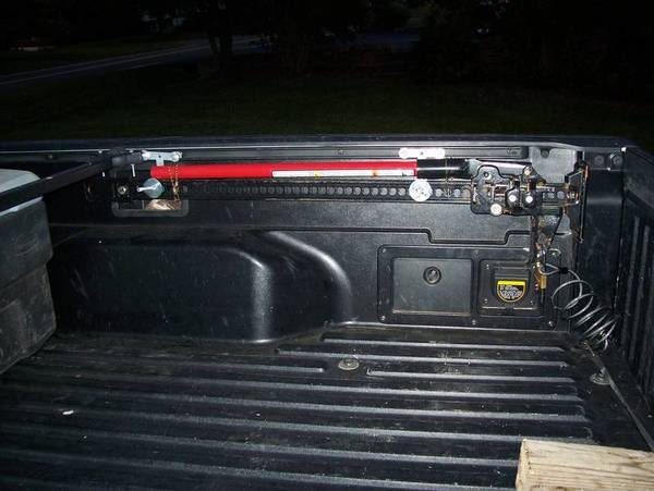

    As most of you have seen my high lift jack & mount, I have a issue now. I had to remove my cover for hunting purposes, and now I need to come up with some sort of locking system.
    I want to lock the jack to the truck itself, and after looking at it I can't come up with anything. I have 4 days before I leave, so a mod is do-able if need be.
    Think about it and let me know, a pic would be great also if you have any.
    Thanks...

    I have a cable lock onto the tie down.

    bad thing mine is mounted in the front and I don't have the D-rings in the front.....yet.
    But I like the way you did it :)

    Thanks, it was the best I could think of at the time, and cheap:rolleyes:

    How is this
    install a rivet nut (pic below) above and below the main upright of the jack. Install a eye bolts into each rivet nut and run a hitch pin lock thru both eye bolts.
    The best I could think of on short notice. I hope it makes sense

    How strong is that with the composite bed?

    thats what the bed tracks are mounted with, they would be sure I'd say. It's mostly a deterrant anyway, if they want it they'll take it right?
