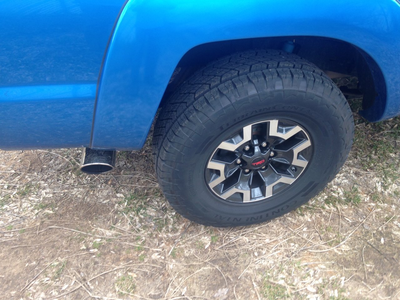

  7. Jan 30, 2020 at 4:50 PM
    xaircav
    xaircav Well-Known Member
    Jul 5, 2018
    #258433
    397
    Bill
    Wheat Ridge, CO
    '10 TRD Access Cab 6 speed manual
    TRD intake, skid plate, cat back exhaust and short throw shifter. Bilstein 5100 leveling front and 5100 shocks rear. 32” Falken WP AT4W tires on Gen 3 wheels.
    If you have 265/70/16 (31” tall) go up to 265/75/16 (32” tall). You won’t need a lift, there will be no rubbing and 65 MPH on the speedometer will be 67 actual.195AF835-D564-4469-AAE7-831629A5208F.jpg
