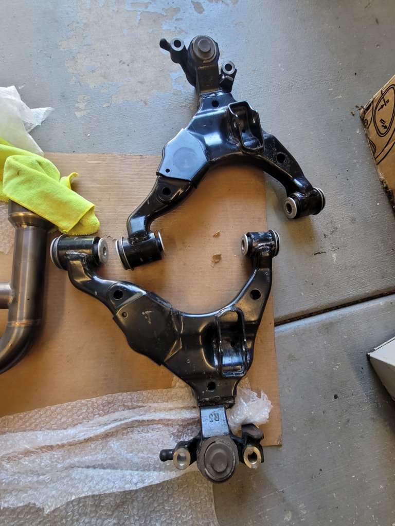

    the more i work on this truck the more i have come to hate that for whatever reason, you always need to set aside an extra 200 for random small things that needs to be replaced. thanks for all the help finding the parts i would have been stuck wondering why those cams didnt work.
  12. Mar 16, 2025 at 11:50 AM
    95 SR5
    95 SR5 [OP] Member
    Feb 2, 2024
    #443017

    I just searched around a bit and the SPC 25425 might be the only bolt on option. I can’t say for sure they will fit, but from what ive seen they should. The SPC fitment filter does not seem trustworthy as they are calling a ‘94 Pickup a Tacoma, so I have no idea what they mean by ‘95 Tacoma since that could be a Pickup or Tacoma. I can’t say for sure whether the cams are the same between a 95 pickup and a 95.5 Tacoma. I’ve heard OEM holds alignment much better, but if you don’t have an option then that’s what you have to go with. You might get lucky and get all the OEM hardware out clean and able to reuse it as well, but that seems pretty rare even for rust free trucks.
    I know a guy working on cam delete plates for 95.5s, but they’re not really a direct competitor for OEM style cams. You lose a lot of fine tuning in your alignment, but they can’t slip out of alignment off-road.
    The last option would be to cut and grind off the OEM cam tabs and weld on tabs made for octagonal cam plates. One company I know of for this is KPOffroad. If you are able to do this yourself it wouldn’t cost much more than SPC and still a lot less than OEM parts would be, but if you have to pay someone it would probably be pretty expensive labor. Still lose some fine tuning in the alignment this way as well.
