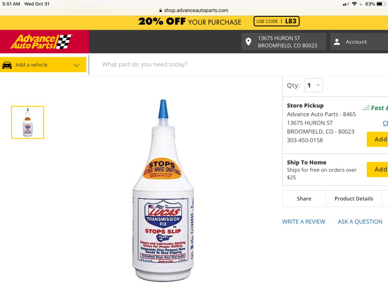

    I have a Chevy Tahoe with 375,000 miles on it. I have the oil changed every 100,000.
    I had a transmission flush at 300,000 and after that the transmission started to slip.
    Sometimes it was really bad and other times just a small slip.
    I added Lucas transmission slip conditioner and the slipping went away.
    That was 75,000 miles ago.
    The Lucas conditioner thickens the oil up and fixed my issues.
    It’s worth a try if the transmission is slipping a little and you have been taking care of
    the transmission before with oil changes.
