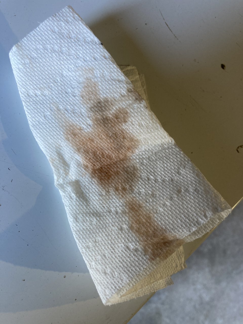

    Finally got around to uploading this. This is at about 275k miles after draining and filling twice since 246k. At 246k, the fluid was black.
