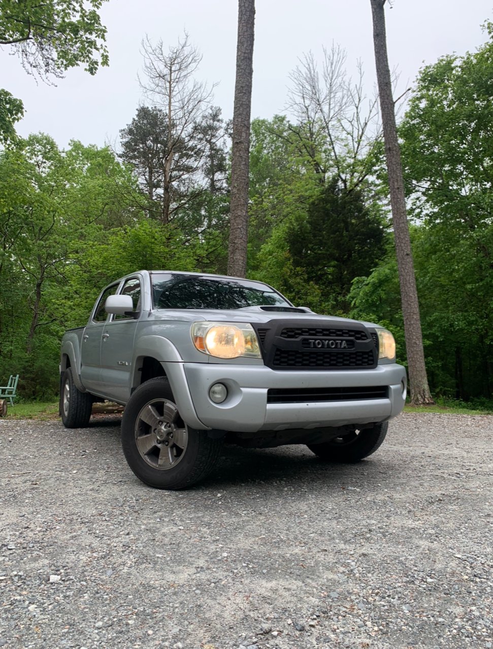

    I've been good about my other maintenance, my diff, oil, power steering, coolant, etc. The only reason the transmission has not been serviced is due to my dad thinking that a sealed transmission doesn't need service. I need to do a few things to mine; The steering wheel is not aligned, it's been like that for the last 10 or so years, though there's no abnormal wear on the tires or suspension. I do need new tires, the ones I have now are warn. I got the leaf springs replaced under warranty, and that brought to me that I need new rear shocks, and at that point I'll get new shocks on all four sides, as they're the original shocks. I need to bleed my brakes, and replace the pads and rotors, as my brake pedal is soft, still safe just annoying, the pads just hit the wear tabs and started squeaking about a month ago, and the rotors are slightly warped. I also want to mod it because I mountain bike and would love to have a mean looking taco to bring anywhere to ride. I have a 3rd gen style grill on it right now, which I'm not a fan of the look of and want to get an OEM style grill. I'll post a picture of how it looks right now. I would like to get a 3 inch lift and I'll probably run some 32's, but I'm going to save up for a little while. I would like to get a cold air intake from K&N, as well as an X-Pipe or H-Pipe exhaust, which I need to research to find a good one I like, I may post another thread about it. I'd also like to get some new headlights and taillights, I need to do some research on those, I think I'll probably get some projectors for it.
