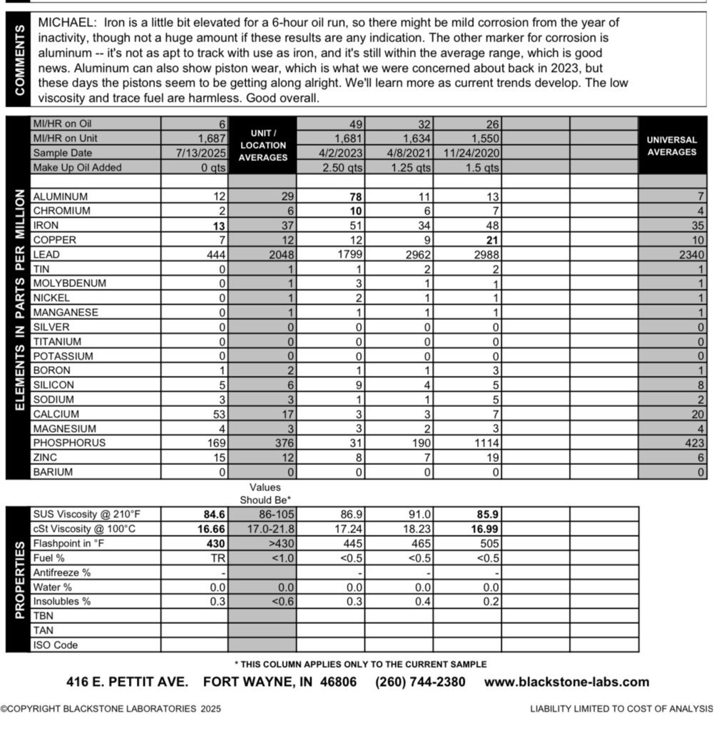

    I pull oil samples every oil change and the engine has no issues. Doesn’t burn any oil at all.
