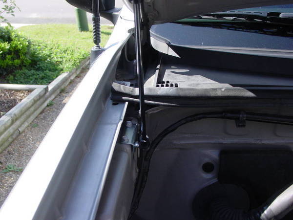

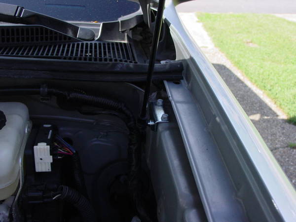

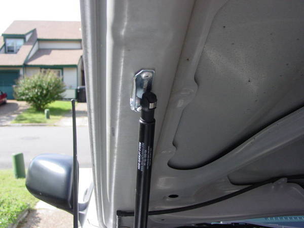

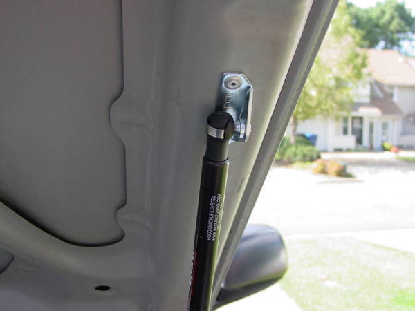

    Quick update, I installed some redline tuning hood struts. These things are awesome! The instructions were great, and it only took about 20 mins to install.

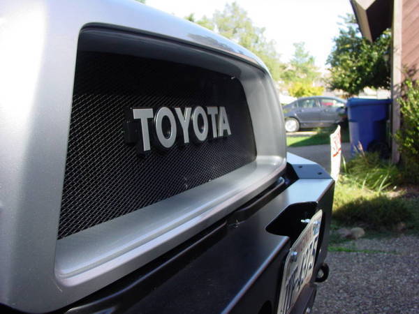

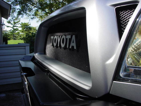

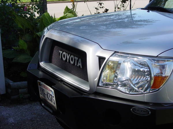

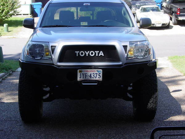

    I just finished my satoshi, what a pain in the ass! But it's worth it, I love the way it looks.

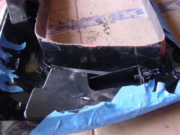

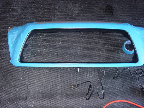

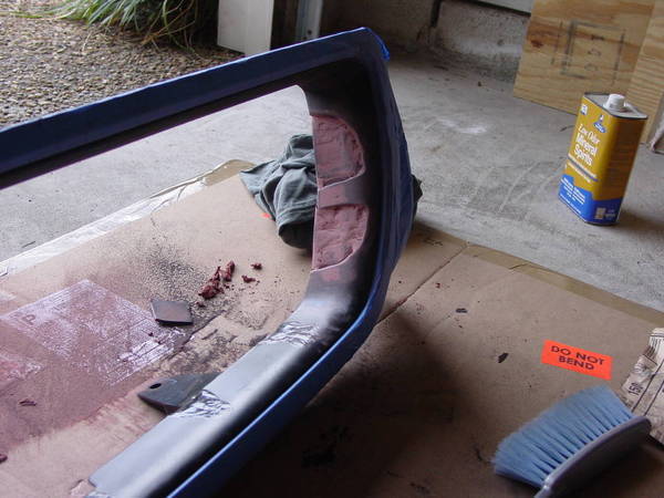

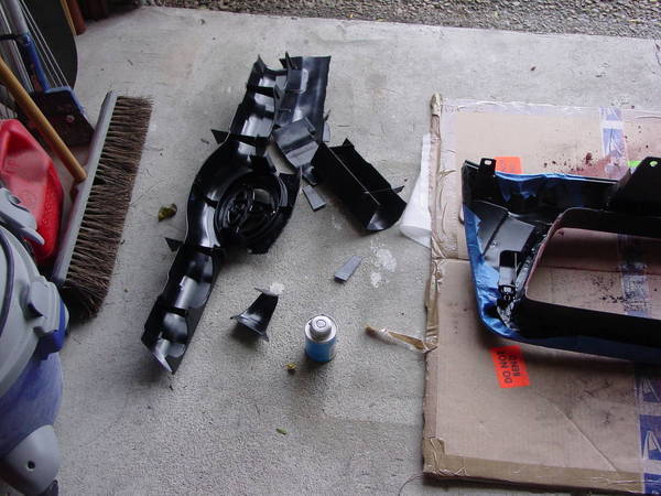

    Here is the grill after the center piece was cut out.
    I used the center piece to make some backers for the cut parts, just like in the All ABS thread.
    I heated them in a toaster oven, and molded them to the right shape. Then I glued them in place with ABS Cement.

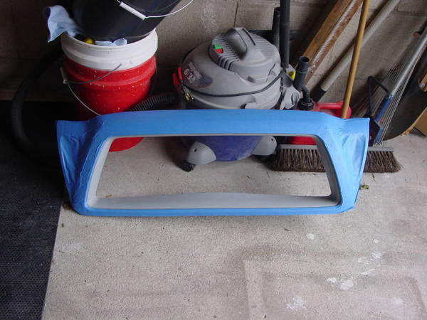

    Then I filled the spots in with Bondo, and did a lot of sanding.
    Once that was done, I did about 4 coats of filler primer. Sanded that down. Then I did three coats of adhesion promoter, 4 coats of color match spray paint, and three coats of Clear coat. I Buffed it out, and waxed it. Then mounted the grill.

    Looks awesome!!
    What mesh did you use? It looks different from the others that I've seen.

    Ditto on that...it looks a lot more dense, and you cant see whats behind it as much as most of the other grills ive seen..i like it!!!

    Thanks for all the compliments. The mesh is the small hex from cargrills.com. I already have my fogs for the bumper, i'll probably put them in next week.

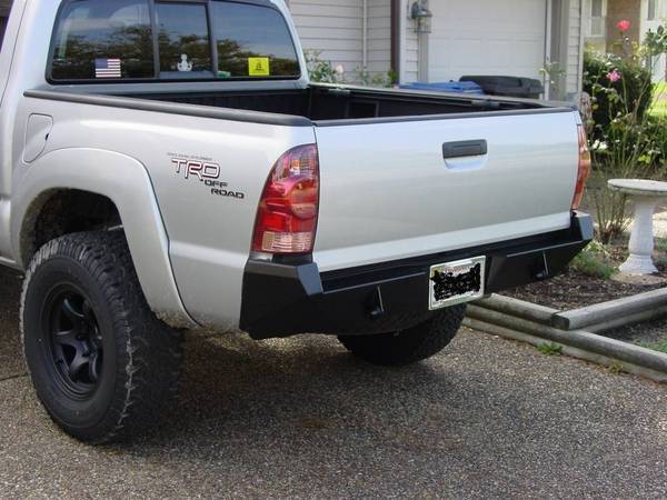

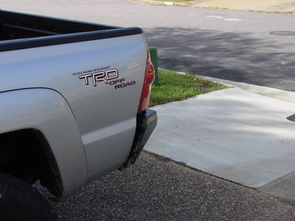

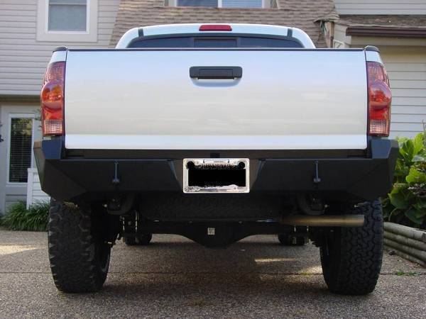

    I finally got my rear bumper back from powder coating and put it on yesterday. I'm really happy with it, it looks great.
